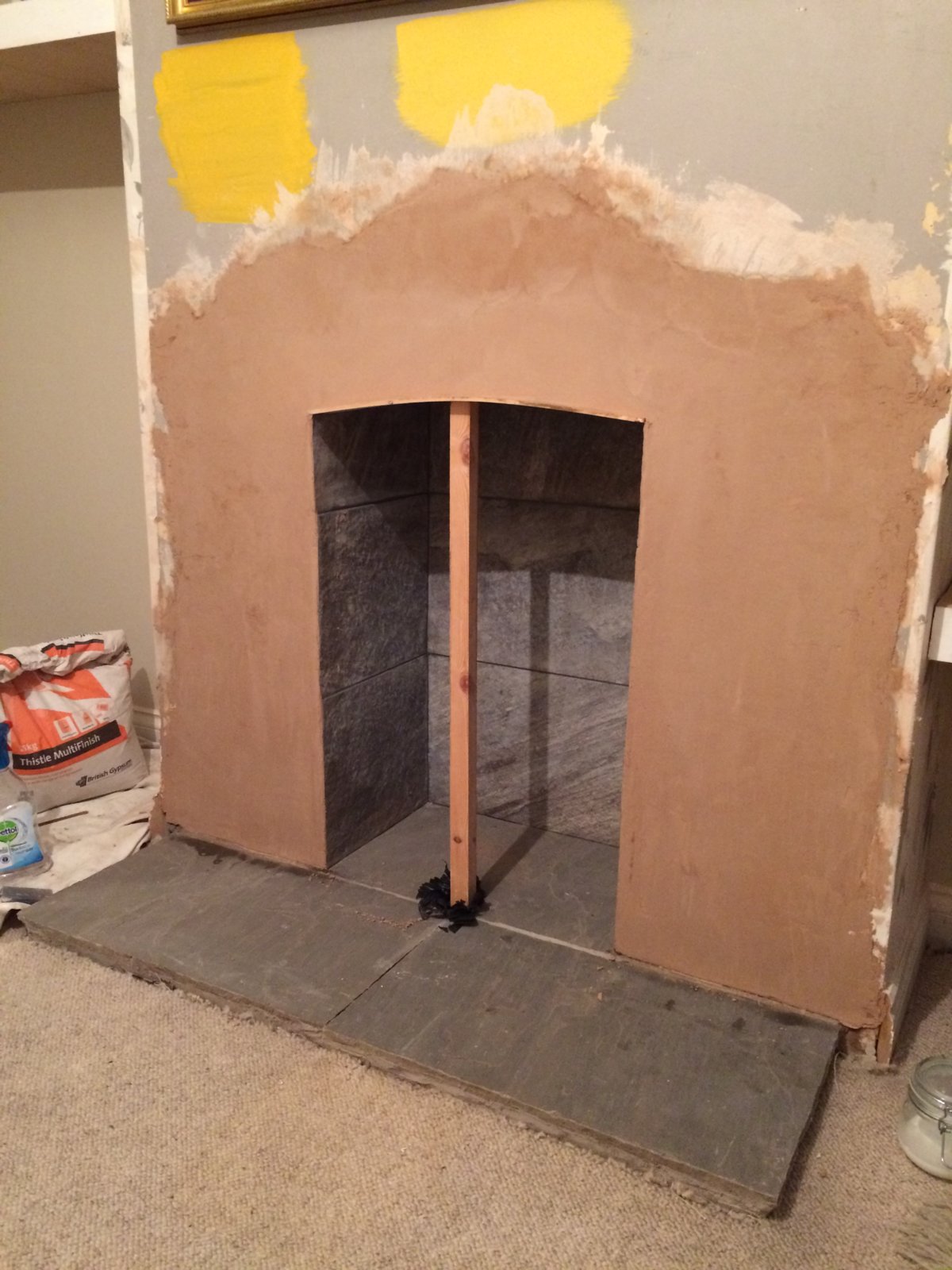

So this is what it looks like now :)
I am thinking of tiling the inside of the fireplace and Hearth all as one and suggestions on types of tiles to use?, i know have an opening of 60cm wide, hopefully this will be wide enough for a log burner!
It will take a small log burner and there's no risk of fire or damage given that you have brick and Hardiebacker board over it. However the opening is quite small so you will not get as much heat out of it as you might hope -- a lot of the radiant heat will be soaked up by the walls. One way to combat it is to put a couple of well-positioned stove fans on the top to draw up that heat and push it forward.

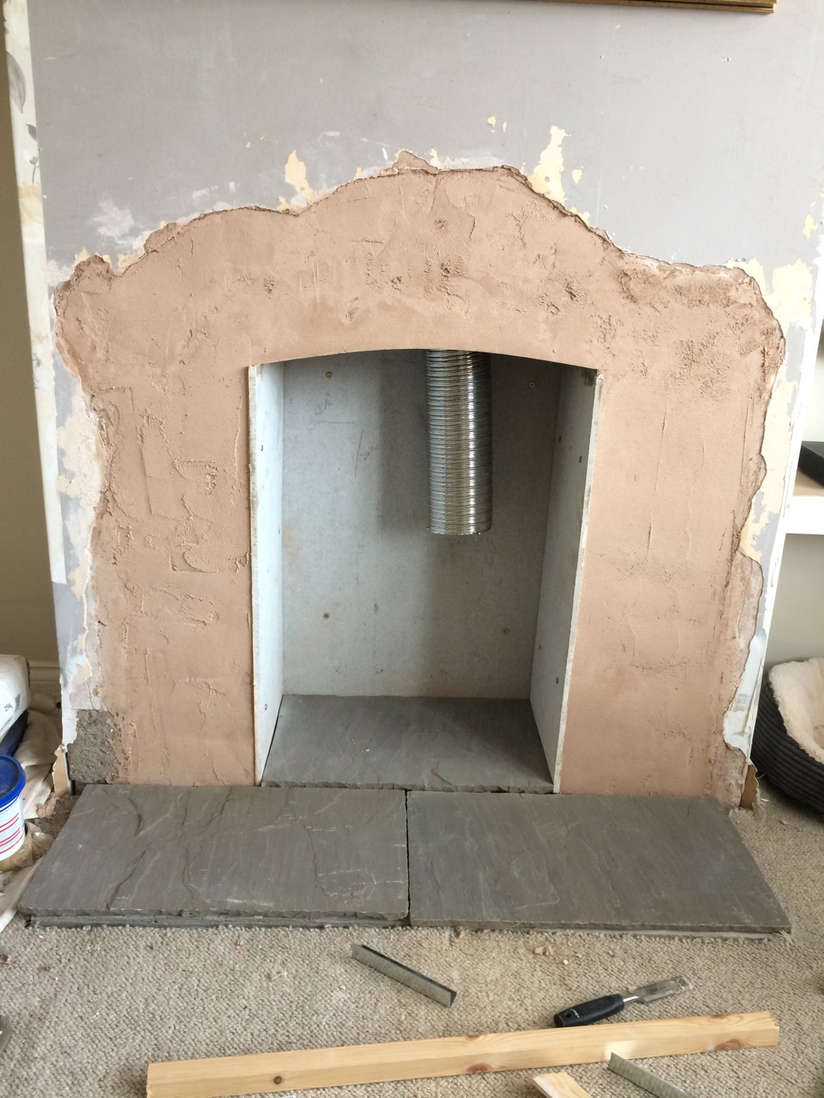

This is how one of mine looked at that stage.
...and these are the tiles I used:
