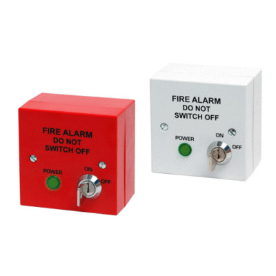

Can’t you simply connect the mains feed via a key switch?
I didn't know there was such a thing.
I didn't see anything resembling a key operated switch on the RS Components website.
But thank you, I'll look into it.
Although I was hoping that if possible my Father would be able to operate, at least the lifting process, unaided. The assent with a hand-held control would enable that, assuming the bifold doors were open.

Something like this may work, ignore the words, not sure why they appeared.
I looked up the idea of key switches in the RS Components catalogue for UK, and there is one that would do the job, bearing in mind the requirement for a 10 amp rating (start up current for ¼ horse power motor). The majority are rated at just 5 amps, but a 600v 10 amp key operated switch is available.
It would be a tidier installation tham removable cables. In fact with it and the control mounted on a stalk, at about waist height, and using the in-ground version, the lift could have been self-operated for both lift and descent. (Hindsight!!!)

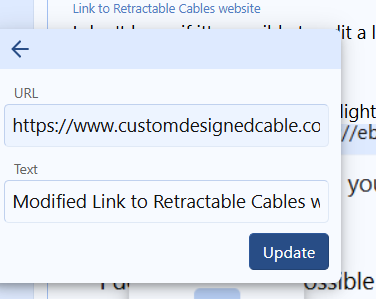

When you create a link, you can give it the description of your choice.
Like this:
Link to Retractable Cables website
I don't know if it's possible to edit a link.
I'm about to find out.
Yes you can. Edit your post, highlight the link in that post and choose edit the link.
Then click on update.

You could use a keyswitch that turns on/off a 16A double pole relay, that way the keyswitch can be as low as 1A.
Yes I found one ky switch that would do the job.
