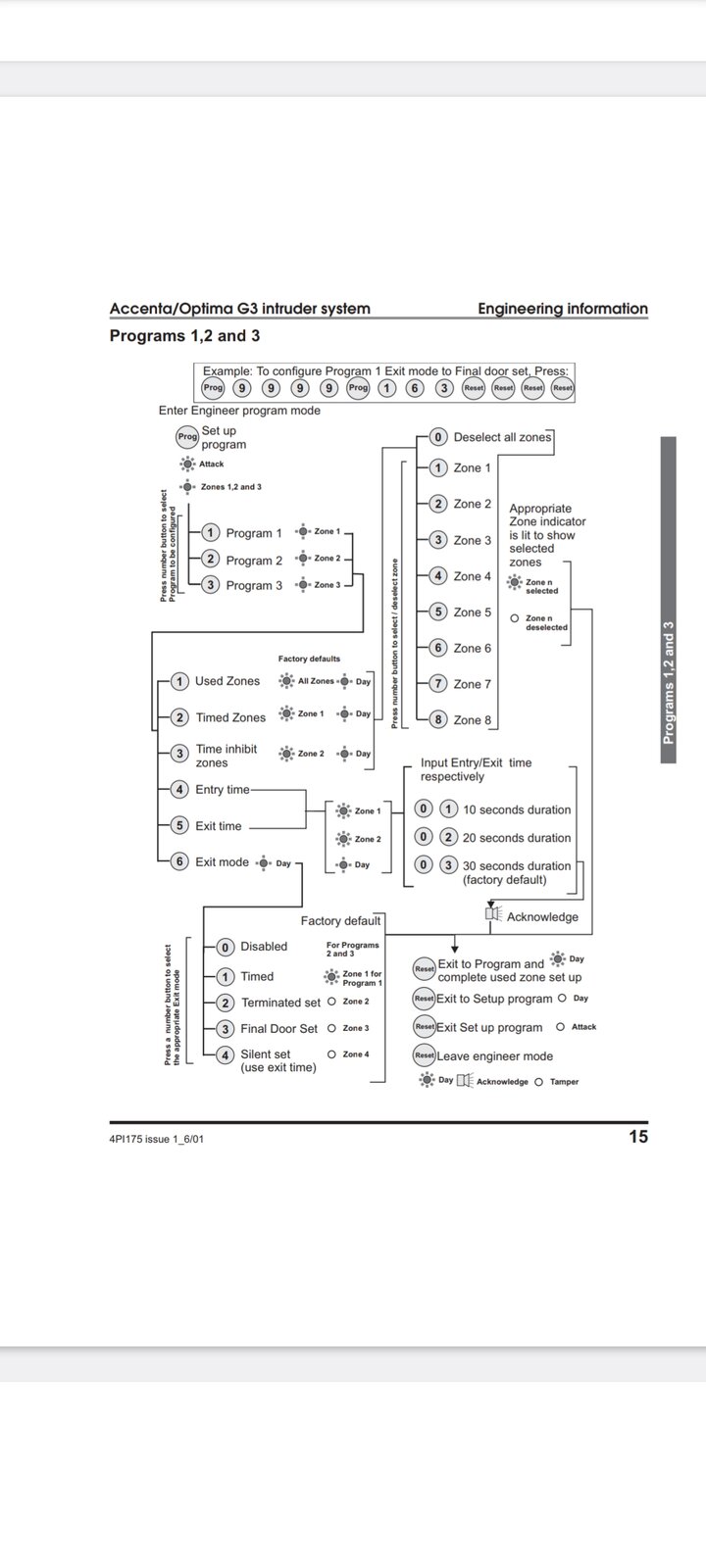

I had a power failure and lost all control panel settings. Managed to reinstate most but having trouble in setting the time delay for the internal PIRs so the alarm doesn’t go straight into alarm when we come downstairs.
The panel is the Optima Compact G3 with LEDs
The first 1 that sees you needs to be in timed zones and any subsequent detectors you have to pass to get the keypad will be time inhibited
