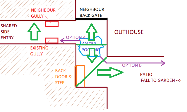

Hi,
I have water pooling in the area shown on the plan below. This is what caused my brickwork damage in this thread which Ive now had repaired and repointed.
But I need to sort the drainage somehow.
Does anyone have any advice please?
Water pools in the area shown in blue. The existing gulley, shown in red, is too high to drain surface water into.
So I either need to get water into the existing gully and therefore into the proper drainage system, shown in diagram as option 1, which would be the better option. But this would require me to expose the existing drains and fit a new gully trap and then a second patio drain trap in the blue area which links into the drainage system.
Or option B is I fit something like a channel drain or a patio drain and send the water away down the side of the outhouse and down into the garden area.
Or perhaps a third option is doing something with the ground levels to stop water pooling there at all. For example building a step so that section is higher and water can't pool there.
I attach some photos of the existing gulley.

Ok thanks. I'm aware that either gulleys or acco drains are available, but the advice I need really is which option to choose or how to go about the job.
I can't re lay the existing slabs to achieve the level of the existing gully because they would have to be lifted quite a lot and over a large area (unless I build a step). Also they would be higher than a subfloor airbrick I have at the back then as well (which is another reason I can't just fill in the area with a step, as I'd be blocking the airbrick).
If I go the acco drain route I will have to channel out a lot of material, possibly fit a sub ground pipe too and the only place I can then send this water is onto the grass which might lead to flooding there.

Ok understood.
Can I just ask a couple of clarification questions then please.
The area in question is round a corner of an outhouse and is only narrow. If I slope a slab or concrete away from the house (which obviously I want to do) it would be sloping towards the outhouse. Does this matter?
Perhaps I could try angling the slab/concrete away from the house and at the same time away from the outhouse but this would direct water exactly to the step outside the back door. Likely to mean icy area in winter?
Or do I definitely need aco drains along the side of the outhouse to try and carry the water away. The issue is there isn't much of a slope so I'm digging out to fit the aco drain then there is nowhere for the water to get out of the aco drain unless I dig a deeper channel at one end and connect some actual pipe to it.
Finally at the moment the paving is a mismash of block paving and concrete slabs all laid on top of an old concrete patio slab. I could try and pave the area nicely or I could just try and form a concrete pad with the required slope. Any thoughts on this?

Oh, is that your neighbour's house or boundary? If your houses are that close then you definitely need something more complicated.
It's the neighbour house. We share a side access 1m wide. All the guttering downpipes, kitchen wastes and bathroom wastes go into a shared drain/sewer running down the centre of this access.
The neighbours house is slightly higher than mine so there is a step up into their back gate. So I can't send water that way.
I'll post some more photos later but basically the downwards direction is down the alleyway, a right turn into my garden to my back gate then a left turn down my patio in front of my back door.

Are you saying 45 degree cuts in a paving slab in order to get a fall in two directions?
I'm not sure whether to put paving slabs there or just lay a concrete pad. Then I can shape the pad to fall in the direction I want.

I mean the green 45 degree line I've drawn on your plan. That's how sloping paving is usually resolved where there's a change of direction. Either by sculpting concrete (harder than it looks), or cutting a slab diagonally (easier than it looks if you have a cutter).
Poured concrete could work, but would need to be skilfully laid and you would still need sufficient fall (>1 in 80) available and a design. If you try to wing it then you'll just end up with puddles in different places. The surfacing material doesn't really matter, the design does.
You will need underground drainage due to the houses being so close. But you still can't avoid solving the actual issue, which is fixing the roof.
