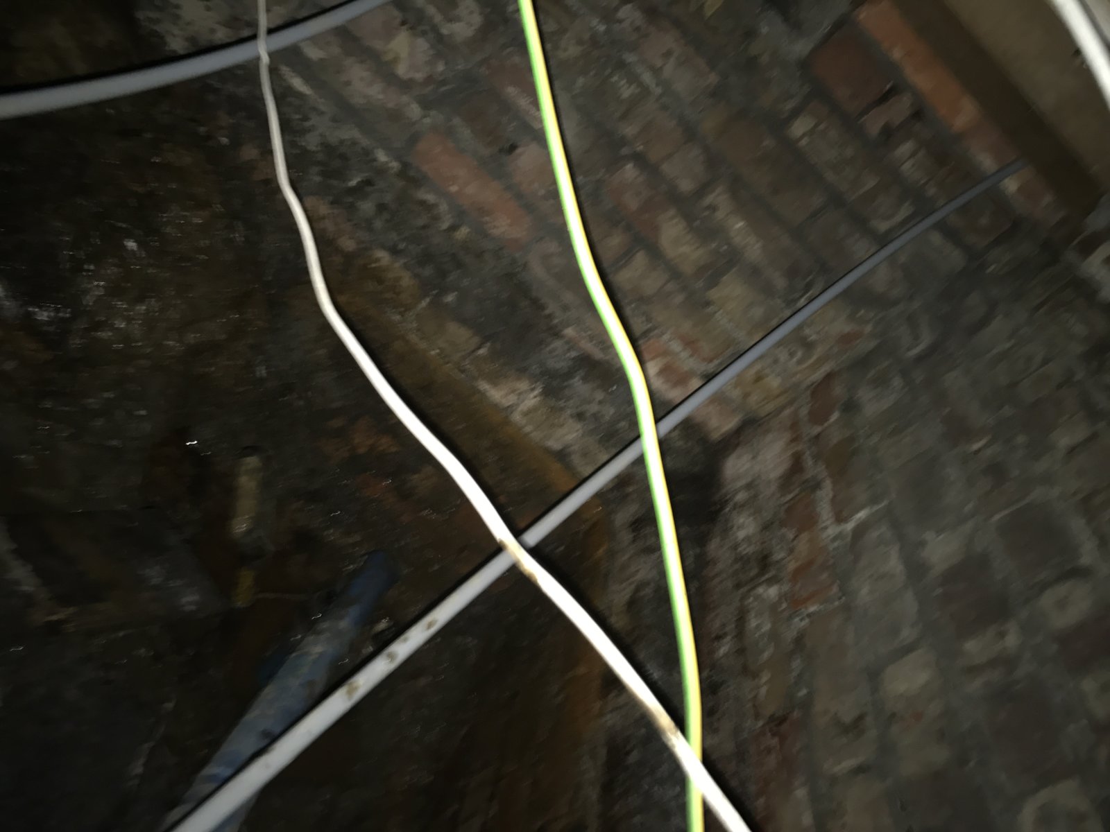

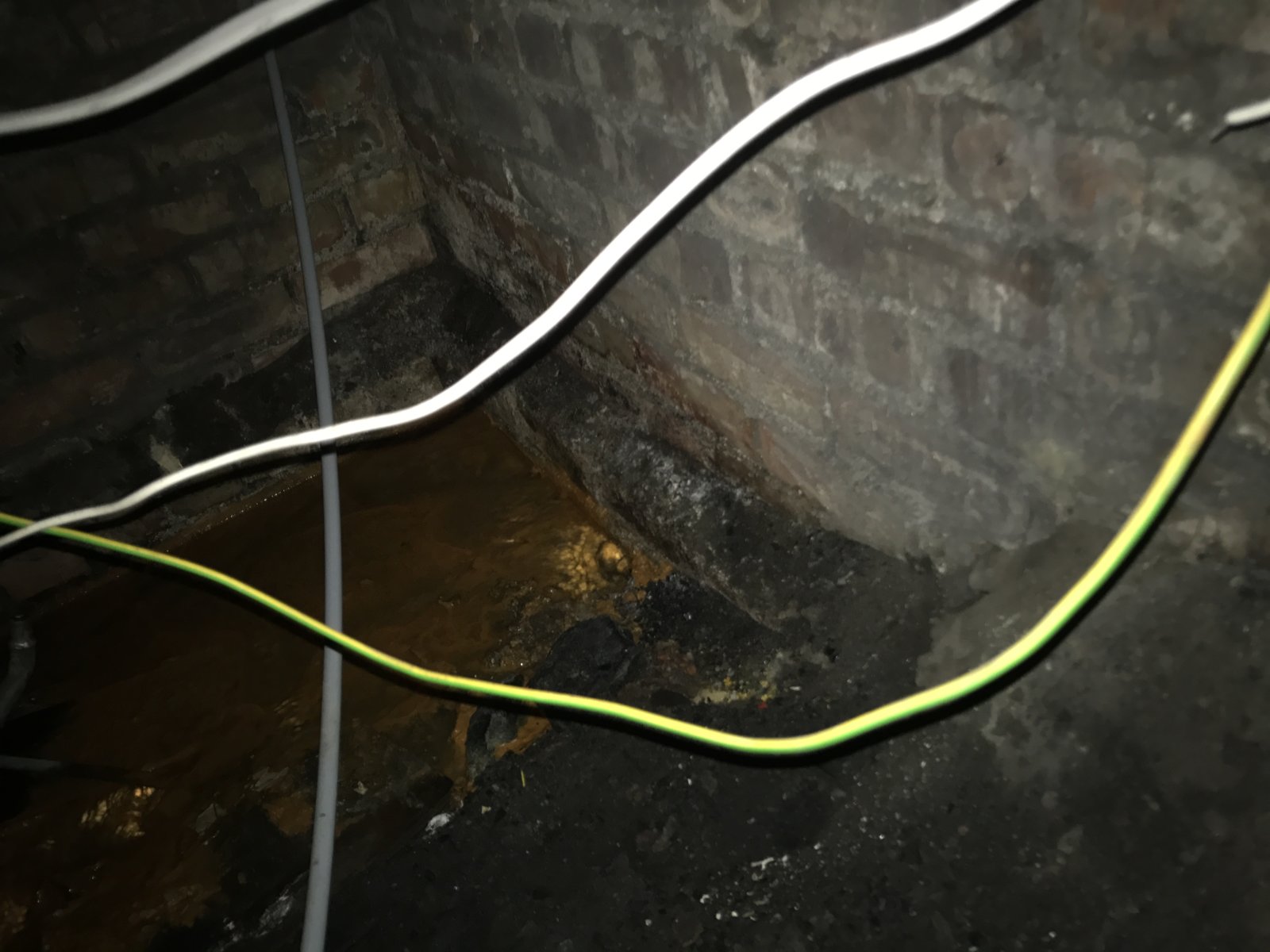

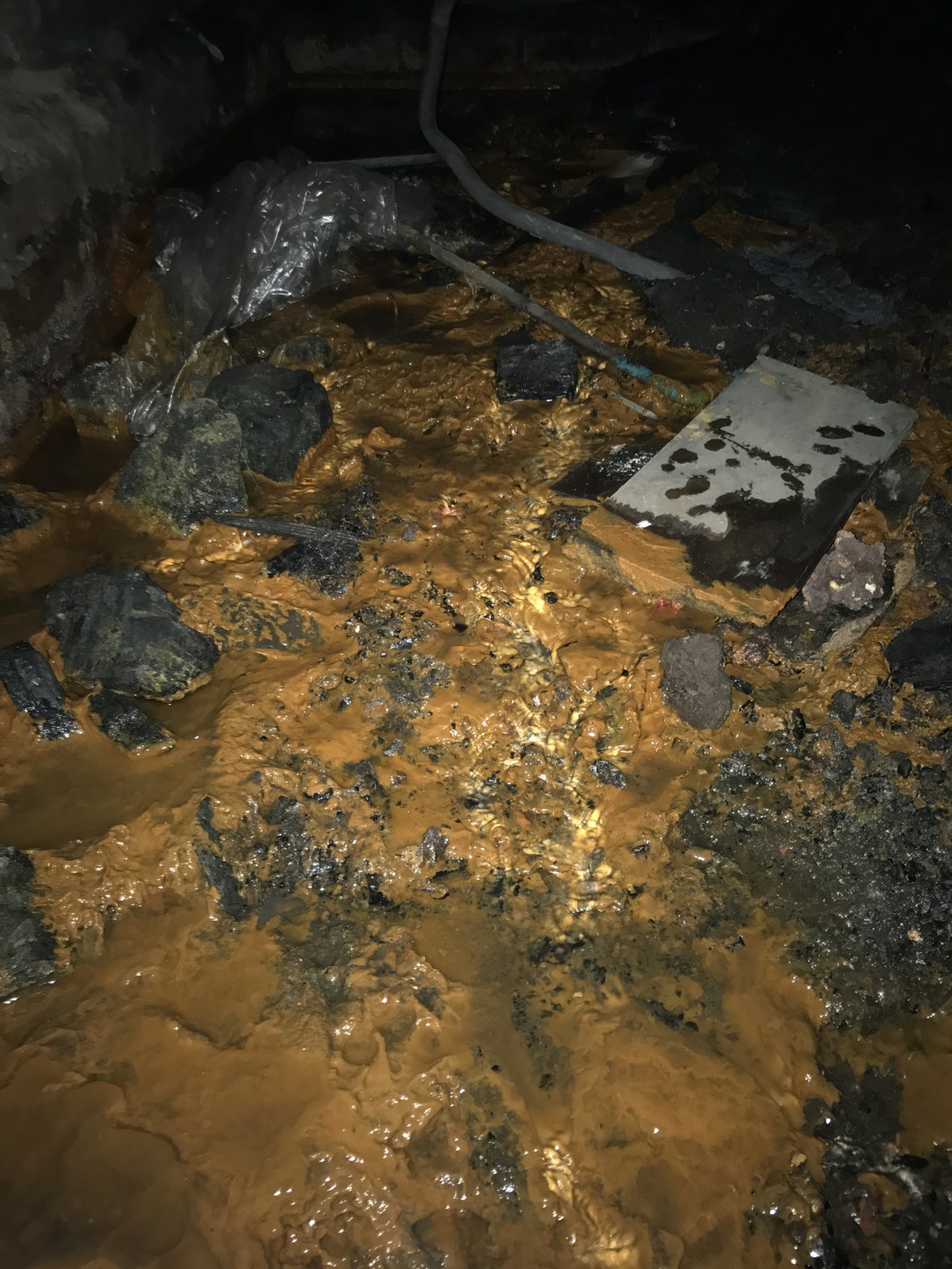

I'm on one of those anoying jobs.
Woman has lived here 30years and this started the other day. No leak on her supply and no blocked drains. The water has lumps of orange in it and is running faster than a tap.
I've had a bit of a dig and it seems to be coming in under the front door.
Any ideas? Thanks.

I'm thinking a trial hole in the front garden might find an old pipe. It doesn't look like it's carrying mud.
I would suspect a burst water main that is washing out sand / subsoil and creating a cavity. A cavity ( a mini sink hole ) would be a potentially serious hazard. With that in mind I would ask the Water Company to sample the water and test if it is mains water. ( many companies do this test for free )

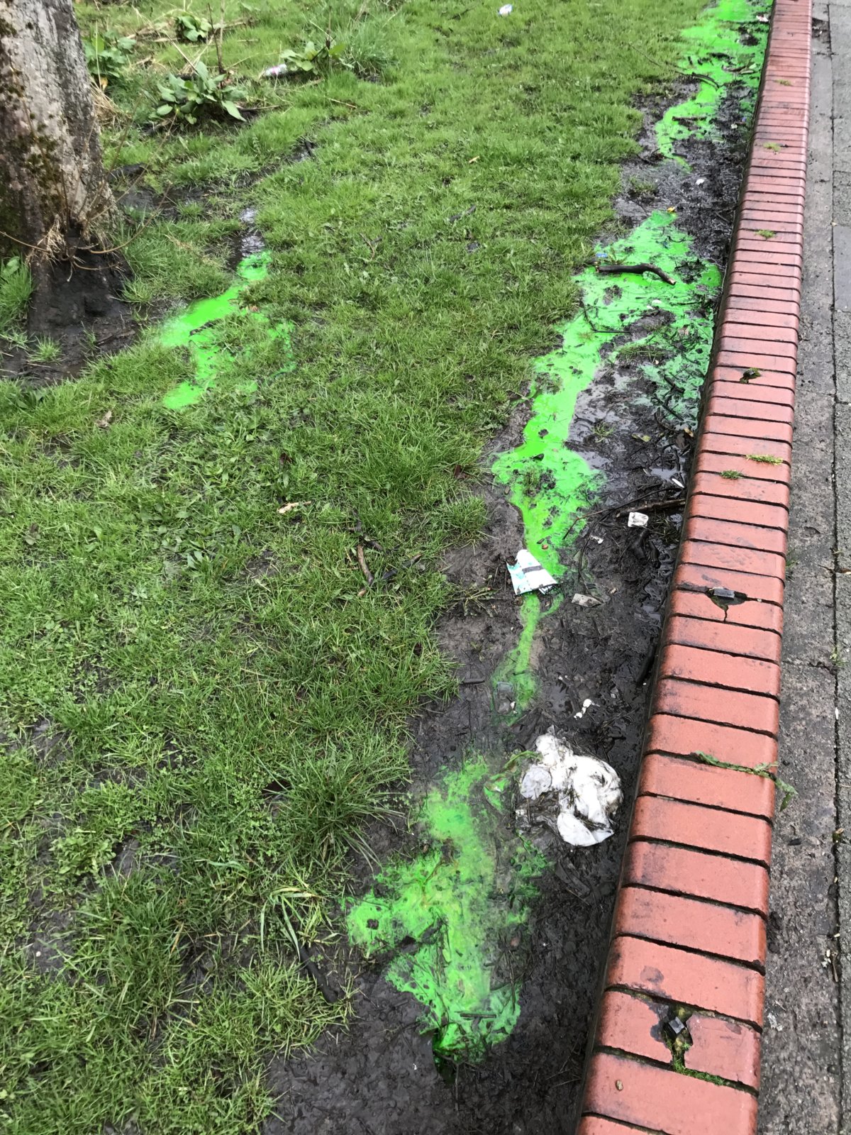

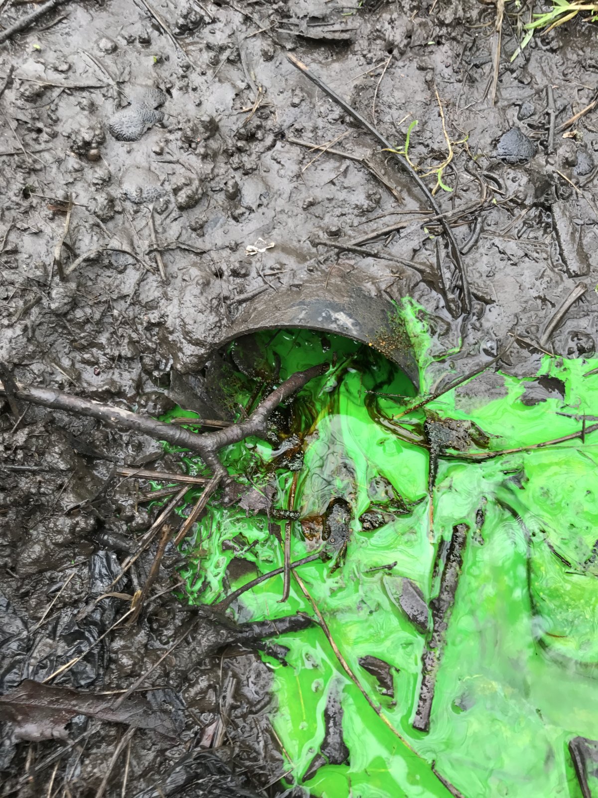

If they don't find anything we will dig on the outside. Something else we spotted on the park opposite, loads of water going into some ducting, we put some green in it but it didn't show while we were there.

The colour looks like rusty water from an old iron main or tank. In a tank it sinks to the bottom. When a hydrant on a long leg is opened, it gushes out orange like that until it's all washed out.

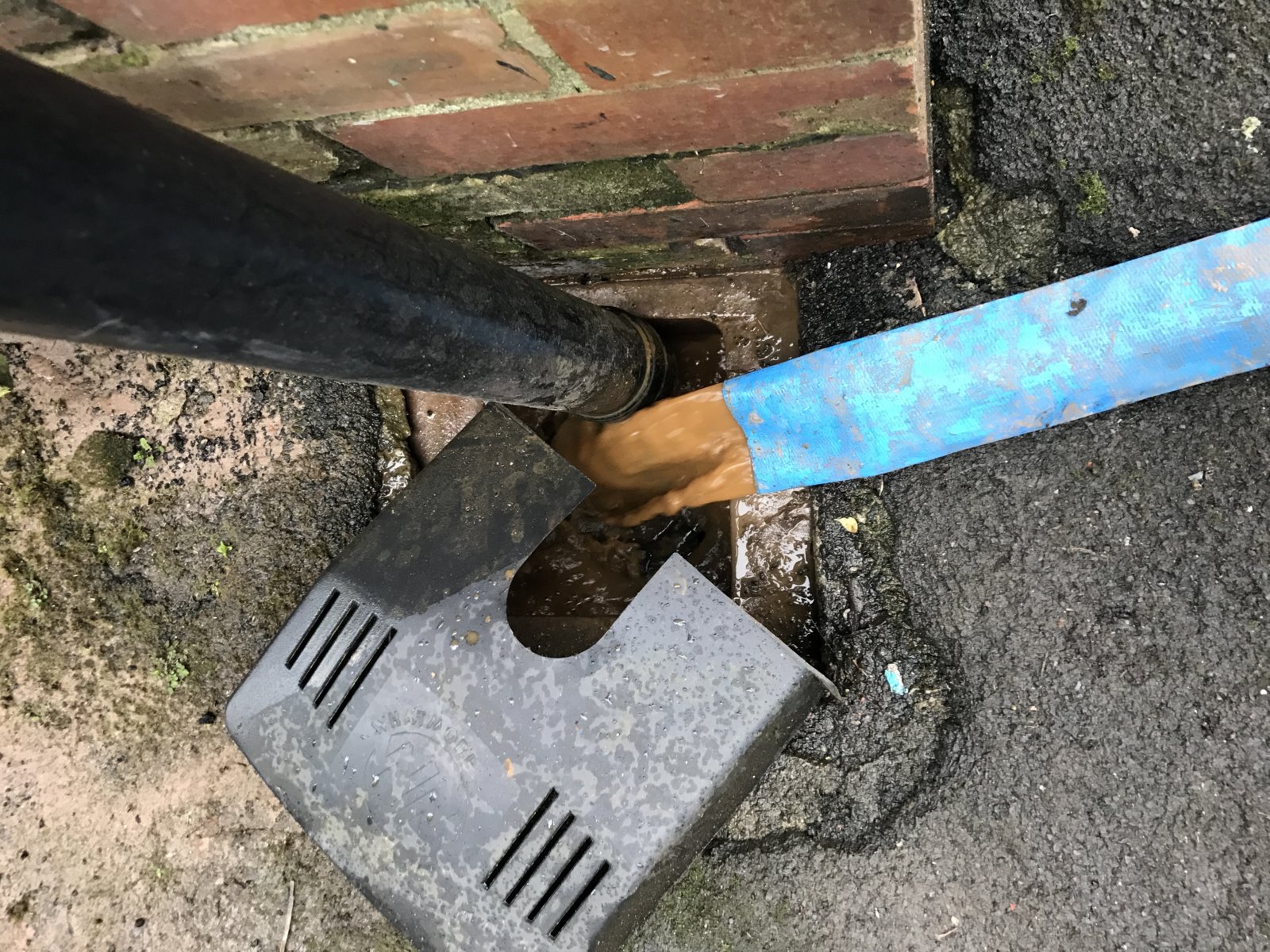

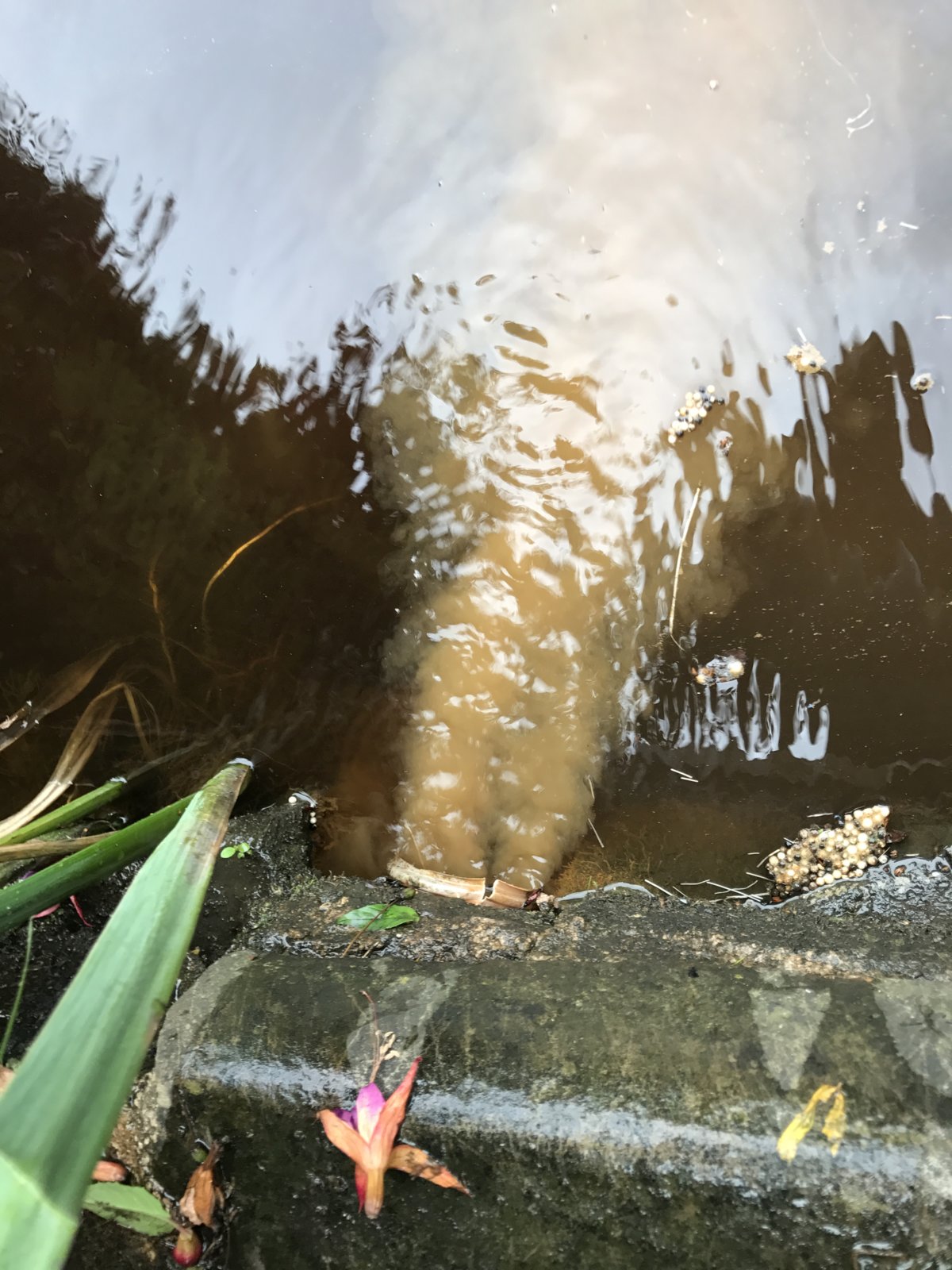

I've only come accross this twice before. Once in near Heaton Park where a drain was leaking and once in Oldham where there was a blocked outlet in the subfloor which lead to a canal. Same orange colour but we never knew the source of the water but there was a channel that seemed to be designed to take the water away:

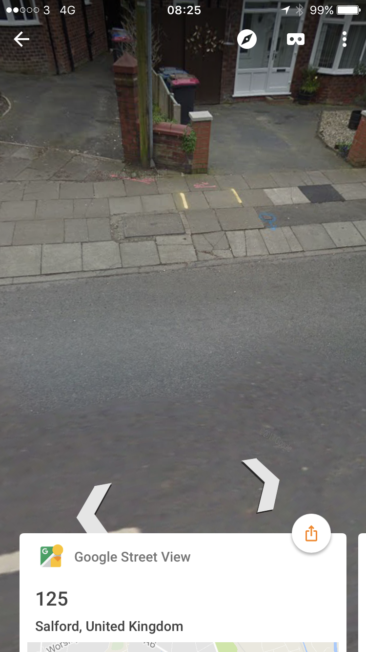

I live nearby Ian, last year all that road was dug up for new gas mains i think, if you look at google maps(streetview) you can see for yourself.
Now that’s a useful bit of info.
The photos show what looks like rust in the water. Are there canals and industry nearby?
Yes, thanks (y)
I can see their markings on the road a bit further up
So maybe the water is using the old gas pipe as a duct and entering the house. If I could dig onto the old pipe and see if that's right. I would have never thought of that in a million years, thanks again!!
