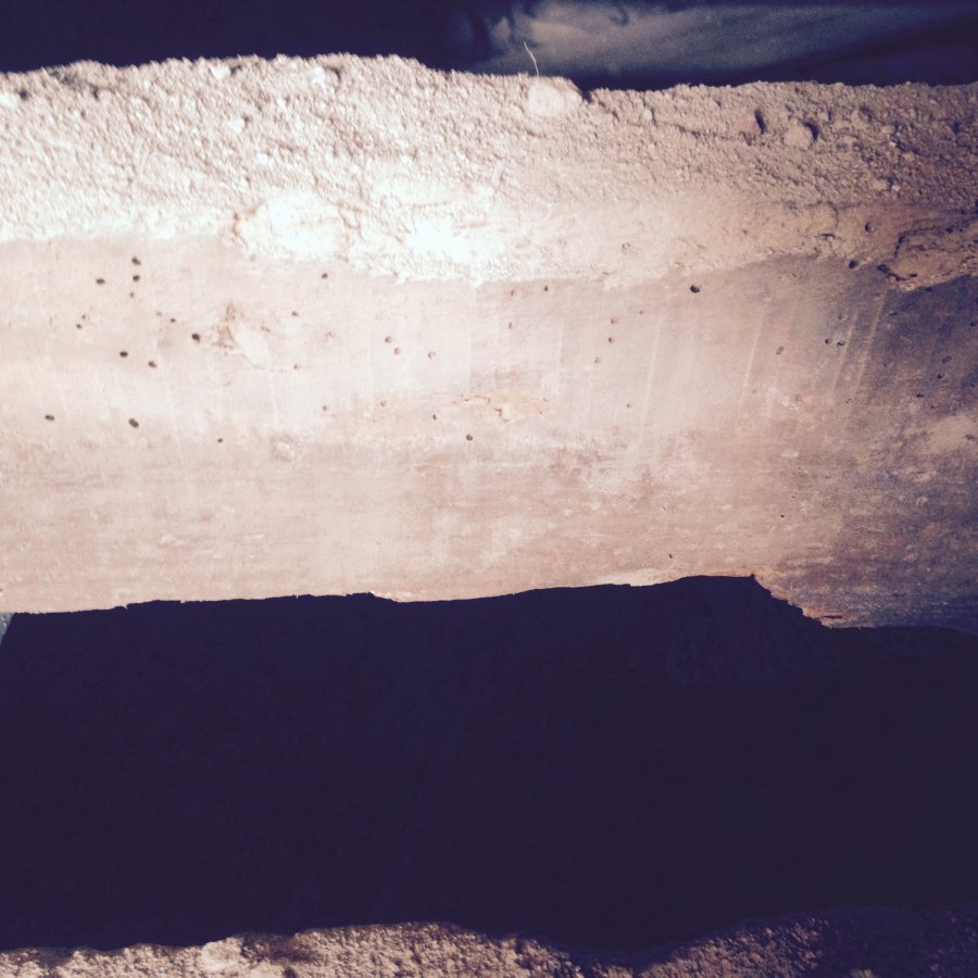

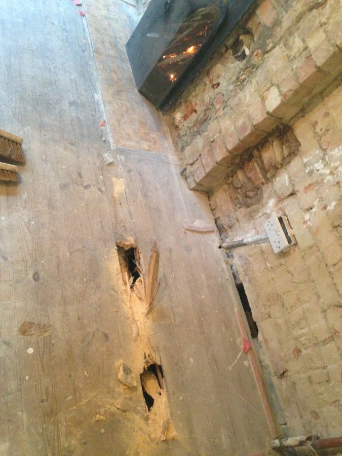

Difficult to say without seeing them, any chance of photos of boards and joists?
doesnt seem to be meany holes but the bottom of this joist just crumbled!
found the odd floorboard that was not structurally sound
is spraying an option? or u think rip all floorvboards out and paint joists.. take opportunity to add underfloor insulation / new feature floorboards?

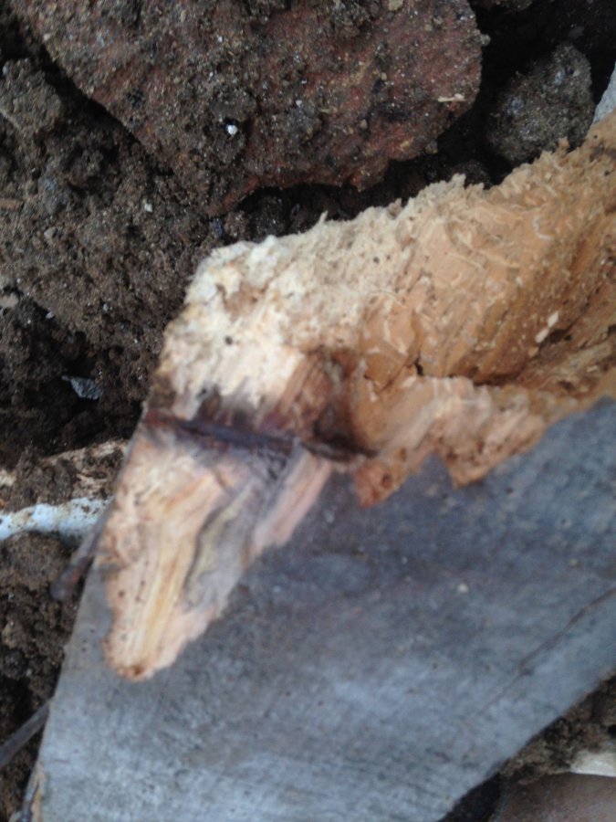

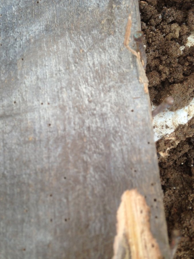

is spraying an option? or u think rip all floorvboards out and paint joists.. take opp.ortunity to add underfloor insulation / new feature floorboards?

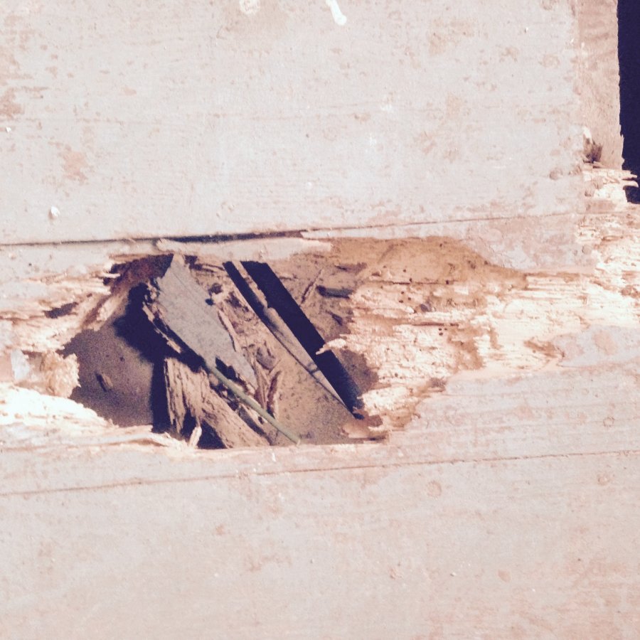

They look pretty bad, how old is the property?, the joist in the pic seems to suggests that it is very old ie pre 1900. Could you include some more pics of the underside of the floor, the reason being older hardwood joists are usually only affected on the outer edges. Newer softwood joists contain more sapwood and can suffer structural breakdown
hi - its 1920..
and yes one of the joists snapped! actually in the out side only had 10 or 20 holes ☹

Is it possible that is just rot? this area was in a cul de sac - perhaps not as well vented as could be?
this is the joist before it snapped - I was digging the rubble out from under it when I snapped it
Just to clear up location question, your description pointed to House longhorn beetle which is only found in Surrey, if u had that it is very serious. However I am still not 100% sure how bad your infestation is, if the rest of the joists are just as bad renewal is the only option, I repeat it is very unusual to have to renew entire floor due to woodworm. There does not appear to be any wood rot. I suggest that you get an on site inspection by local expert.
Woodworm isn't an issue -you've been watching too many Tom and Jerry cartoons with termites in. My money is on lack of ventilation which leads to rot, dry rot, and beetles.
