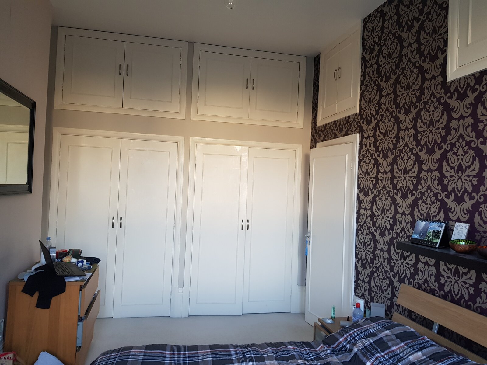

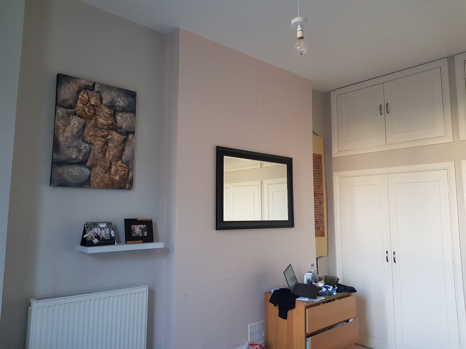

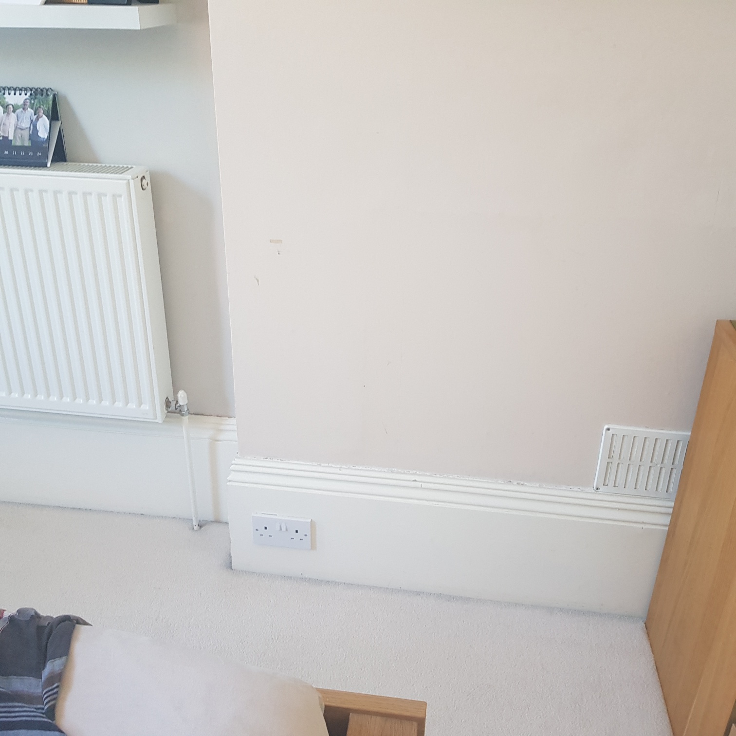

Thanks for your thoughts - Have attached picture to put things in perspective. Lot lot of wood work - Window frame - skirting board and Wardroble doors and even door storage above the bed....
Still thinking wall first and then wood work or would you disagree?

I would do woodwork first. Two key reasons-
1. Where the skirting meets the wall is far from smooth
2. When trying to cut in the eggshell on the edge of the architrave it is difficult to maintain a wet edge.
Totally up to you though. I just find it works best for me.
Thanks so much Opps - might try both option to see what work best for the best finish when i do the first coat!
