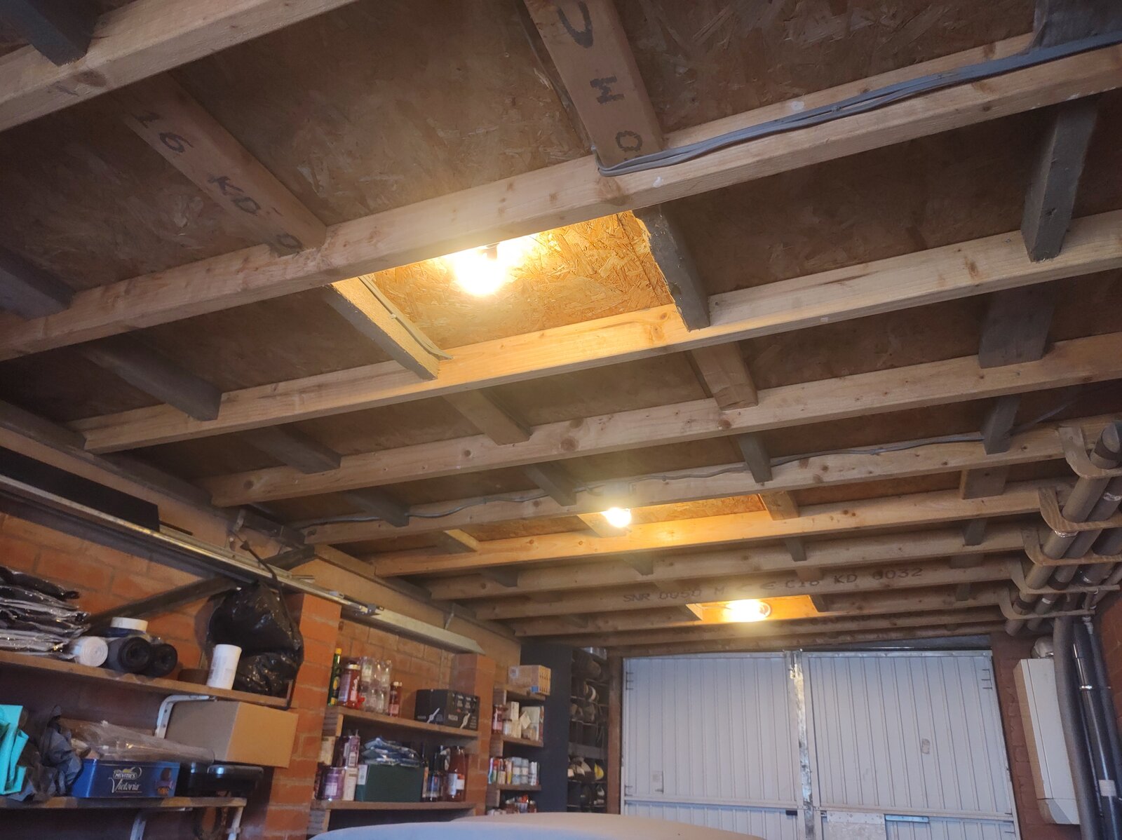

I've never understood 18mm OSB for this (I think it's just a "done" thing), when it's going on PIR on a sub deck it's not really spanning anything, it's just something to fix the EPDM to - if you consider that you can just stick the EPDM to tissue faced insulation. My garage is EPDM on 9mm OSB on the joists. Takes my 17 stone on the odd occasion I have to walk on it, but I don't go dancing up there!
