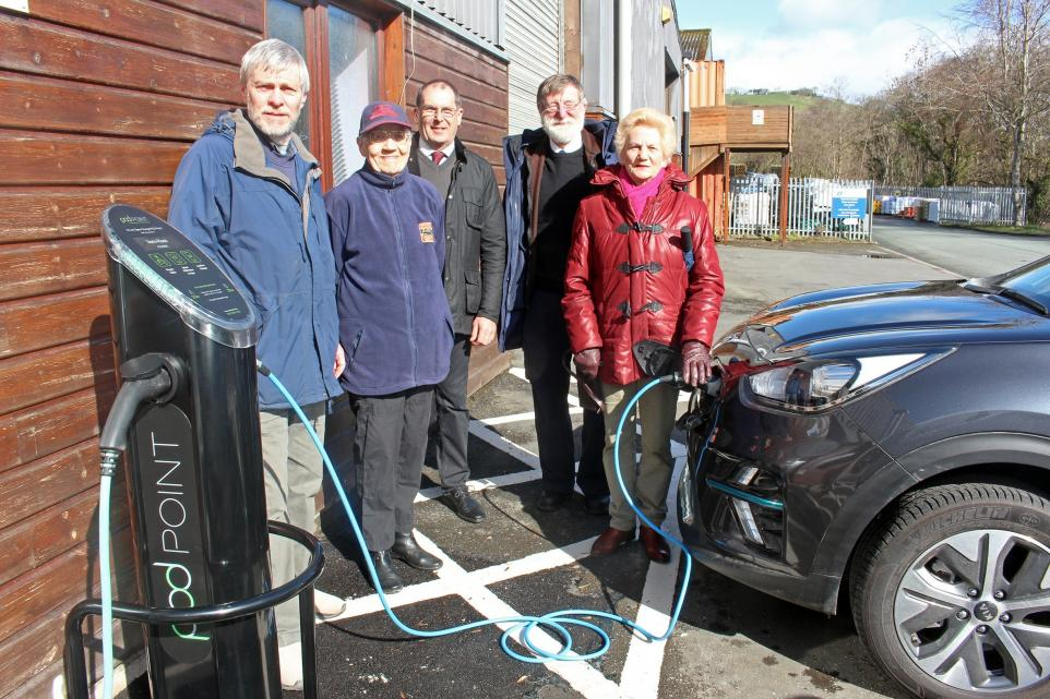

I had asked about the EV charging point 2 x 22 kW and was told it was TT which did raise questions as to how close to the main building, the launch 1709215581152.png looked good, but the location so close to the personnel entrance and the EV users abusing the system has raised issues. At the moment turned off due to the abuse.
