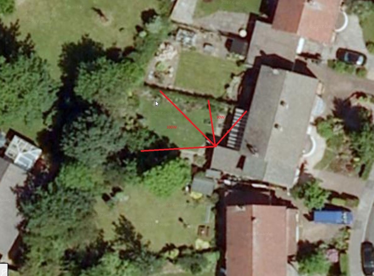

Hi all,
I am hoping for a little bit of help. I have been going through LED's like i go through under-crackers.
So, the back garden has always had two floodlights, one had never worked and the other a twin spot that i swapped when i moved in which as worked ever since (28 months) a few months back i swapped this for a 100W LED Floodlight off eBay which worked fine for a few weeks then it went to LED heaven - half of the LEDs wouldn't illuminate and the others would just come on VERY dim and flicker. I got this replaced and within a week the same thing happened!!! Put it down to poo lights.
Bought another 100W and a 30W http://www.ebay.co.uk/itm/361749265398 and a standalone PIR from here: http://www.screwfix.com/p/zinc-360-corner-pir-sensor/8104k
Now, these both worked great for a while, 30W lasted 10 days then died but the 100W still worked, i then replaced that with this: http://www.wickes.co.uk/Luceco-LED-Floodlight-30W-Black/p/155310
So far the Luceco is working but last night the 100W went pop and now thats not working either!!!!!!!!!!!!!
SO, am i buying rubbish or is there something i am doing wrong?
Lights are all wired up right and connected to my ground floor light circuit.
I would put it down to cheap LED fittings from Ebay unless that wickes one dies anytime soon.

130W of LED lighting? How big is your garden?

My garden is about that size, and is let adequately (for finding the cat, putting the bins out, etc) by two 12W LED floods with an extra 6W one at the side for unlocking the driveway gate.
In that case I'll fire the other 30watt unit up and see how it goes.
