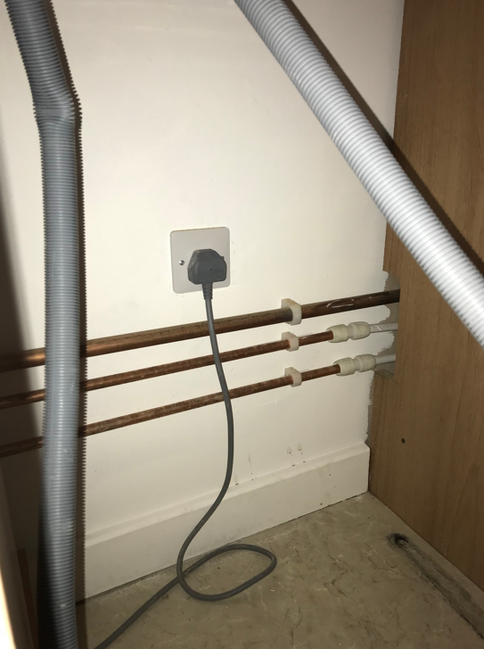

In the kitchen, I can see there is a fused spur with the label "Washing Machine" on the plastic. It goes to this socket:
If it's a fused spur, then the socket below, will not be on the ring, so out the back of the socket, is not a good choice. If the fused spur is on the ring.
Any outdoor socket, would be best if it were supplied from it's own fused spur, and a double pole one too - so in case of RCD/RCBO tripping, the outdoor section can more easily be isolated.

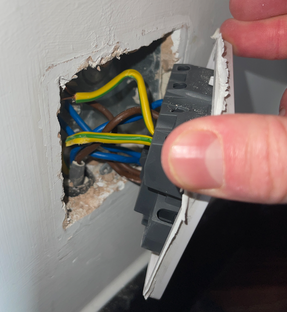

Thanks everyone for the posts. I took a look behind the switch and found there are two sets of wires coming off of it, so one for washing machine single plug and another set going not sure where. Not too sure where the other set go to as there are no other sockets under the countertop.

Two browns, two blues, in each terminal, suggest that is on the ring - but you need to check and make certain..

If it's on a ring, it can only serve a single socket I think.
Could I change this fused spur to a single socket so at least I can plug something in on the countertop where this fused spur is?
It looks to me like the blue and brown on the top go out of the bottom of the box, so I'll make a GUESS that is going to the washing machine socket. The 2 blues and browns in the bottom I'll make the GUESS are the ring.
IF THAT IS CORRECT there is no restriction on how many sockets or devices may be connected to the spur. There is also nothing to stop you replacing the Switched Fused Connection Unit with a socket however if you do you will only be permitted to one single or one double socket (not 2 singles) on the spur.
However there is no restriction on adding another spur on the ring (into where the 2 blues and browns are)
Before any of this is done you have to establish which cables are which, a starting point is to look at the markings on the FCU for 'LOAD' and 'SUPPLY or IN'.
