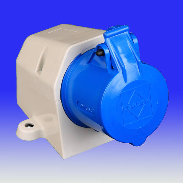

Finally I also intend to have a 16A outlet outside (on the kitchen wall).
Like this?
Well - not like that exactly, you'll need an IPx4 or 5 one, but that type of socket? What for?
I only have two spare spaces on the RCD protected side of my CU, what would be the best combination to use?
Use one for the 16A socket on the wall.
Forget your existing 2.5mm SWA, lay in some 6mm, or even 10mm (you don't want to have to dig that trench for a 3rd time) to the shed, and put a CU out there to provide the power, outside lighting etc.
Yep that type of socket... and yes, an IP44 one. Reason being that all the equipment I intend to use outdoors is fitted with these, and I personally like these connectors.
