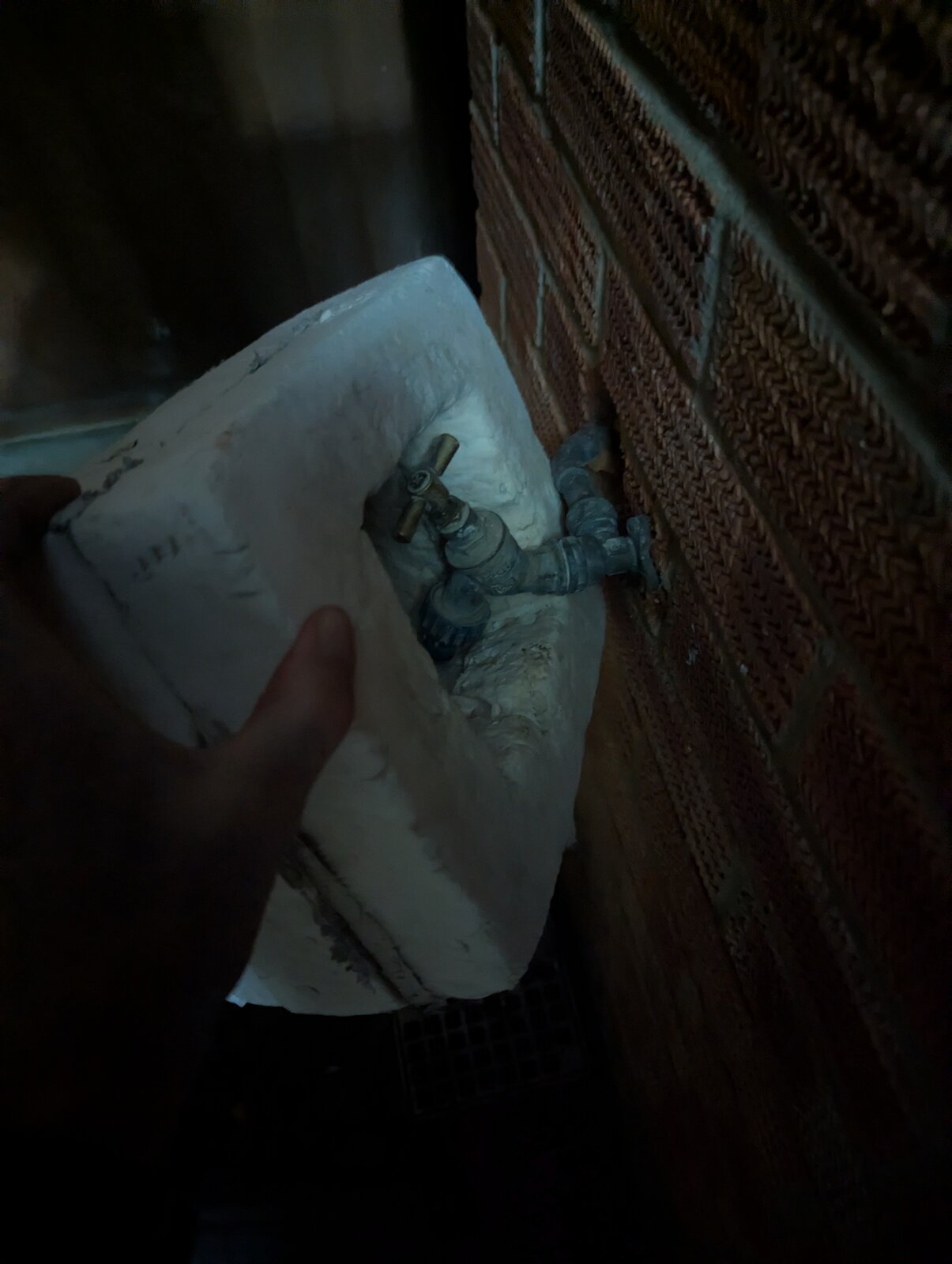

Our house has an outside tap on the back wall. Im of the opinion the copper pipe transports heat from inside which helps, but to stop it freezing I made a box out off polystyrene stuck together with silicone.
It's been like that for 10+ years and no problem.
Bit dark but you get the idea.
