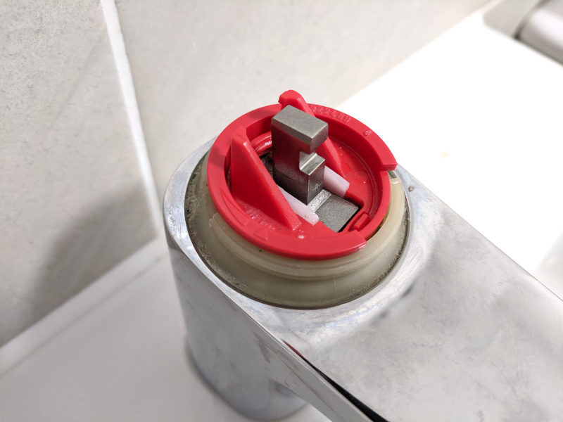

We've got a Sottini lever tap that has started leaking out of the handle when turned on.
I've never replaced a tap cartridge before, but following various youtube videos I removed the handle and went to take out the cartridge. However the online examples suggest there should be a large metal nut holding the cartridge in which you can unscrew.

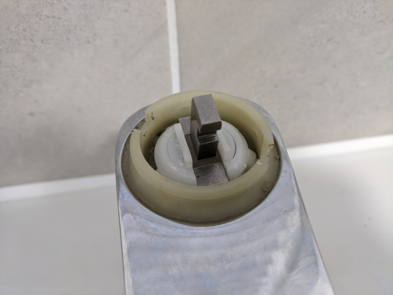

But the cartridge looks like this, and there is no metal nut to unscrew. The cartridge seems to be embedded:
Or here with the plastic guide things removed:

Anyone got any ideas how to remove the cartridge? Or if I might be looking at the wrong replacement, or barking up the wrong pipe entirely?

Right, but how?

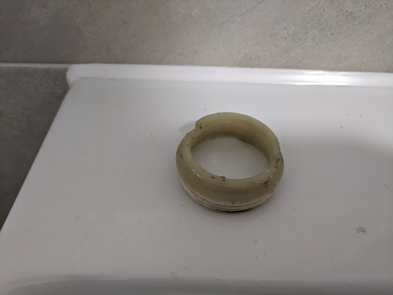

If you look 1:20 into the youtube link I posted, an adapter is placed over the nylon ring with the slots that allows it to be unscrewed using a spanner or socket.
But I don't know where to find that adapter or what its called.
Thanks! I used a mole grip and it did the job. I was afraid I'd break something but it was fine, although it flexed a fair bit.
Here is the nylon ring:

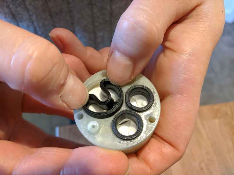

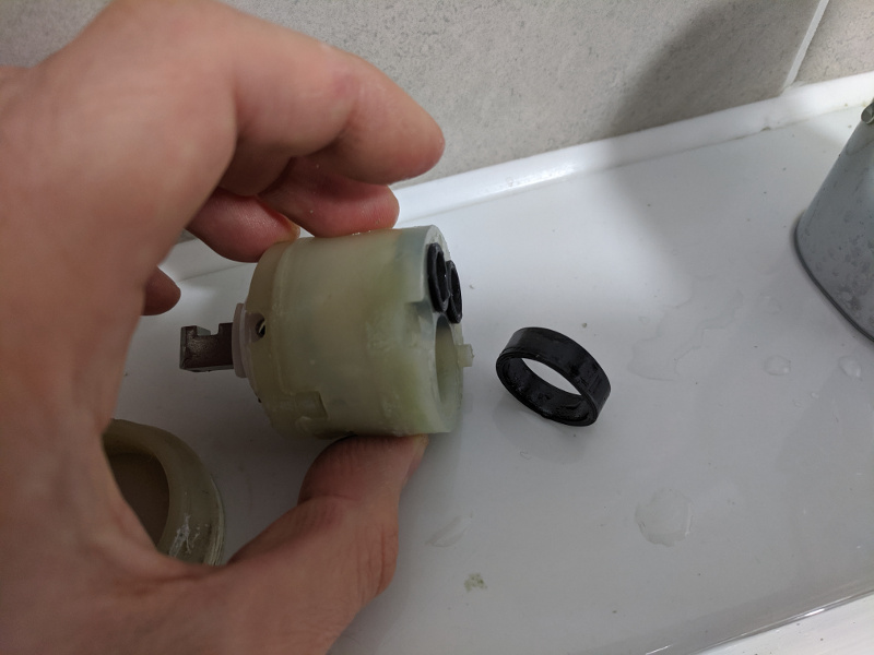

So now I've got the cartridge out, which I was intending to replace on the basis it was broken.
Except I found a strange thing when I took it out. One of the gaskets (is that what it is?) wasn't in the cartridge at all, it was loose in the tap:
In fact it doesn't even fit in the cartridge! How is that possible? See below picture trying to force the ring into the cartridge - its just too big.
I'm wondering if it was incorrectly fitted when it was installed. I think I'll get a new rubber seal/gasket.
It is about 19mm diameter (so about 3/4 inch) by 7mm, so it's not like a normal o-ring. Does anyone know where to find something like that?
