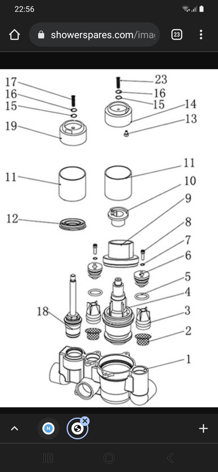

From what I can gather, all the parts are listed here:
https://www.showerspares.com/crossw...er-totti-thermostatic-shower-valve-2007-2013/

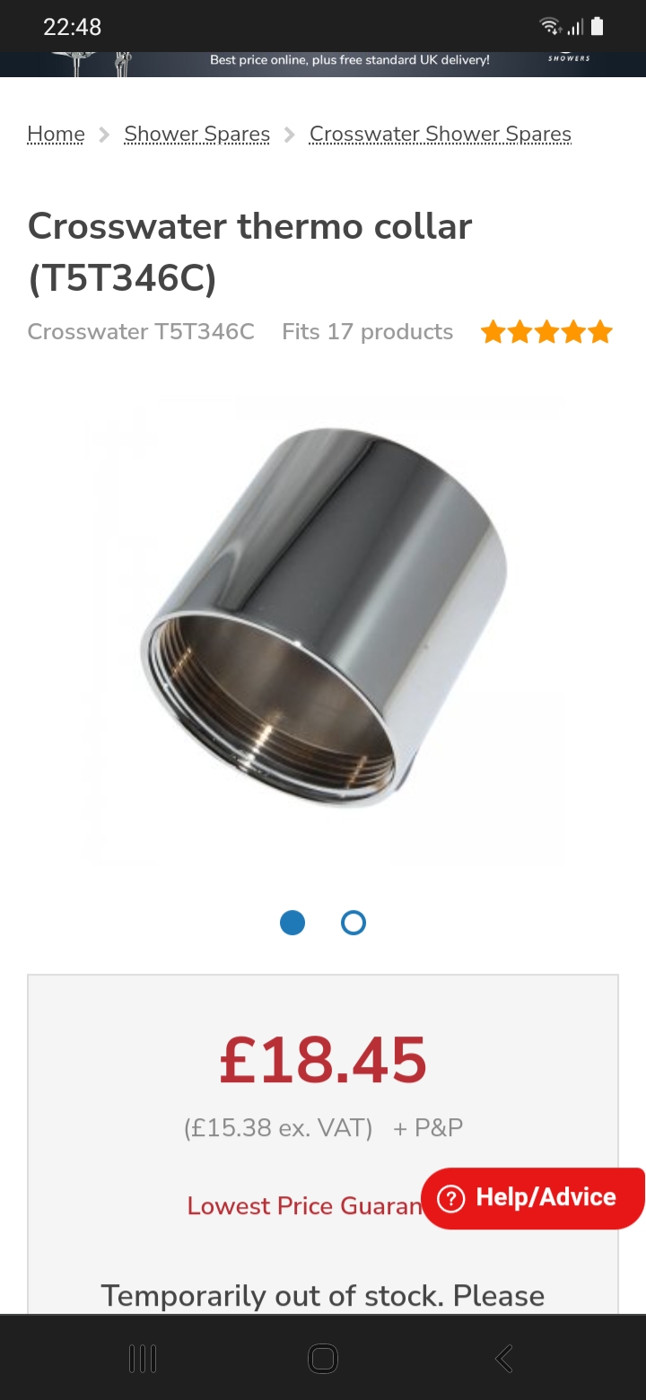

What is holding you up, is part 11, the 'thermo collar'
This needs unscrewing first, using some adjustable grips (and some cloth for protecting the surface).
Once tht is removed, you should be able to reach part 9, the 'retaining nut'
Which you can undo with a 38mm spanner.

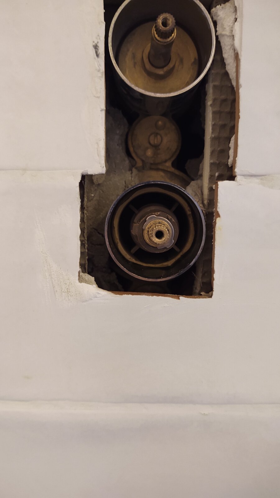

Now that you pointed this out it's obvious. But as you can see from the pic above, the dumbass who installed the shower valve set it too deep so the thermo collar is hard to access as it's not proud of the tiles. It's also set in cement. So after carefully chiseling the cement, how do I grab the collar from the front without bending it? I thought I might use two long nose pliers at 6 and 12 o'clock but I'm not sure if that's a good idea
Yes, I'm sorry, it does look quite well set back! :(
I would possibly try turning it with some pliers from the inside.
You could also try some penetrating oil on the threads?
Theoretically it shouldn't have been wound on very tightly in the first place!
But really thinking outside of the box, do you have something like a rubber watch strap, that can be wrapped tightly around the outside and assist turning it? :)

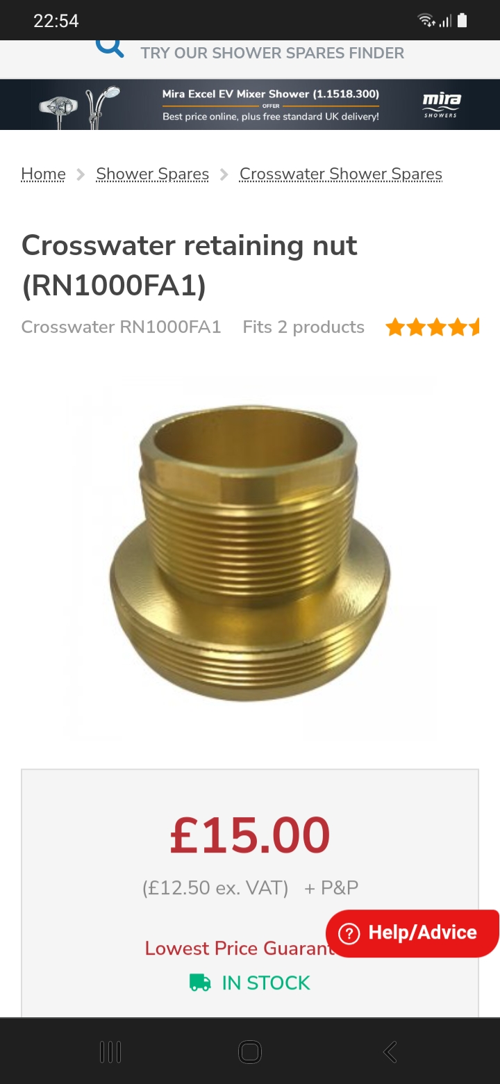

Once I removed the cement the collar unscrewed pretty easily with a long nose pliers. Unfortunately, there is not enough room to use a spanner so my options are to use a grinder to extend the opening or get a 38mm socket to unscrew the retaining but. But that is expensive to buy for a single use
Long socket/ box spanner of the correct size.
I haven't managed to find a 38mm box spanner. Screwfix or Toolstation don't seem to sell it. And I'd rather buy locally as I need to fix my shower asap! Arrrgggg
38mm to 1/2" socket from any decent motor parts shop. or £8-9 on ebay
I'm just wondering, if with a suitable bribe/deposit, you could borrow one from a local garage?
