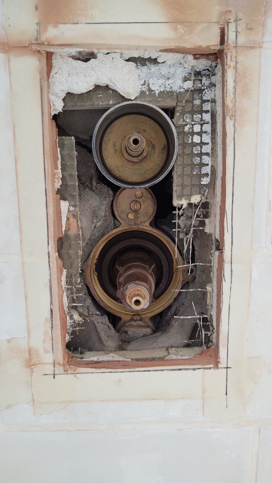

Right... I have the therm cartridge. I widened the opening and the collar and retaining nut are removed. I gently tried to pull out the cartridge by the end bit but it isn't budging. Any advice on what to do to get it out in one piece?

The valve is held in by 'O' rings, so it should come out with a twisting/pulling motion.
I don't know if this might work, but you could carefully turn the water back on briefly to moisten the seals?

And thanks for all your help! I'll give it a go.
By O rings do you mean the three rubber seals around the body of the cartridge?
I pulled hard and it came out. Now the task is to get the new cartridge in but the damn thing isn't playing ball. It's not going in fully. YouTube video says to press in hard but so far it's not playing ball

If you have something like Vasseline, try rubbing that on the 'o' rings.
It may also have to go back in a certain orientation, but I don't know for sure.
