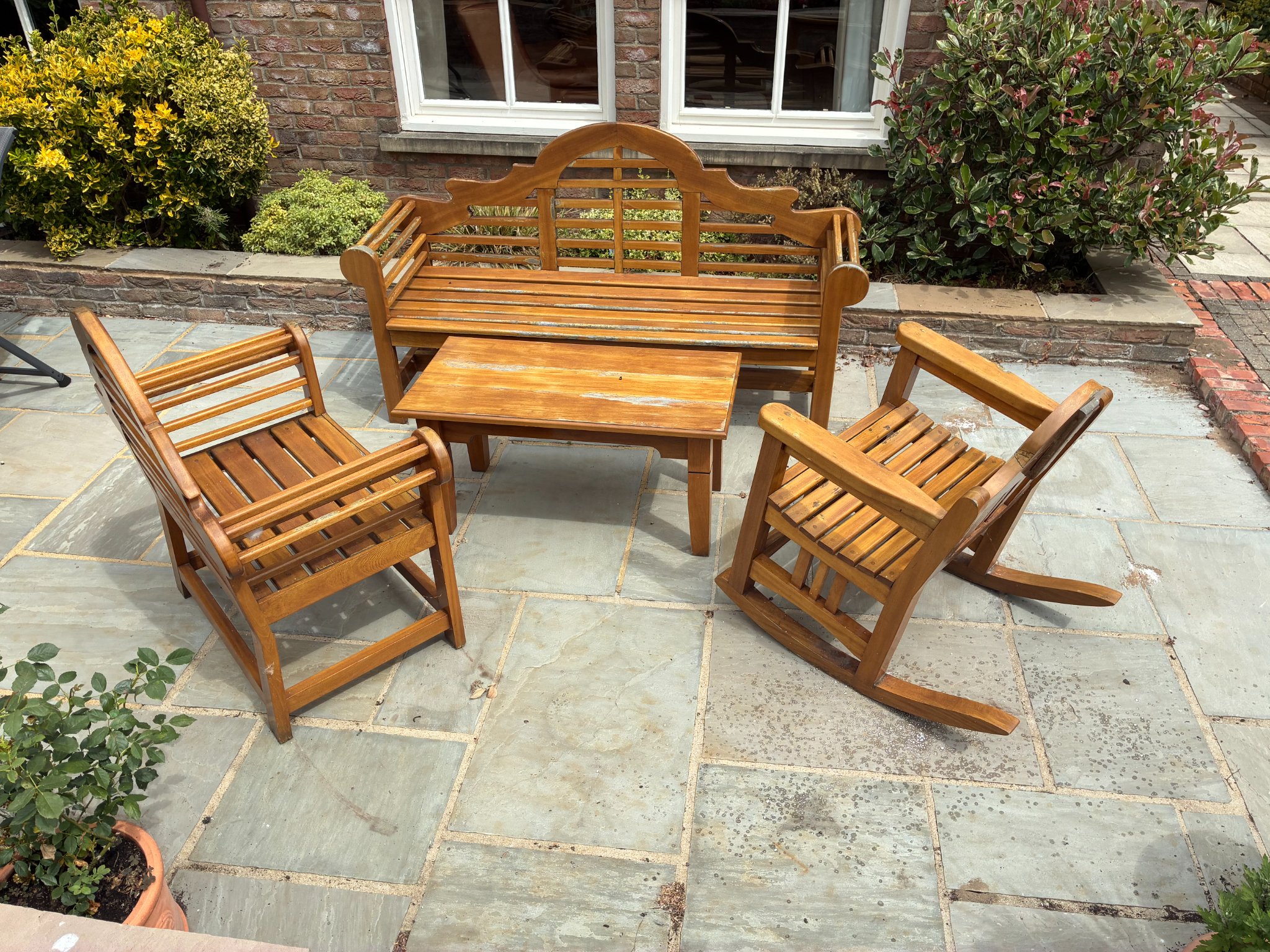

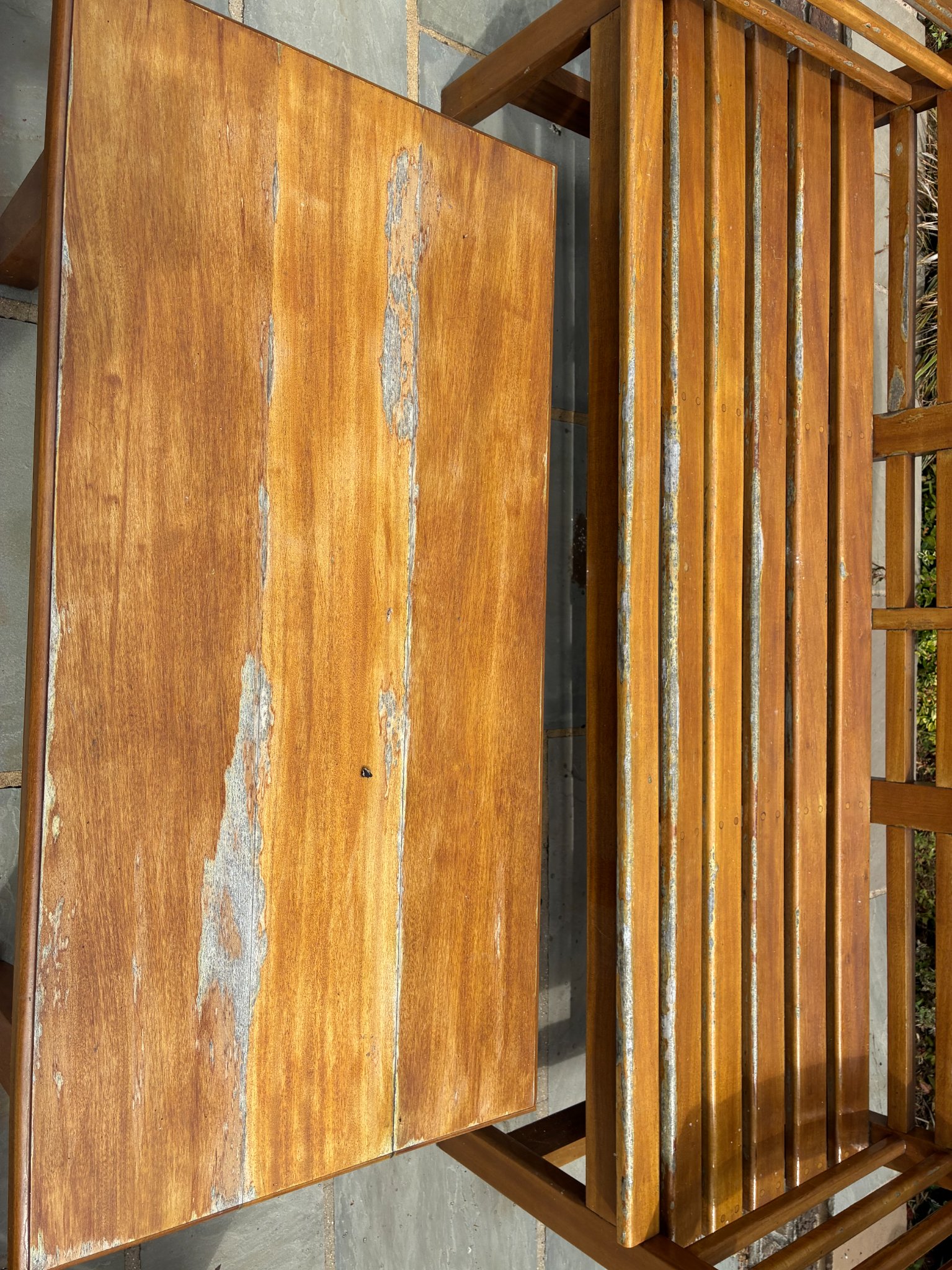

I made some patio furniture out of supele some years ago and finished it with yacht varnish, big mistake, anyway the varnish is peeling and has done for some time as you can see from attachments the wood is suffering damage in parts.
I have been told its caused by water getting under the varnish.
I would like to re-firbish the furniture, I asked a company about sandblasting the wood which is quite secure but that diodn't get anywhere so what are my alternatives? pleaser don't say sanding as i'm already 80 years old and I think time would run out on me!

Couple of coats of garden furniture wood stain , go darker for better coverage .
If it was mine I'd give it a quick sand with a belt sander or drill sander attachment, to get the worst of the loose varnish off, then use linseed oil on any exposed areas. It will look patchy, but it will protect the wood.
will wood stain sat over varnish?
Is there chemicals that could be used to make a base for a wood covering to sit on?
I volunteer at the local heritage railway. We have a load of benches, and the painting of these has become a big problem. So we have tried using plastic, but that's costly, so at moment doing an experiment with water based paint.
Getting the old paint off is not easy, one year someone used paint stripper, but is got into the wood, and new paint also came off prematurely, the belt sander needed the bench dismantling, so to do a quick job, I tried a flapper wheel on an angle grinder, not perfect, but reasonable, but since painted, only needed it to be smooth, did not need to remove all paint.
We tried treating with wood preservative first, it did not seem to really help.
Your benches look rather hard to sand, even with a flapper disc, or any other type of mechanical sander, and can't see a heat gun helping much either, so I think I would use wood preservative to stop exposed wood getting any worse, and just let the varnish come off in its own time. Cuprinol or Ronseal clear oil is what I would look at.
