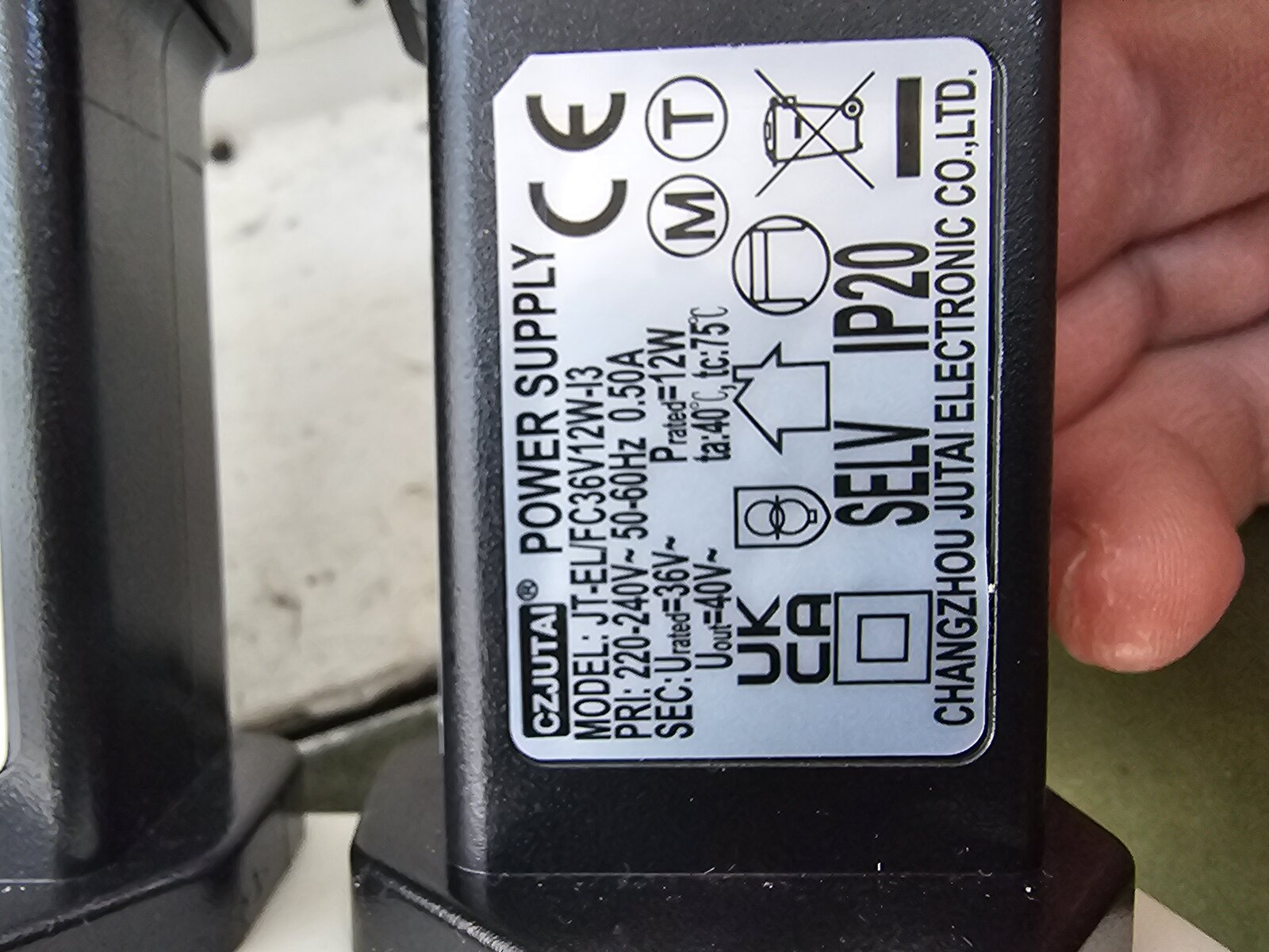

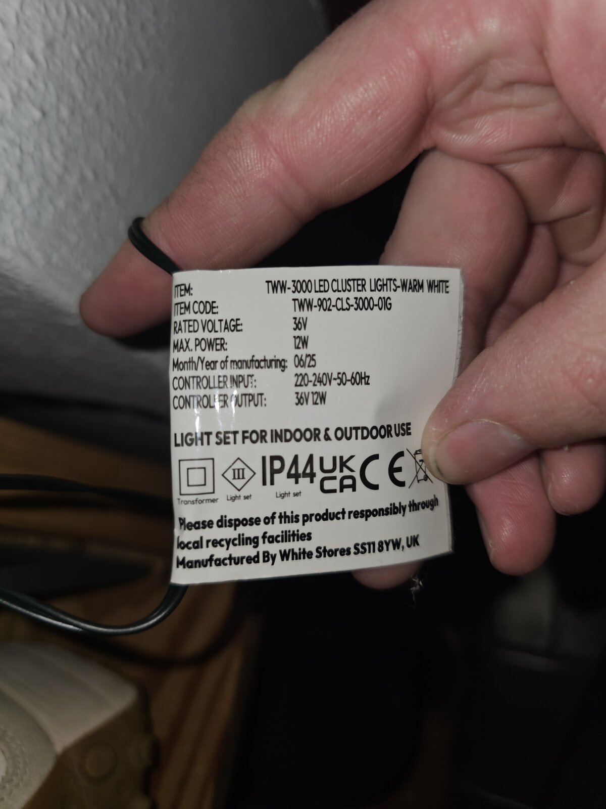

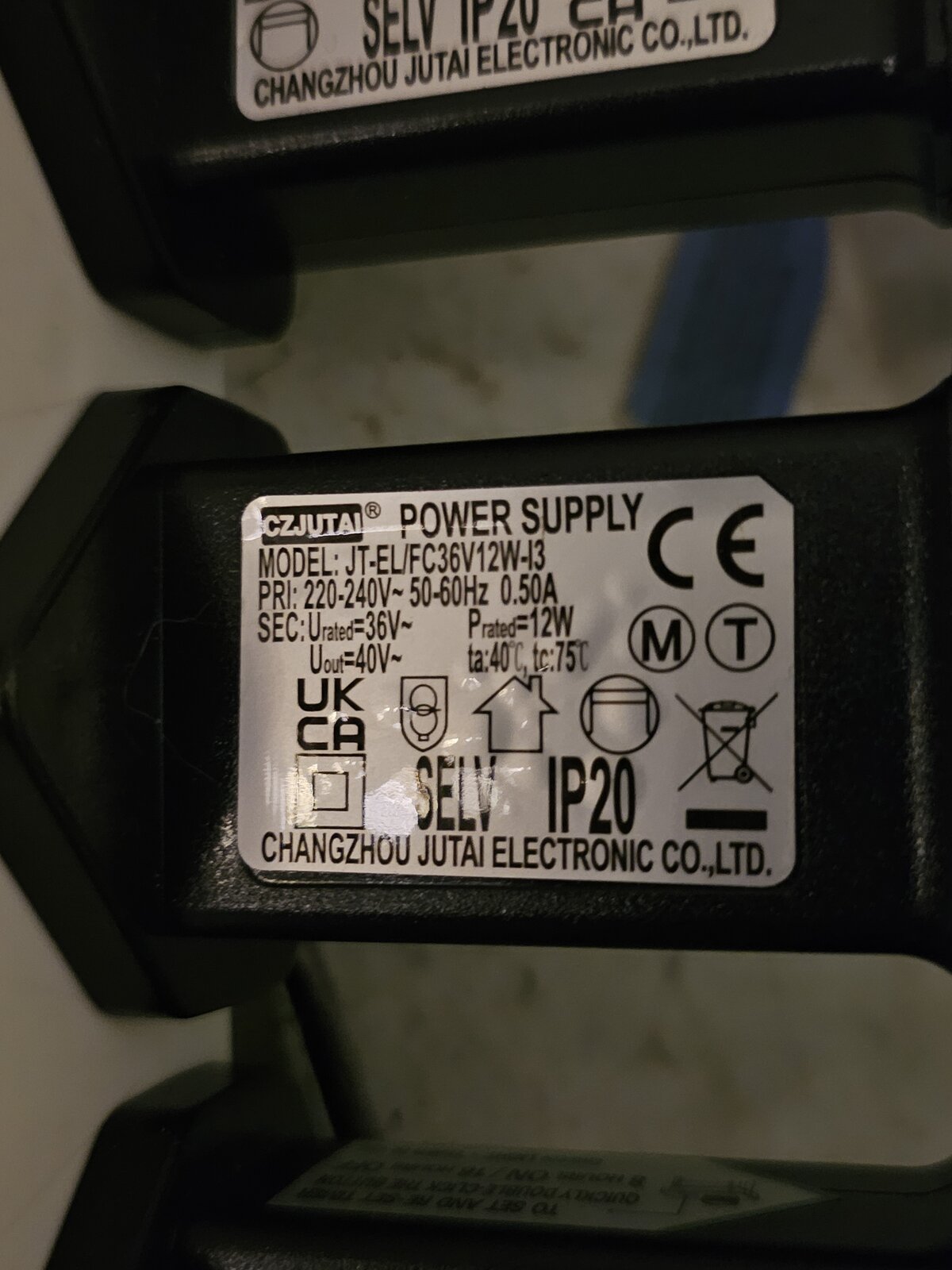

Hello,
Just after some advice from someone who understands power wattage volts amps. Ect
I have a new set of 3000 cluster lights but they are very dull, ( all the same brand) I notice they are running the same transformer as my other which are 1500 cluster half the amount
Can I get a better transformer to help with the dimness all attached pictures
Pictures are of the label off the 3000 lights
And the transformers supplied for both 1500 and 3000 lights
Can I get a higher wattage or amp

The 3000 set is rated for 36 volts, and that is what that power supply provides.
Whether they are 'dull' or not is unrelated, that's how they are designed.

The only mention of wattage is on the label in the picture, and it says 12W and that's the same on 3000 and 1500

Oh refers to the amount of lights one set of 3000 cluster lights and 1500 but both supplied with a transformer below both brand new but the 3000 light set is considerably dim

you have 2 sets of lights:
one is 3000 lights and a total of 12W of power or 0.004W per light
t'other is 1500 lights and a total of 12W of power or 0.008W per light
Do you expect a 0.004W light to be as bright as a 0.008W light?
The 3000 will be, roughly, half the brightness of the 1500 when both sets consume the same quantity of electrickery.
Take/send the 3000 set back and replace with 2 sets of 1500.
This is the reason I limit my lights to strings of 1000 maximum
Merry Christmas.
