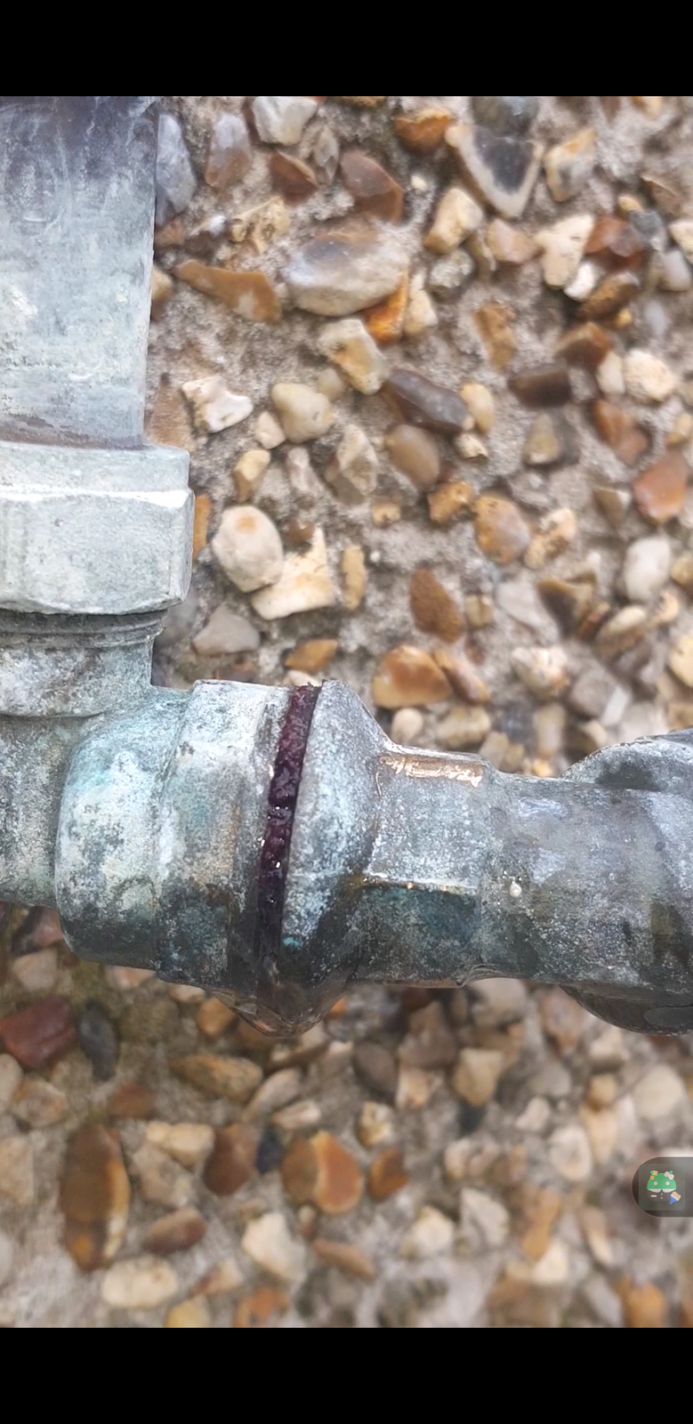

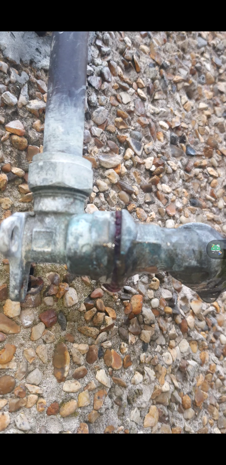

Hello everyone,
As indicated in the title, I'm dealing with a garden wall tap that's constantly leaking or dripping water. I'd greatly appreciate any assistance in resolving this issue. Thank you!
Looks like there is a fibre washer that's failed ,in between the tap and the wall plate.
Taking the joint apart and resealing the threaded joint with PTFE tape should sort out the leak.
