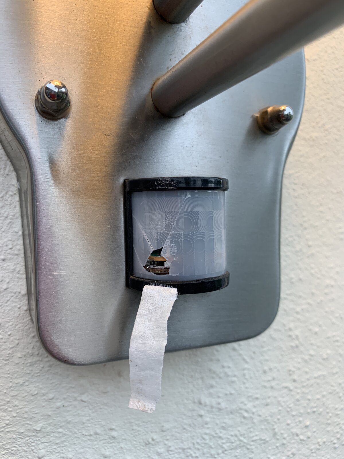

Outside PIR lights will not turn off.

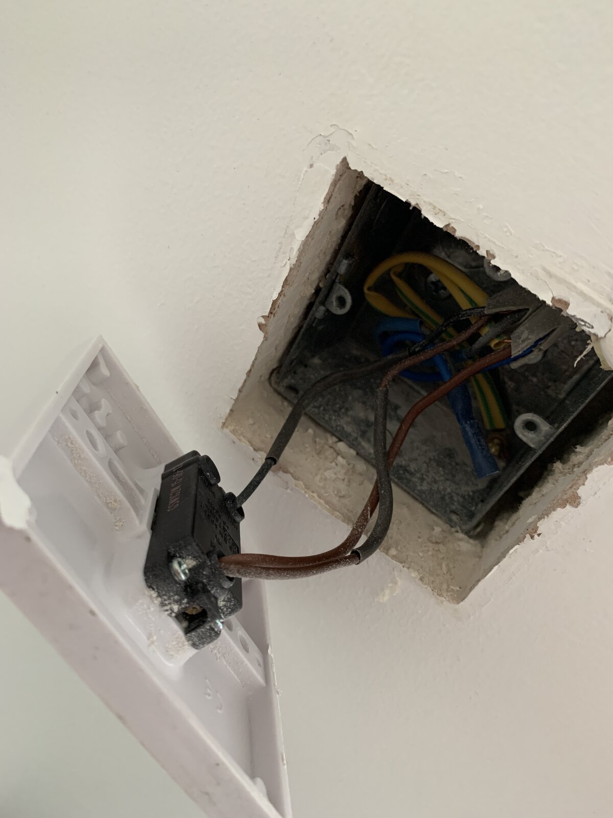

Turn off the power to the circuit at the MCB. Remove the single cable from the switch ( the one that is in a terminal on its own )and put it into an insulated terminal block . Turn on the power at the MCB. If the lights now go off ,but will operate as usual by the PIR's ,then the switch is duff. If they come on and stay on then it's a PIR issue.

I did this and the lights stayed on. So it seems its the PIR. Gonna look for a replacement or a new light.

Disconnected the damaged one, still the same, disconnected the other one and reconnected the damaged one and they are now running off 1 PIR.
Just gonna cover the damage and see how it goes.

It was more temporary to locate the fault, leaving maybe a problem if the total lamp load is now excessive for that pir, it seems at least you found the dodgy pir
Some will keep the lights ON if you switch the power off and ON within 3seconds. Try switching the power off and leave it off for say 10seconds .

As you may have seen from responses, many of these have there own quirky process of resetting or overiding if you can see the manufacturer on the inside (which is unlikely) it will be the easiest way to confirm the process for this particular one. As regards pir itself they can be sensative and broken lens, spider webs can play havvock with them.
