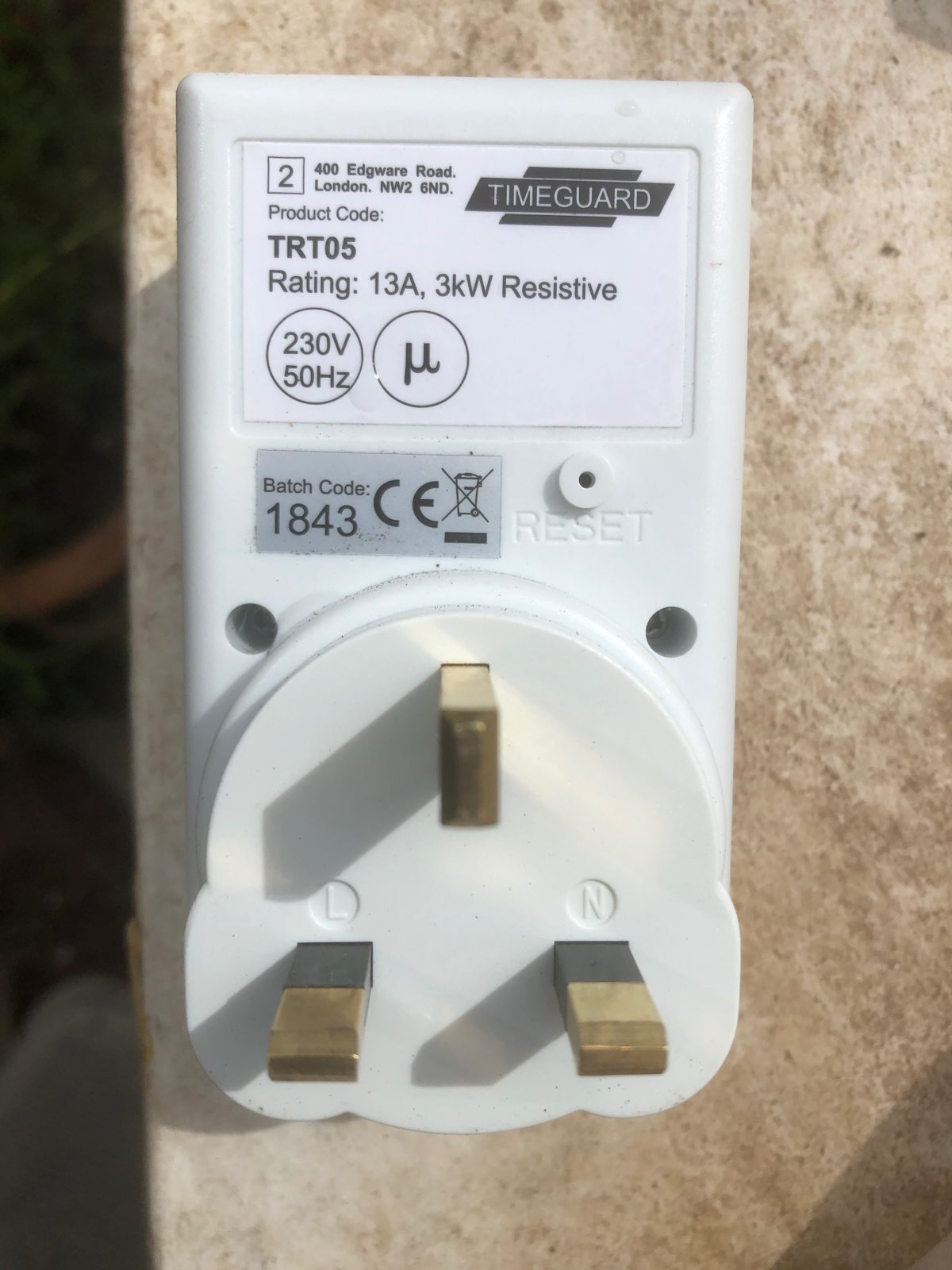

I have a house supply from which a cable supplies a separate circuit breaker box in the garage with 4 sockets on a ring main. One of these has a spur to the greenhouse through a heavy duty armoured cable. The fuse box is 15amp and a fan heater plus thermostat control is plugged into the greenhouse socket. When switched on this immediately trips the whole domestic supply circuit breaker in the house but not the circuit breaker box in the garage. There is no water ingress and I have checked all the wiring and it is 100%. What is wrong?
please post a photograph of the thing that keeps tripping, close enough that we can read all the letters and numbers on it.

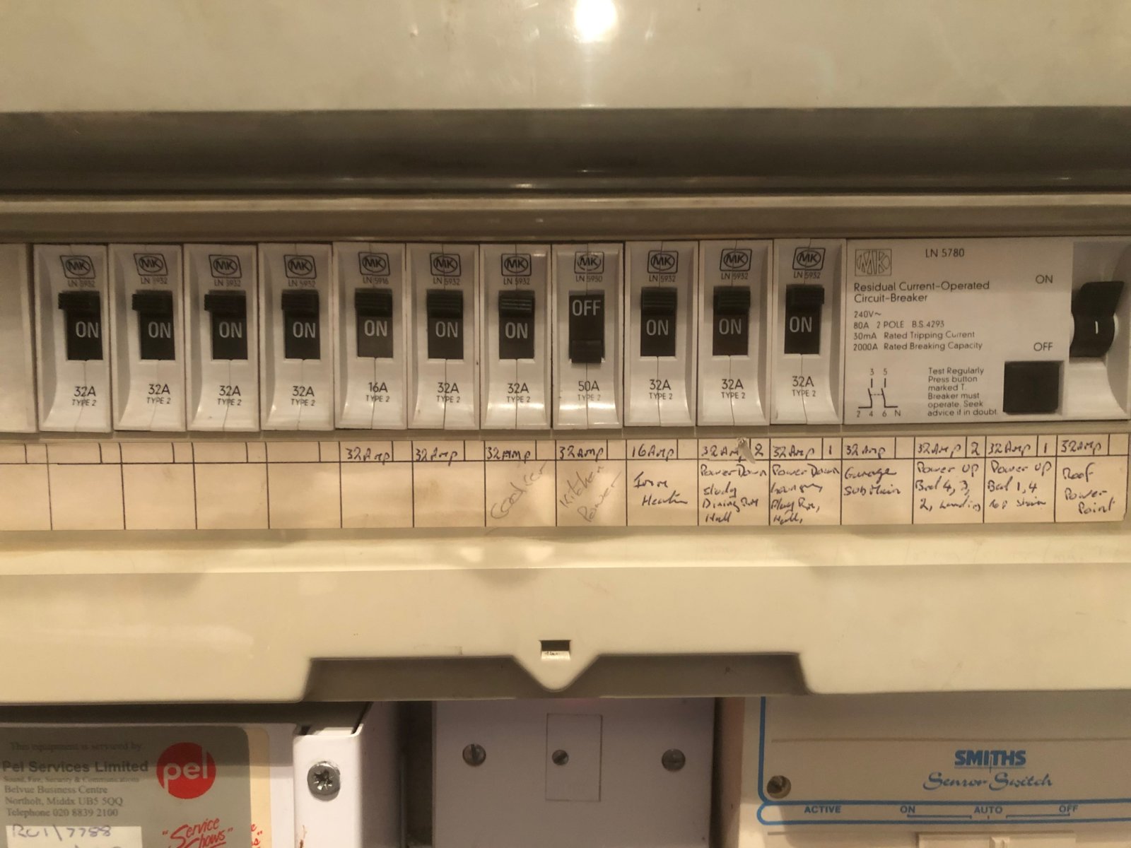

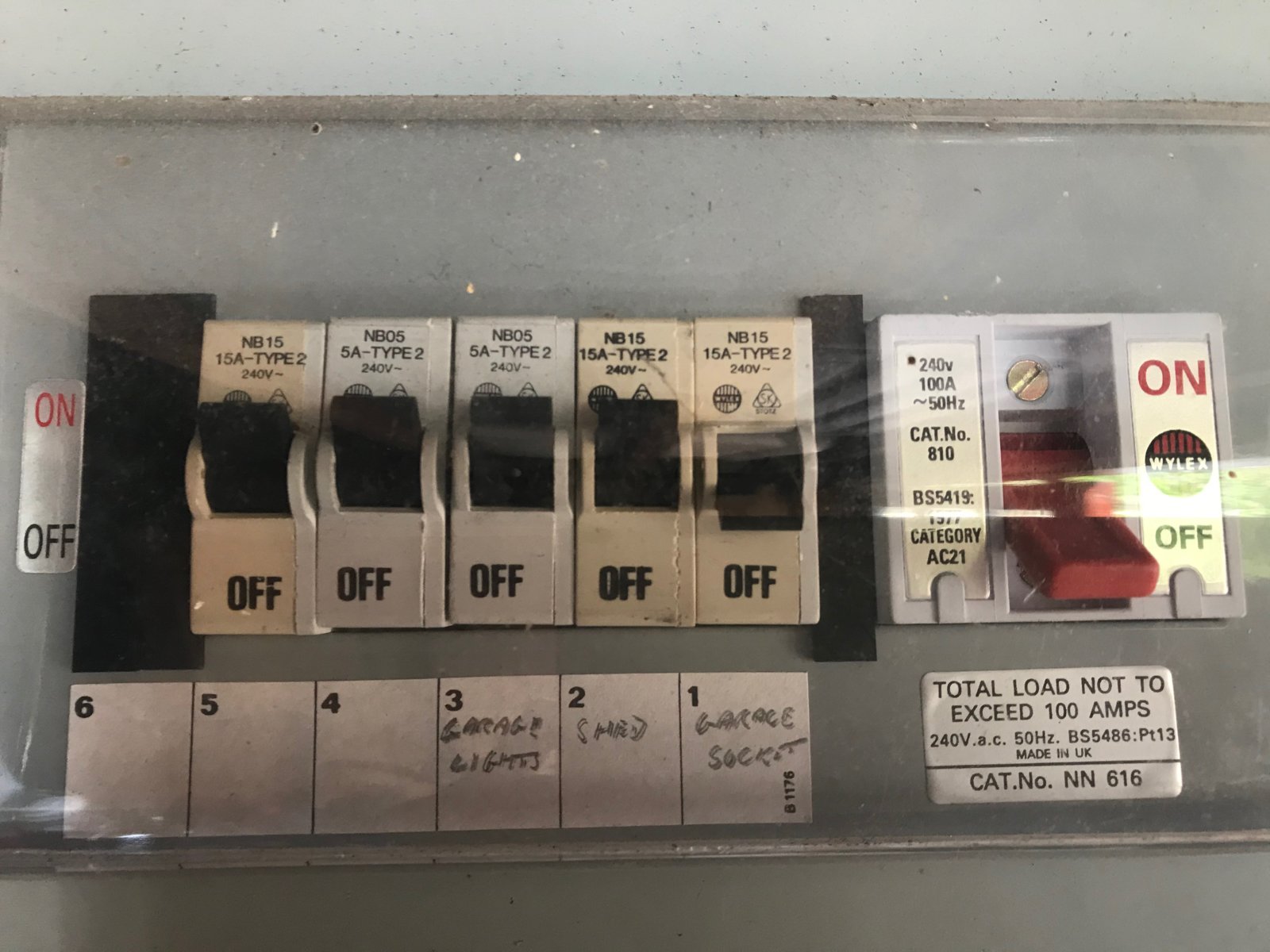

Also post a photo of both the consumer units, with the lids open, so that we can read the circuit labels.

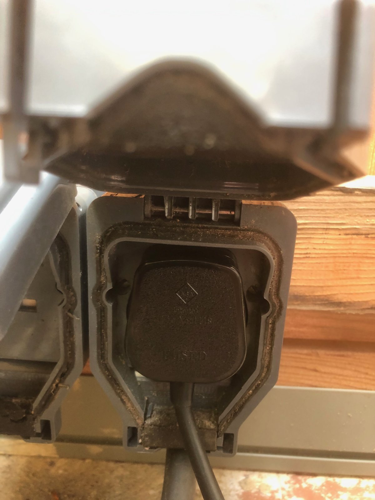

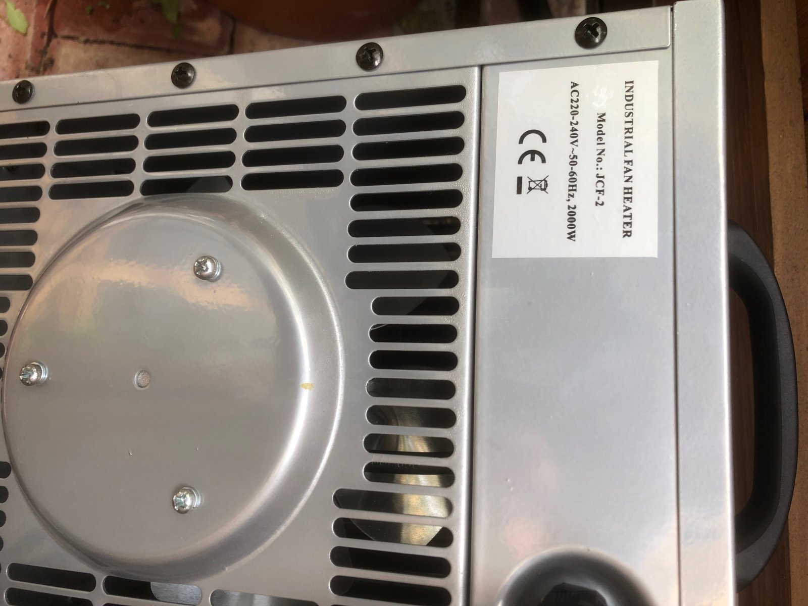

and of the heater and the thermostat and the socket.
You can experiment by taking the "faulty" electric heater into the house, and plugging it in there. Include the thermostatic control and any connected extension needs. Is it damp? How old are the heater and the thermostat?

Thanks. Here are the photos. It is the larger consumer unit that trips on the main switch, not the circuit breaker to the garage supply.I have turned off the breaker to the garage. The small consumer unit has the socket supply breaker turned off. None of these trip.

Has it always done this? If not, what happened around the time the fault appeared. What happens if you plug a kettle in instead of the heater?
Love the offset positioning of the labels on the main CU - WOE?
I can't see which breaker has tripped. Which one is it, and what letters and numbers are on it?
The main consumer unit (the larger of the two) trips on the whole mains supply so everything goes off. I have just turned off the breaker on the main consumer unit for the garage and then in the garage on the consumer unit circuit supply that leads to the greenhouse,

For example, in this pic I can see twelve devices
img_5231-jpeg.192910
By transposing those labels to the left, and tying them into to the corresponding breakers, then the 50A Garage Sub Main is the one you are talking about when you say it trips?

RCCB (RCOCB) Main Switch.
Have you tried to plug another appliance in the socket in the green house to see if it still trips? This can help narrow the search area. i.e. appliance or circuit.
Actually my comment is wrong. The tripped MCB is rated at 50A but on the labelling there is no 50A mentioned.
