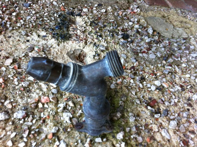

Hi ,
It appears we have an unusual size tap outside as shown in the picture..
I tried with Hozelock tap connector white adapter, it needs slightly bigger than 3/4 inch adapter(but not 1 inch).
Please can anyone tell me if you have any suggestion for the tap connector.
If you mean this one:
or this one:
you have removed the white bit, haven't you?
They are the only tap connectors/adaptors with any white on.

That`s 1/2 inch and 3/4 inch BSP you`re looking @ ;) And that beast is a Delta tap c. 1980`s with a 5/8 th. BSP :p . Look inside and you`ll find a domed washer - it`s doomed , get a new 2013 one from China ;)
The wall plate elbow should have the same thread as a conventional new bib cock tap, so its old one out and new one in.....complete with a check valve, maybe?
