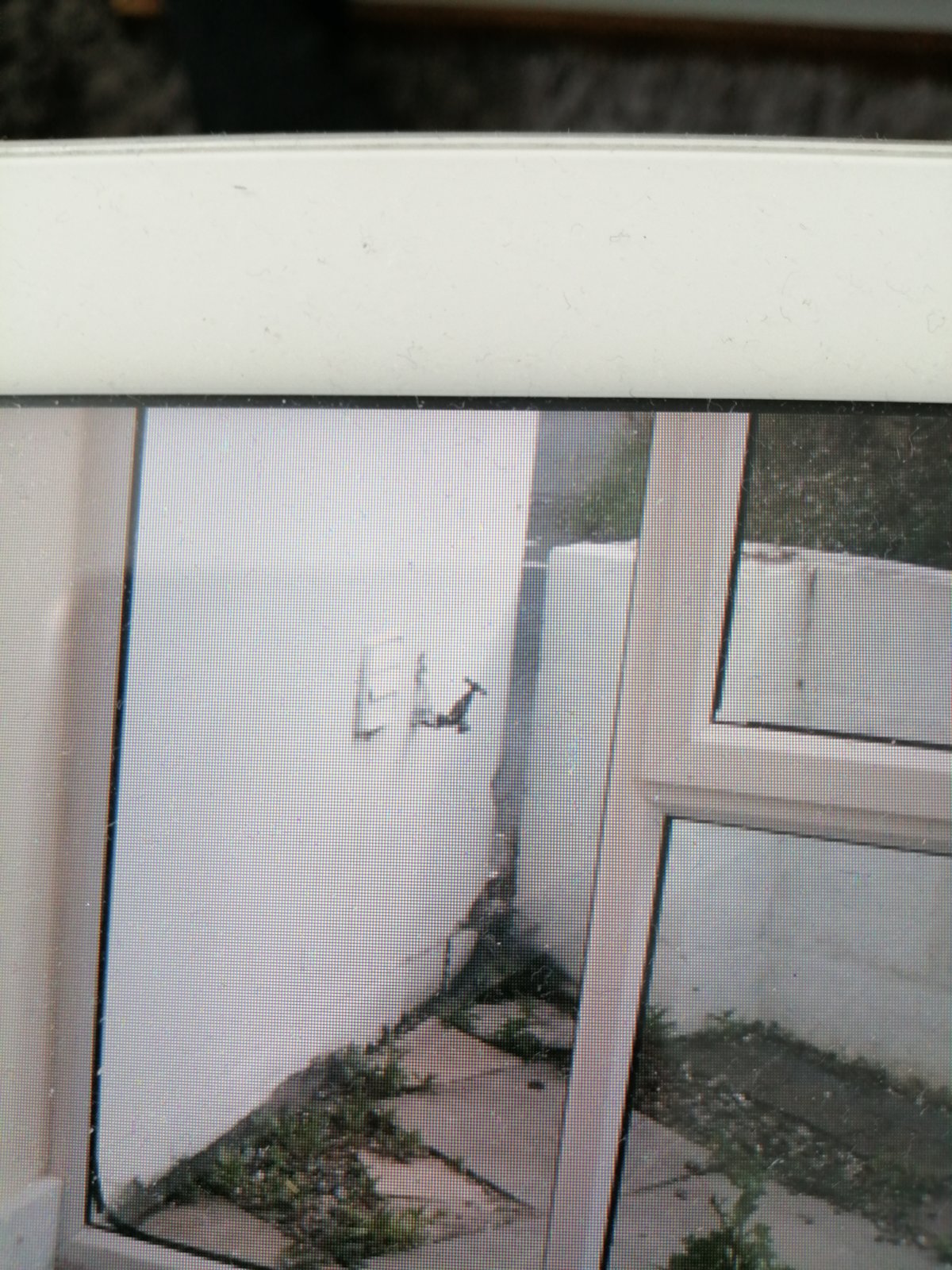

Hello,
Looking for some advise before I start cutting into walls or lifting floors.
I have an outside water tap (on the external wall of a lower floor bedroom) that doesn't work, took the tap off and still not a drop of water. There is no visible stop tap/valve anywhere near. Is there any other reason why there is no water coming out?? Any ideas where stop taps/valve would usually be on outside tap??
Thanks in advance

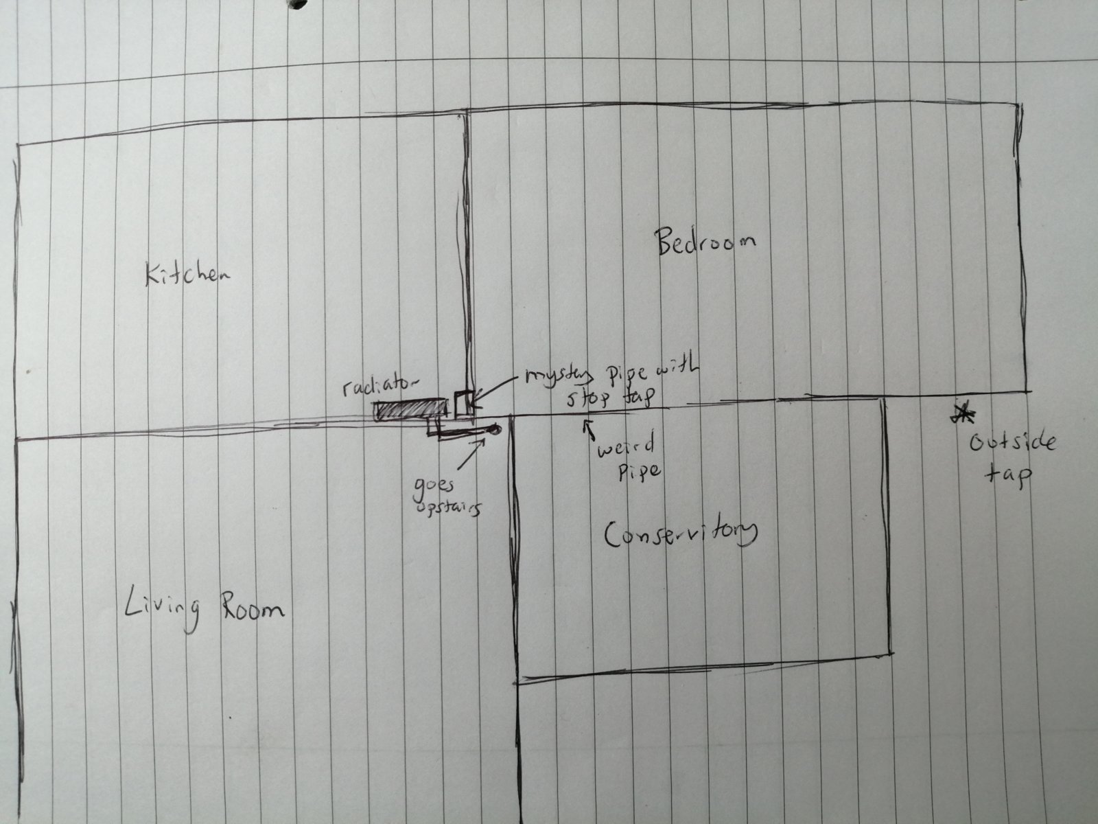

Hi all,

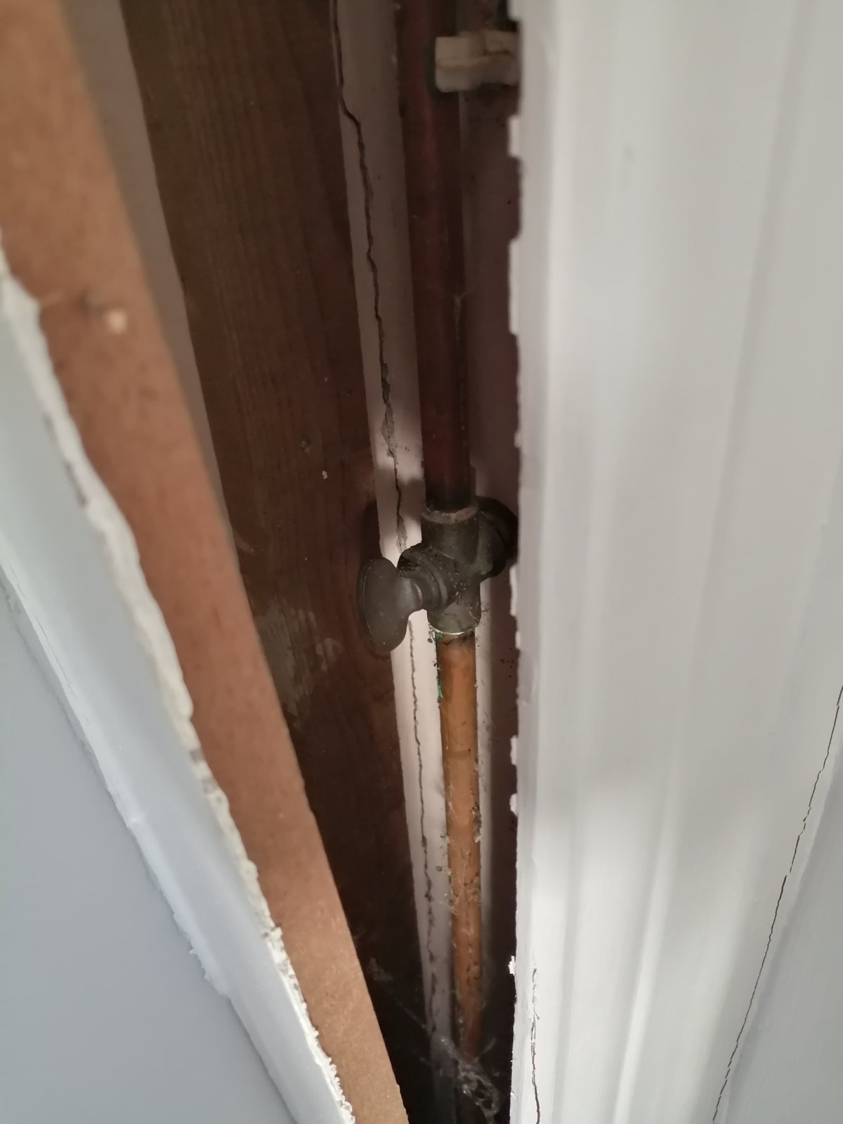

Still no obvious sign of a stop tap so I've started opening some boxed in pipes to try to find a stop tap for the outside tap.
I have found a pipe that was boxed up with a stop tap that's fairly close to the outside tap that goes upstairs. The stop tap was in an open position. I've tried turning it the opposite way and I can't for the life of me find out what is linked to as all taps in the house still work when turned off. Could this be a gas pipe?? How do I differentiate between a water and a gas pipe??
I have attached a drawing of what I've found so far and labeled them on a floor plan. My thoughts at the moment is that the outside tap goes into the bedroom behind the plaster board... Comes out again into the conservatory and goes back into the bedroom (weird pipe formation). Here it is boxed up and has a stop tap... The pipe goes upstairs.... Not clear where upstairs.
I hope this makes sense. Any help would be greatly appreciated

Fittings can be a clue (to the experienced), the photo with a plug cock is a gas pipe, I haven’t seen any of those used on water.
Thanks, that explains why all the taps still work. Judging by the height of where the pipe in the conservatory goes into the bedroom I now think the pipes leading to the outside tap is under the raised chipboards floor in the bedroom. A strange place to put a stop tap though??
