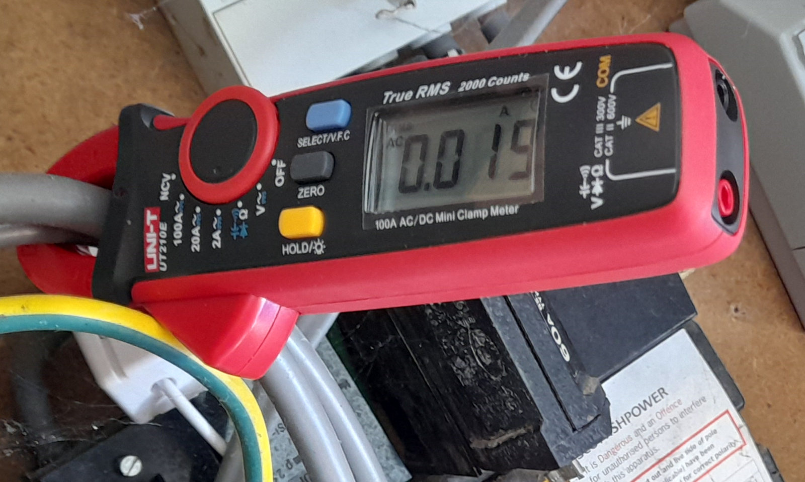

Seems likely the seals on the oven element have gone faulty, and the hydrophilic nature of the mineral insulation has absorbed water, and it is on the neutral side, and the more the load, the bigger the difference neutral to earth, so more chance it will trip.
To test, there are two tools, VC60B.jpgDiffrence line neutral 8 Feb 24 reduced.jpg neither are likely to be owned by a DIY guy, so not sure how you can test yourself. Do you know anyone who can test it for you?

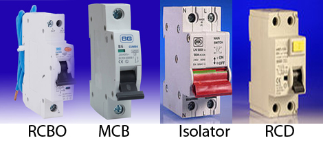

Is the oven the only item on the RCD, or might it be a RCBO which is tripping, for the oven circuit? An RCBO is a combined RCD + MCB, in the single device.

Does the thing which tripped, only supply the oven, and also have a button marked T or test?
Yes, the circuit is purely for the oven and hob. It doesn’t have a button as far as I remember, just a switch.
Edit - having Googled it, I’m pretty sure the circuit is on a MCB rather than RCD..
