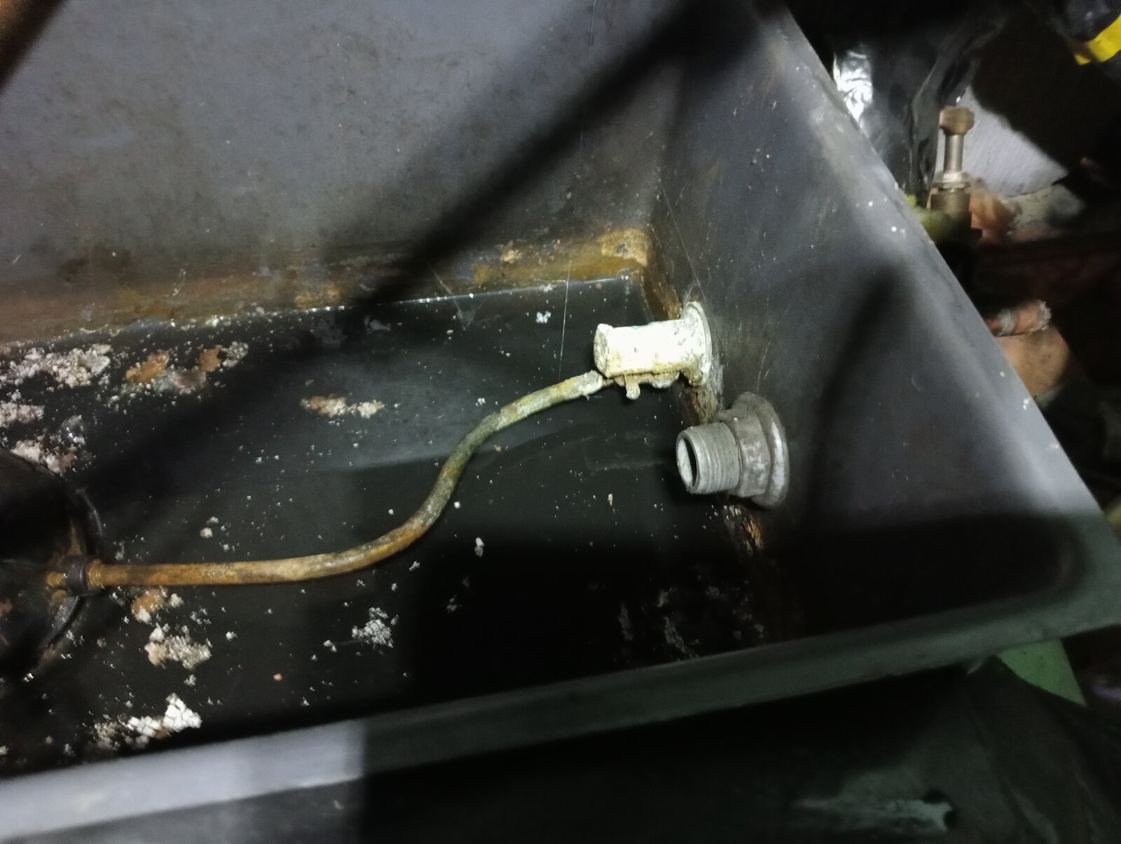

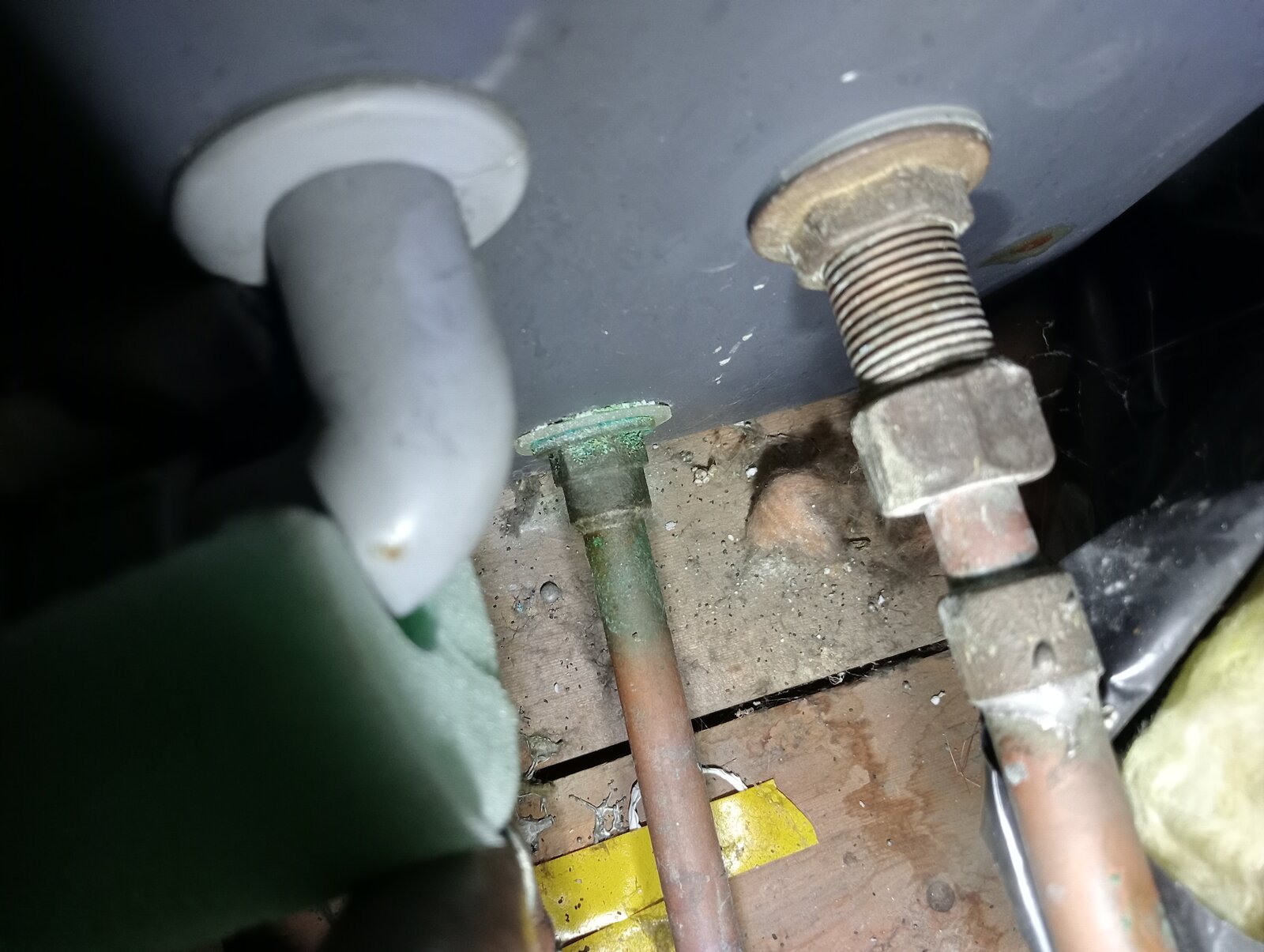

Went to a tank were I need to swap the fill valve the over flow is higher then the full valve. I was going to put a part 2 on it but still won't have an air gap. Any one come across one poorly installed before.

It's admittedly not ideal because the water in the tank will cover the fill valve before it overflows. But it'll still work as an overflow and stop water coming over the top of the tank, so it may not be worth doing anything about it.

Do it right IMO - is it an F&E cistern?
Mains needs to be protected against backflow so the overflow defo needs to be below the fill valve. You may get away with enlarging the fill valve hole for the overflow and glue a plastic washer/piece of plastic and drill new hole to take the new fill valve in the overflow hole. Water shouldn't ever get to the fill valve anyway if the overflow is below it.
Worst case is plug up and drill a new hole as you suggest.
The fill valve should just swap ok for another full valve. Was going to take it fully out and put a part 2 valve on it.
Do you mean may get away with putting the over flow were the fill valve is. And putting the fill valve were the over flow is.
