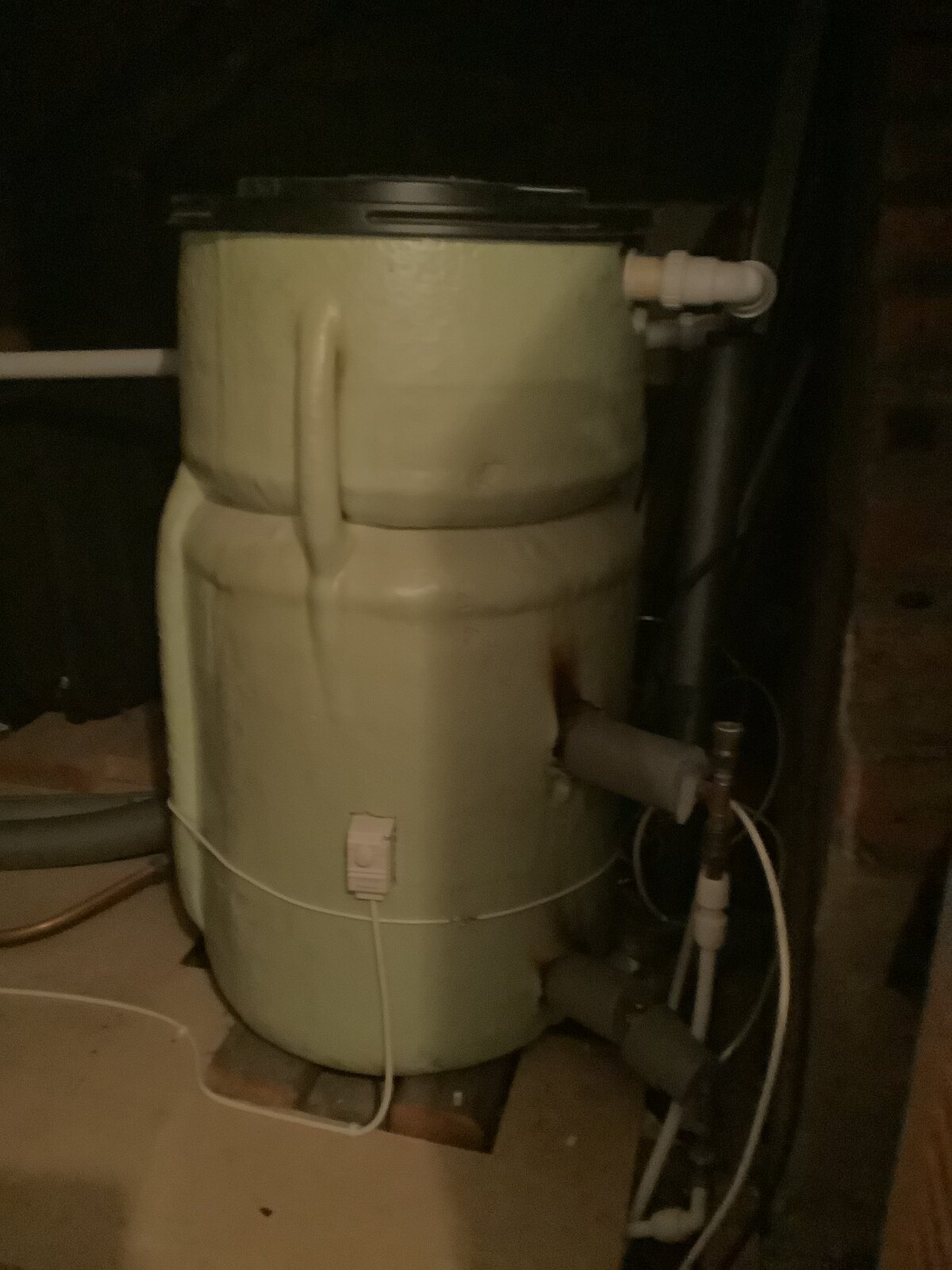

Hi the overflow from the hot water tank in the loft is constantly dripping I think it’s condensation any idea how to stop it.

This is the tank the water level is always below overflow out pipe

That's a combination cylinder,if the overflow isn't reached ,where is the dripping coming from ?
That’s what I’m asking could it be condensation in the overflow is there anything I could do to stop it

Disconnect OF from cylinder and see if it drips there. Can't see how it can be condensation but then again, I'm not there looking at it.
If it's condensation on the outside of an overflow pipe there would be multiple signs.

Yes it could seeing as it's a large overflpw (Scottish regs). And presumably a cold Scottish roof space.You could try isulating it with some fibreglass wrapped round it.
But why would it create condensation? There's no water in it!
Water in the feed cistern getting hot so an amount of steam getting into the overflow ?
