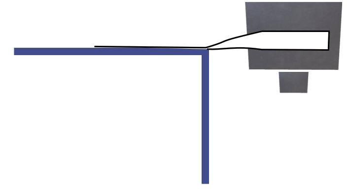

I've found ye olde 500W halogen fixed at the gutter of 2 story house, pointing down, is fine. It stops the light going to others' windows, and the area of the sensor coverage is also good.
Only problem was that because I wanted it to light the side of the building as well as the front, I mounted it on a twisted galv joist strap projecting sideways about 6 inches. That wasn't stiff enough so it was a bit bouncy in high winds. 30W LED PIR version (Toolstation £18) will replace it with a stiffer strap.
Looking from above - anyone got a better mounting idea?
