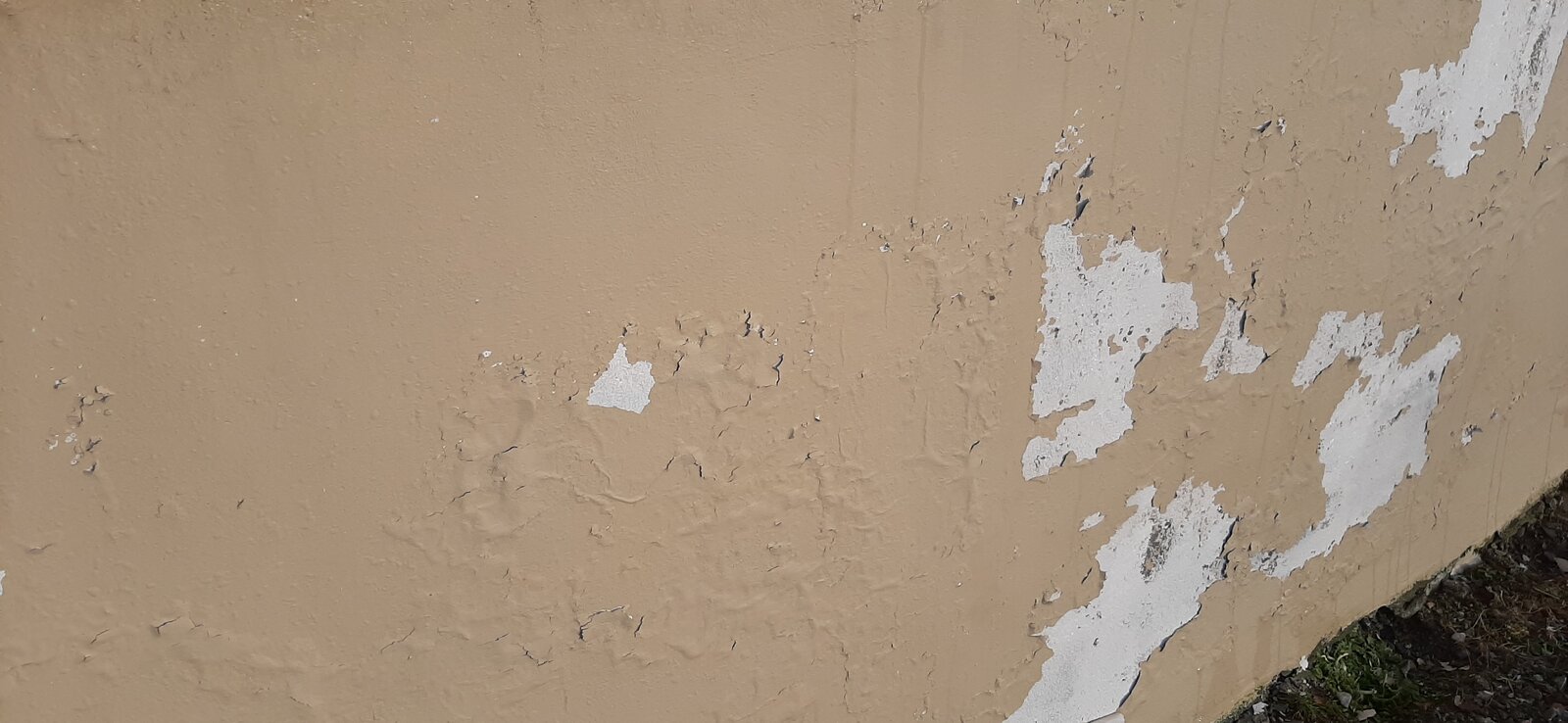

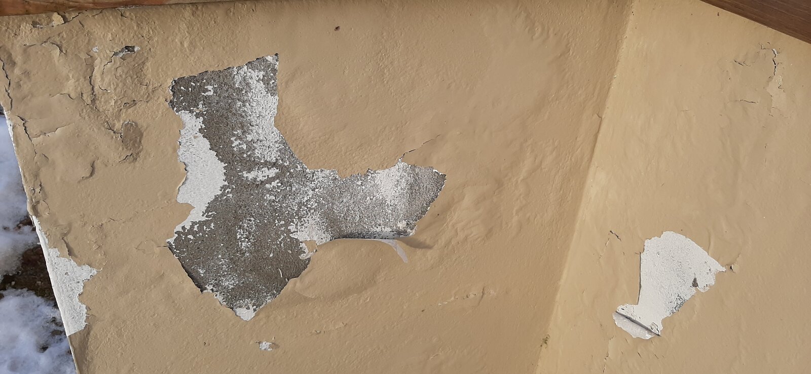

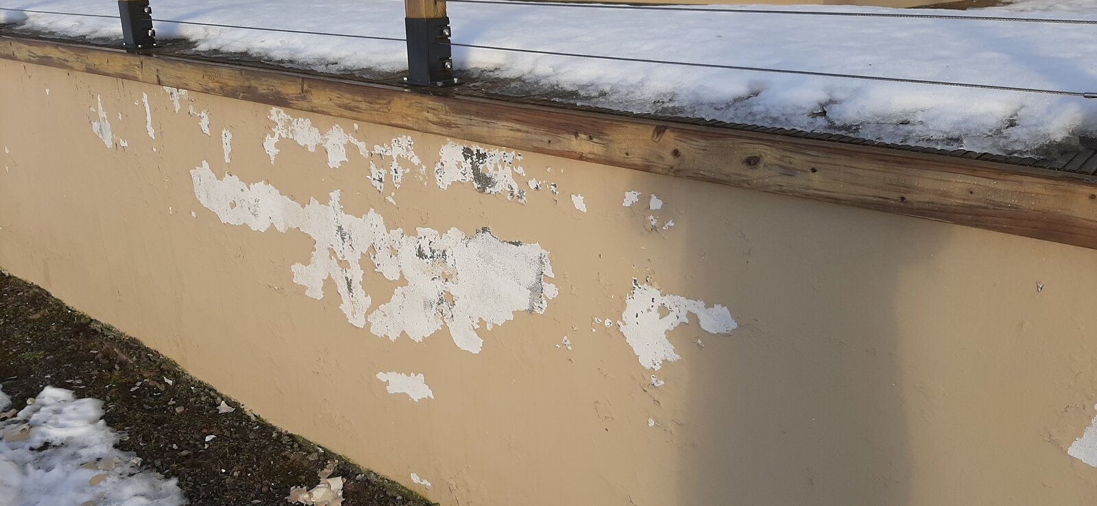

I am reviving my thread as an update to what has happened and hopefully find a resolution to the situation.
After the helpful advice I scraped off all the loose paint, gave it a good scrub with a hard brush and went over it with a softer brush to remove any dust. I did a mist coat then waited for it to fully dry before going over it with a top coat, this was fine until 2019 winter when it started to bubble again.
In spring 2020 I scraped off all the bubbled and flaked Sandtex and this time I used a water based white masonry primer & undercoat before two coats of Sandtex. It looked fine for several months until late autumn and winter when it has started to completely flake off. I will try to post some photos to show the extent of the problem.
I’m not hopeful that anything can be done as it’s obviously the fact that the concrete blocks and render are allowing the water to penetrate the retaining wall and then get behind the paint, but I would be grateful for any suggestions.
If the retaining wall has been I'll thought out it will just permanently allow moisture to seep through and will fail with respect to this time and time again.
