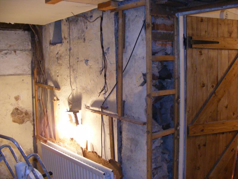

I have just bought a 1850s Sandstone House, we have ripped out all of the old pinboard (old fibreboard) in the living room.

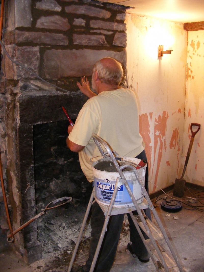

With the 4 walls we have one nice one which I am repairing and repointing so would like to leave this natural above the fireplace and and maybe paint the wall next to it as is also being repointed - What paint should I use
The other walls are not in such good repair so would like to either apply some render or should I go back to drylining but use more modern plaster board like celotex with a vapour barrier and some insulation.
Any suggestions or advice much appreciated

Wanted to keep the stone effect on the fire and the wall to the side but the other walls dont look so good so wanted to either render or dryline but not sure which and which render mix or which plasterboard due to needing the walls to breath
Here is the pics of the other walls
This pic is of my DIY step father repointing the fireplace
