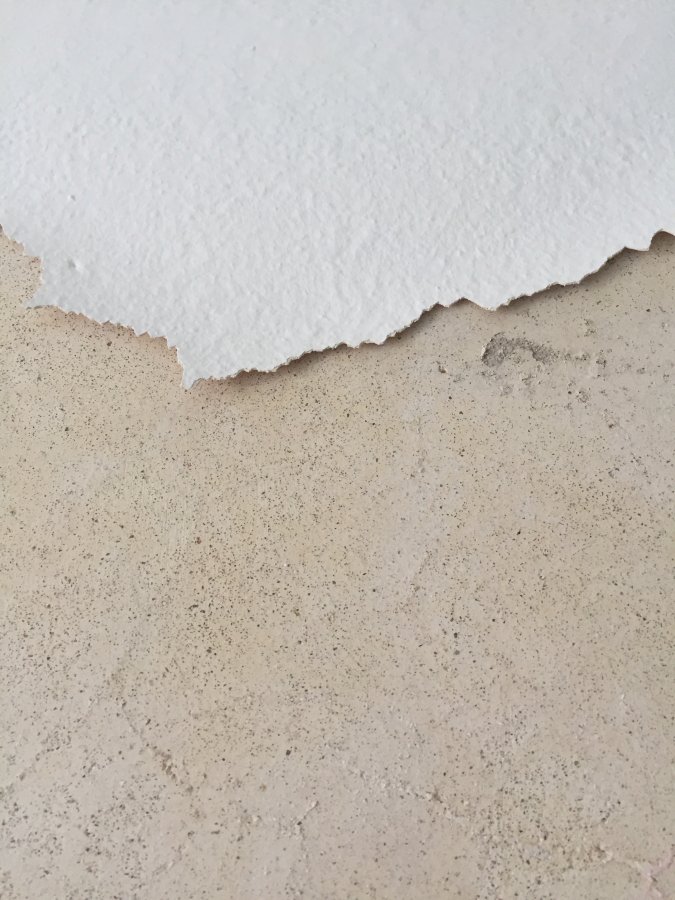

Hi all,
I have trouble with paint peeling off my bathroom wall. Ive decorated it a couple of times but now all the layers of paint have peeled off (see photo). Obversely its best to peel all the paint off back to the plaster but what do i do next? It looks like the plaster was never mist coated so should i do a mist coat or use a primer like BIN?
Many thanks in advance.

When I have come across this issue, I have taken paint back as far as possible, lightly sanded remaining painted surface, applied zinsser 123 as a primer. And so far on three or four projects, this issue has not reoccurred!
The other thing worth considering is making sure you've a good extractor fan for the damp air in a bathroom. It also can help :-)
Thanks for your replys. Im going to peel all the paint and get back to the plaster as its coming off like wall paper!! Does the zinsser 123 go straight onto the plaster with a roller or paintbrush? I'm upgrading my extractor fan as well.

I intend to peel it off and then mist coat with emulsion.
If you must use 123 then I would dilute it. I used it on a dodgy ceiling once and it dried too quick and peeled off.
Do you think there is any chance that some herbert has sealed the plaster with PVA?
Managed to peel it all off. Going to mist coat then prime it. ( not sure if that's overkill !!!))
