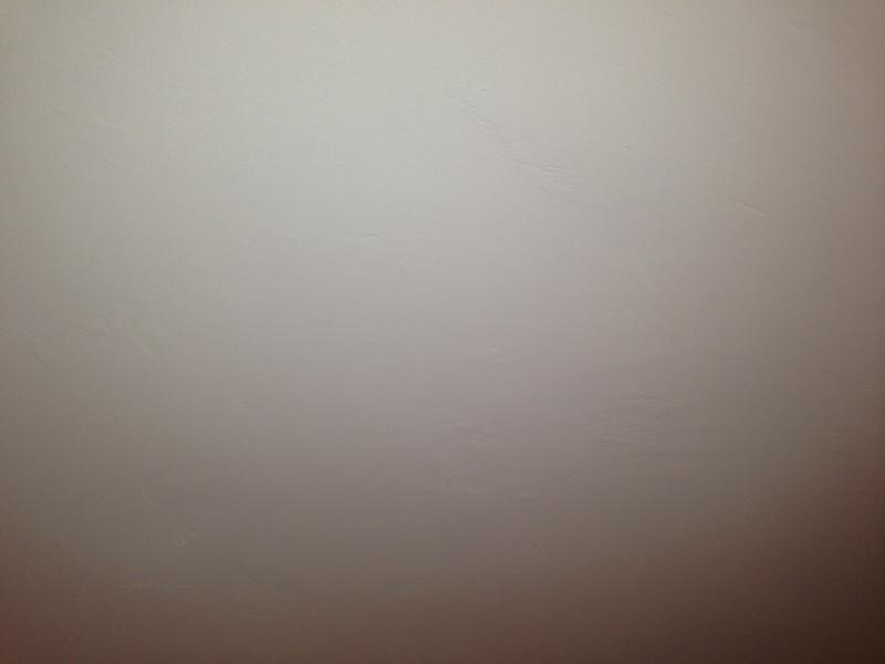

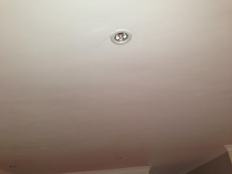

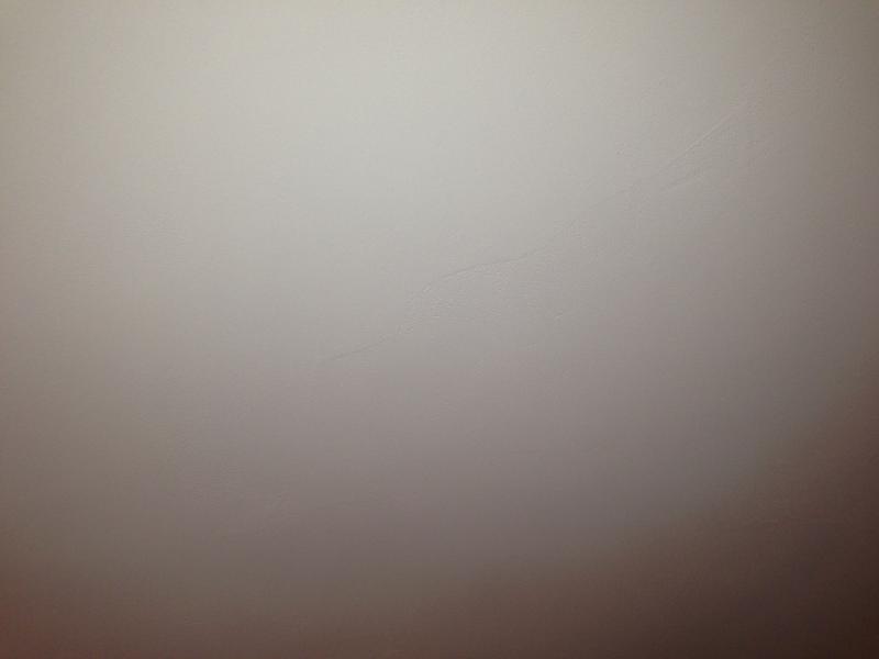

Hi,
I've had my artex ceiling skimmed. I've never had that done, so I didn't really know whether the plasterer had done a very good job or not. It looked allright. Few marks that looked sandable. I then mist coated it with thinned out paint. A lot more imperfections appeared. I sanded any visible protrusions. Filling in every recess seemed like a very very long job. I thought maybe after 2 coats of emulsion it would look a bit better.
So I've got one mist coat, 2 coats of emulsion and I think it doesn't look great. I would like a really smooth finish, but when the spot lights are off, the ceiling is visibly imperfect and cloudy. I've attached some pictures.
What are my options if I wanted smoother aside from replastering? Should I :
* Keep adding emulsion coats , it will reduce the cloudiness
* Use some sort of polyfill basecoat and apply 2 coats with emulsiom
* Use lining paper and recoat with paint until good finish. Will lining paper hide imperfections well
Anything else I can do?
Thats **** poor plastering.
Lining will be better than it looks now if its done properly but getting a decent plasterer to skim it again would be best, doubt you'll be able to get anything out the original guy
Thanks for the reply.
I think I will go for lining and see how it looks.
