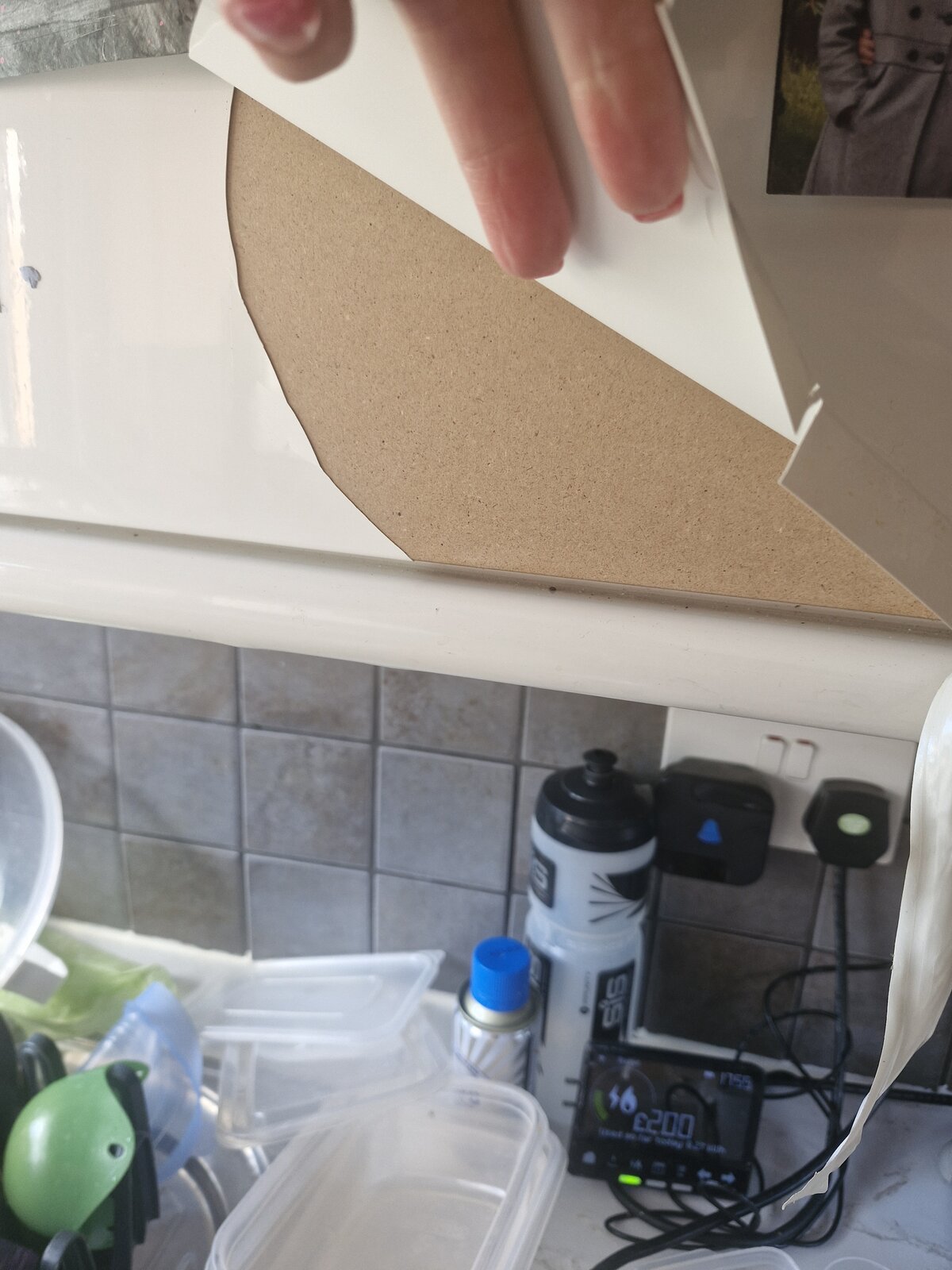

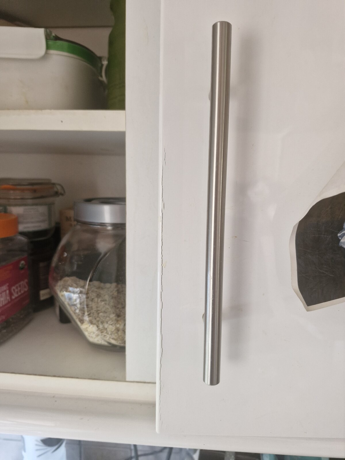

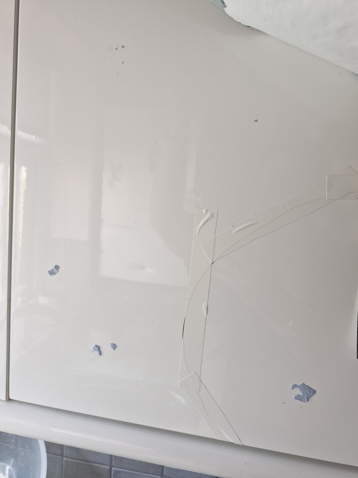

I hadn't thought about just getting doors. In an ideal world I'd replace the whole lot but I don't have a job and need to eat first and foremost! These photos show the damage. If I can glue it, that'll be easier but I did like the idea of at least changing the colour.

I had similar in a utility room on one door. I've stripped and painted the whole lot. In a nutshell:
1. Remove wrap, using a heat gun if necessary
2. if surface looks fine, prime, I used Zinsser 123
3. Move on to painting, my paint system wad a undercoat and three top coats.
We're happy with the results, however:
1. It looks more rustic than vinyl wrap
2. It's probably not as hard wearing
3. If your mfd door isn't properly smooth it'll show) some I wish I'd put some fine surface filler on between priming and painting
4. You'd need go do the whole kitchen, and trims/pelmits, or it would show up.
Total cost will be far less than a whole set of new doors. But, outlay forjust one door will probably be more costly than replacing just that door.
