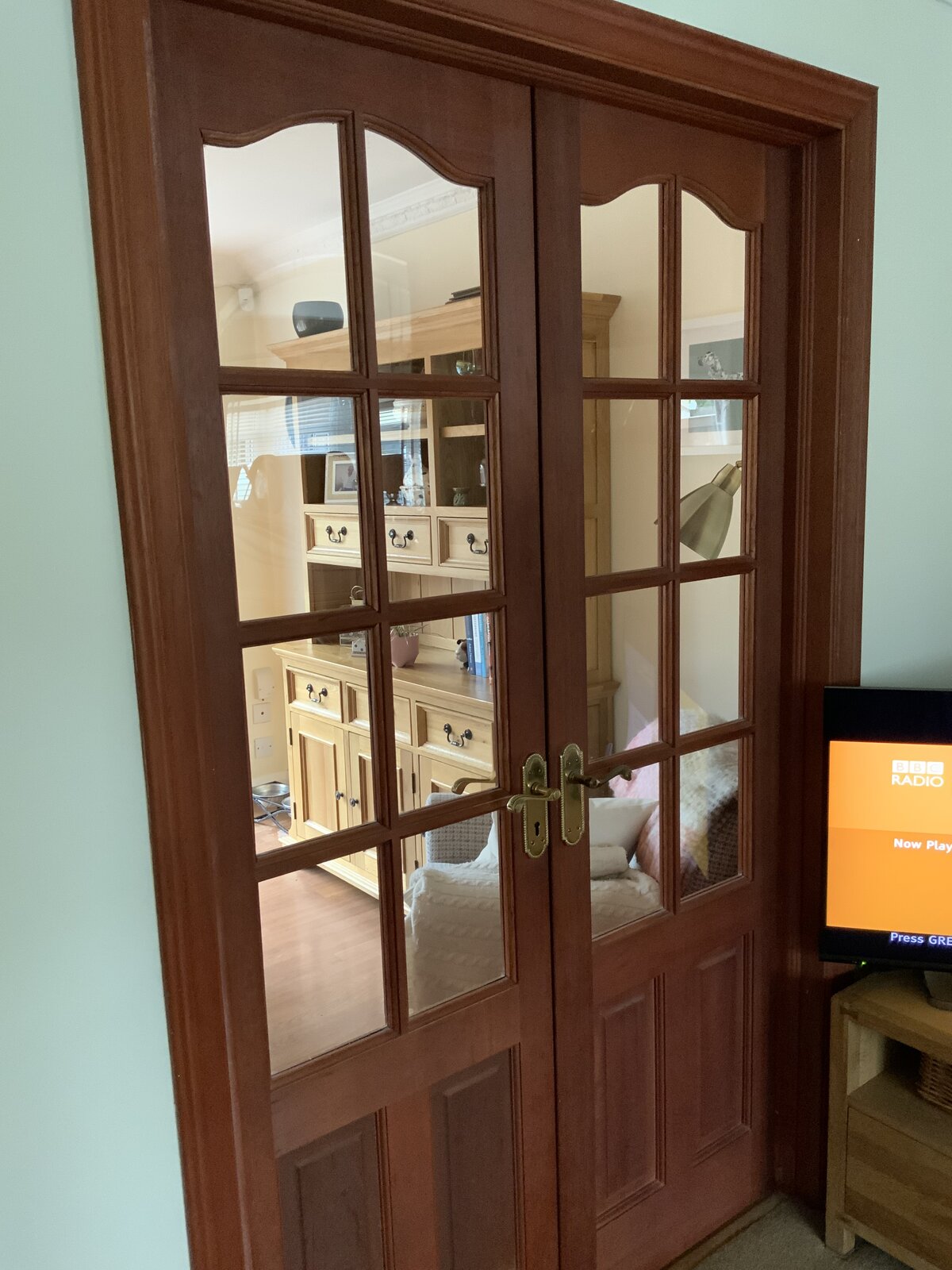

I want to do the same with our stained doors and someone told me I should varnish them first to seal them and then paint them. Can any painters on here confirm this?
Not necessary.
A stain will not make any difference to how you would treat any unfinished wood.
So, sand down, pass a white spirit cloth to clean any residue, primer, undercoat and gloss.
Forgot to mention, any knot must be treated.
Never wash (naked) wood with water. It causes the grain to swell. That said I often use waterbased primer but do so in the expectation that I will need to sand it flat again. I sand with 180 grit sterate coated silicone carbide (not aluminium oxide) and then use OB undercoat.
Are you sure that the stained doors weren't sealed previously?
I don't understand the advice to varnish them first though. Varnish under paint often leads to chipping unless they are thoroughly sanded.
If the doors have been waxed you will need to sand back to the bare wood. I have known other decorators on sites where I have worked that lightly sanded them and then used Zinsser BIN as a primer. Every door had chips once the cleaners finished hoovering the new carpet.
Pretty sure they’re not. I bought them from somewhere like B&Q about 20 years ago. Came as a kit - liner, architrave and doors. I just fitted them as they came out of the box and never did anything to them at all.
