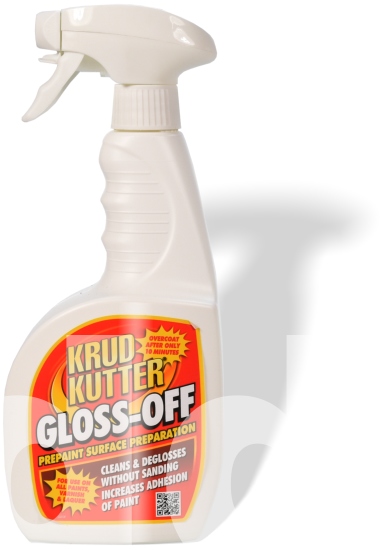

You can also buy a liquid called "Gloss Off" This takes the shine off the gloss and etches the surface ready for what ever you put on next.
Krud Kutter Gloss Off
