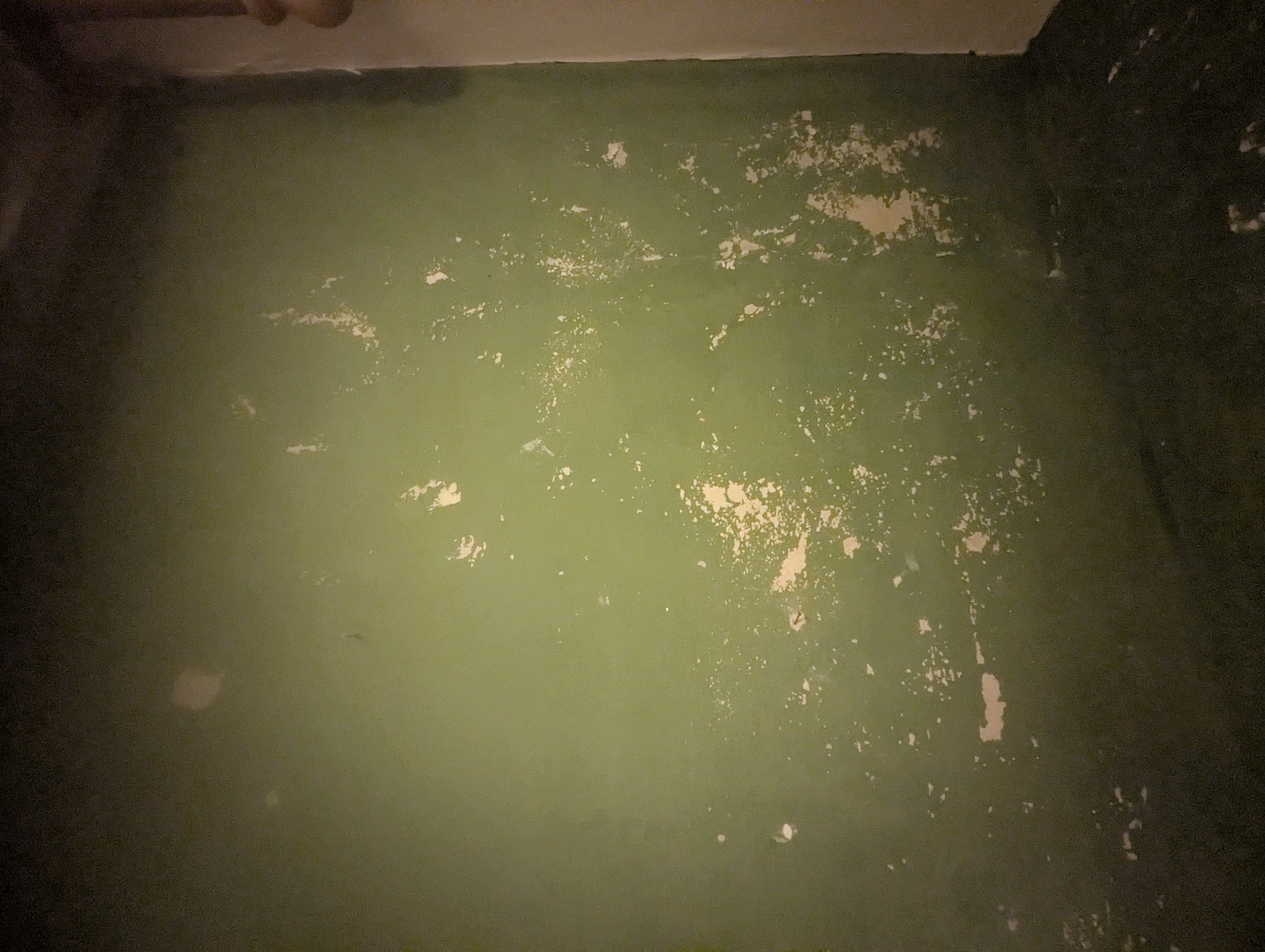

hi folks
A few years back I painted some walls using F&B emulsion. I didn't use their primer (although I did do a mist coat) which might have been the issue, but the finish was terrible and parts have flaked off like in pic.
I now want to repaint and do a better job. I'm liking Little Green, so thinking their Intelligent Matt range might be a good option as it doesn't need a primer.
Thinking of lightly sanding the existing paint and then cleaning with sugar soap.
Does that sound sensible?
Thanks!

With durable emulsions or certain paints you need a primer or the resins in the emulsion can play up. The quality paints are not the same as a standard matt.
I never had a problem with F&B although sometimes I used the cheaper acrylic primer undercoat tinted to match the F&B top coat.
Always read the application data sheet for whatever paint you use and don't skip anything. There are no shortcuts in decorating although you can use cheaper alternatives if you know what you are doing.
I would hit that wall with a cheap orbital sander with 120g disc bodged on a vacuum. Then a tinted acrylic primer. Fill anything if required. Sand. Spot prime filler.
Then the top coats of whatever paint you like.
Products like diamond matt or valspar premium like going over the sealer gardz so you could try that.
I think that wall really needs something on first so you have many options.

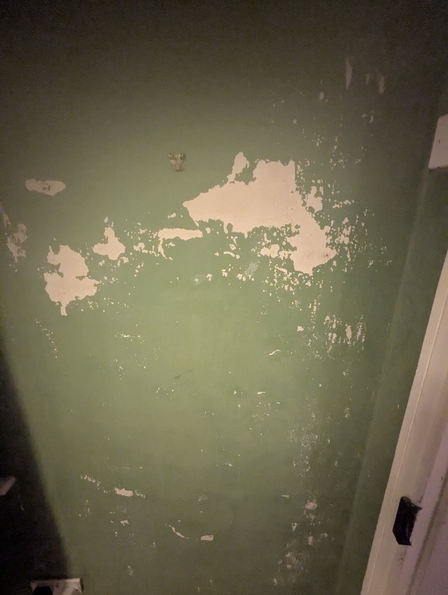

thanks for the reply - makes sense
went over with a 120g orbital. Some of the existing paint peeled off, some flaked off
What's it like now. Are you going to seal surface next?

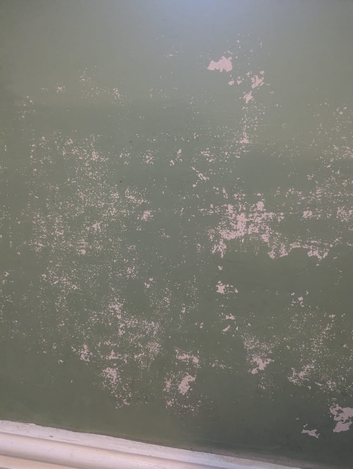

Worse wall looks like this. Bare patches are lime plaster.
I've got some new plaster breathable mattress emulsion, so thinking of going over bare plaster with that to effectively level it, then sand back a bit

Lime plaster don't like anything sealing in but it's said Gardz is ok.
With the original F&B paint is it ok to add water and if so how much. Adding water to it could of effected the binding of emulsion.

Little Greene Intelligent paint is not suitable for lime plaster I think?
They do make paints for lime plaster though
With respect, how do you know it is lime plaster?
I am a decorator, not a plasterer, my lay understanding is that lime plaster will "fizz" if dropped in vinegar. To date, I have never seen a red/pink lime plaster. That said, it might look pink to me because of the lighting/resolution of the photo.
How long did it take for the paint to flake?
What water ratio of water did you add to the mist coat?
The majority of my work is in west London Victorian properties with solid 9" walls. Each of which would originally have had lime plaster. In the majority of those houses, the walls have been re-skimmed with gypsum plaster.
