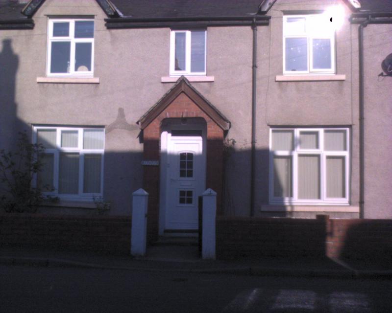

I have a pebble dashed unpainted front elevation that I want to paint. Is there any prep or is it a case of give it a couple of coats and job done ?
You shouldnt need any prep unless there are visible cracks that are too wide for the paint to fill . (use caulk or frame sealant )
2-3 coats of Weathershield , Stronghold or similar (pref trade as its thicker)with a DEEP exterior roller sleeve
