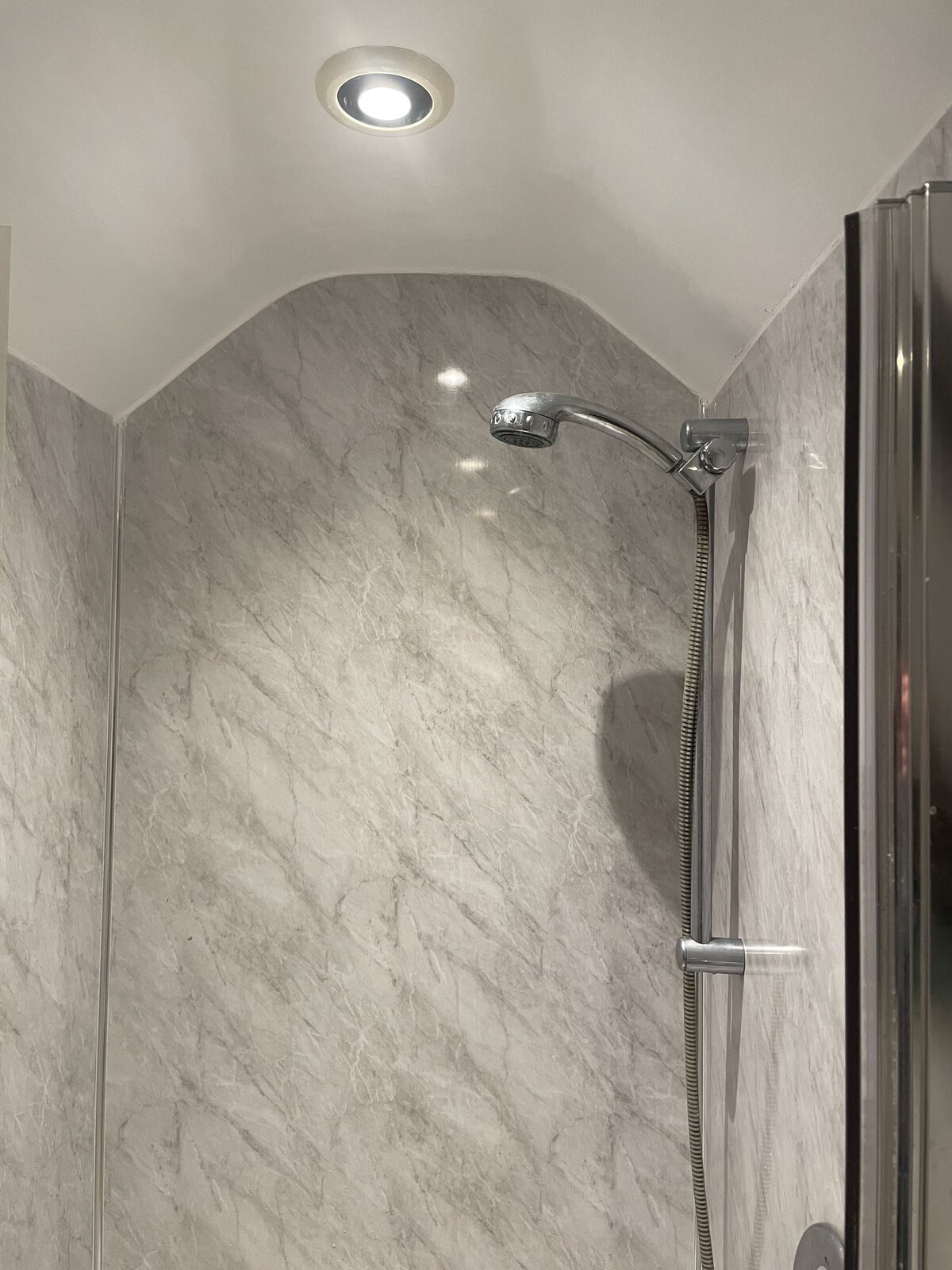

I replastered the ceiling above my shower cubical (see picture) and sealed with Zinsser Bulls Eye then gave several coats of Dulux Easy Care Bathroom paint, but after a few months the paint has started flaking off.
Is there a more robust waterproof paint that someone can recommend that won’t flake off?
As you can see in the picture there is an extractor there, but not sure what good it’s doing!
Many thanks!

No, you need to establish the cause, which is inadequate extraction. Leaving the fan on until the steam is cleared makes a difference. Place a tissue over the vent to test the strength of the extractor. If that doesn't work check in loft that the ducting is connected as it should be with no kinks or blockages and vents outside. Or does the extractor need upgrading?

A piece of tissue over the extractor stays put (and then falls off when you turn the extractor off). Perhaps I need to adjust the timer to keep it on longer once the light goes off

You look to have a low ceiling which will requires more efficient fan , had twin fan outlets with similar situation and heavy duty fan in loft .

Probably no paint on the market that will stand condensation so maybe fit a plastic ceiling if you can't get the condensation under control.
The ceiling is indeed very low and it’s right up in a loft space (hence the ceiling shape). Frustratingly the few inches of space above it isn’t accessible, except for punching a hole in the plaster. The fan ducting runs down the slope of the roof in the void between batons and plaster.
It sounds like a more efficient fan is going to be the way to go. I can at least access this. The ducting run is far from ideal though
It's not only the shower generated moisture but the entire house moisture condensating on the cold surface.
No fan is going to stop that unless it's going 24h a day and even then I doubt it.

Reduce moisture
Insulation to raise the dew point
Exstractor fan to take the steam out when showering.
Consider a dehumidifier

Waterbased eggshell will be impervious to the moisture, so much so that excessive moisture may drip off the ceiling.
Subjected to steam, the paint will become softer until the water cools down. I have used it dozens of times in customers' bathrooms, after they had problems with regular emulsion- I do stress the importance of improving airflow. Never had a problem after using the eggshell.
