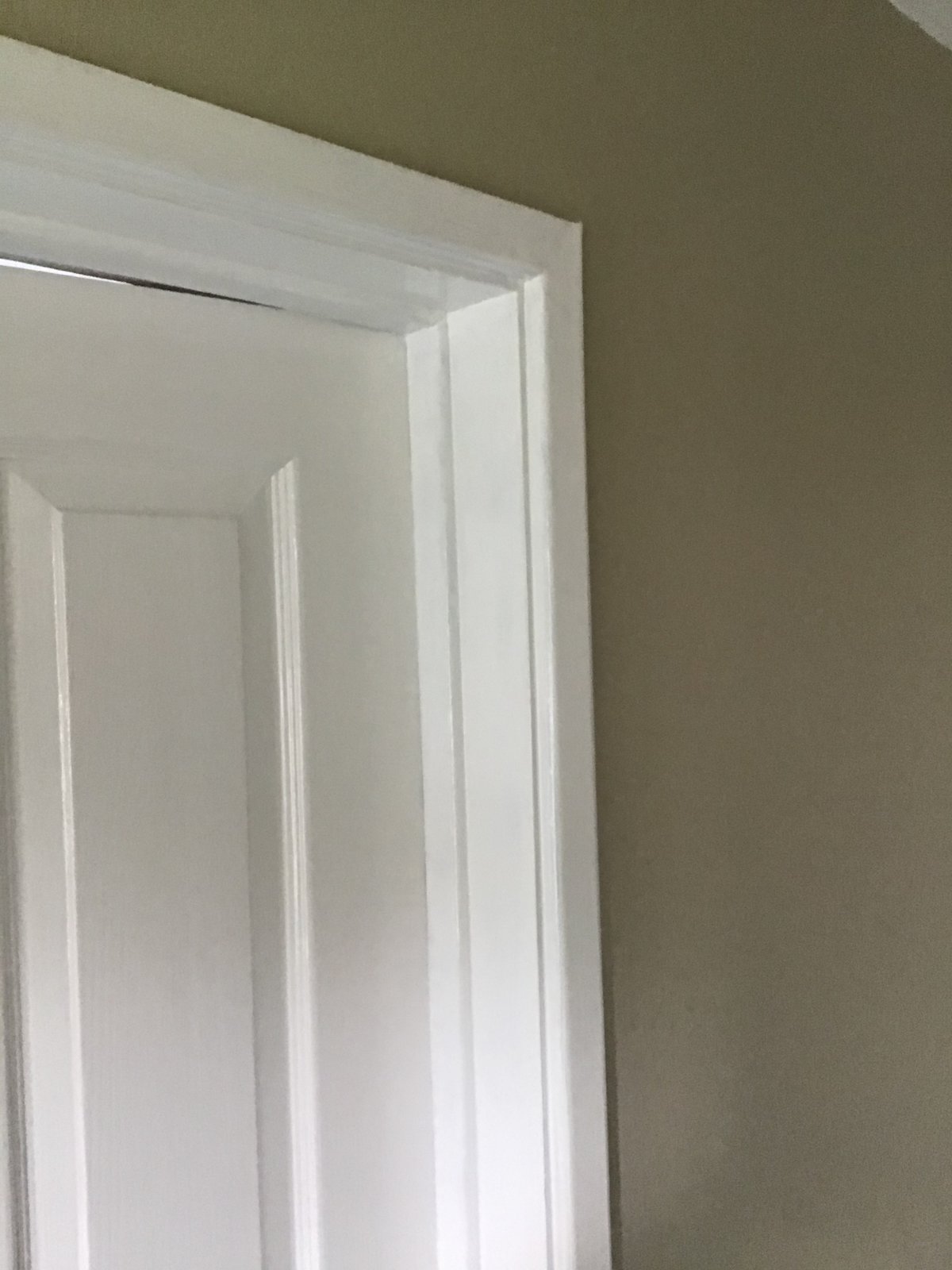

This is eggshell finish I have it in my hallway.
