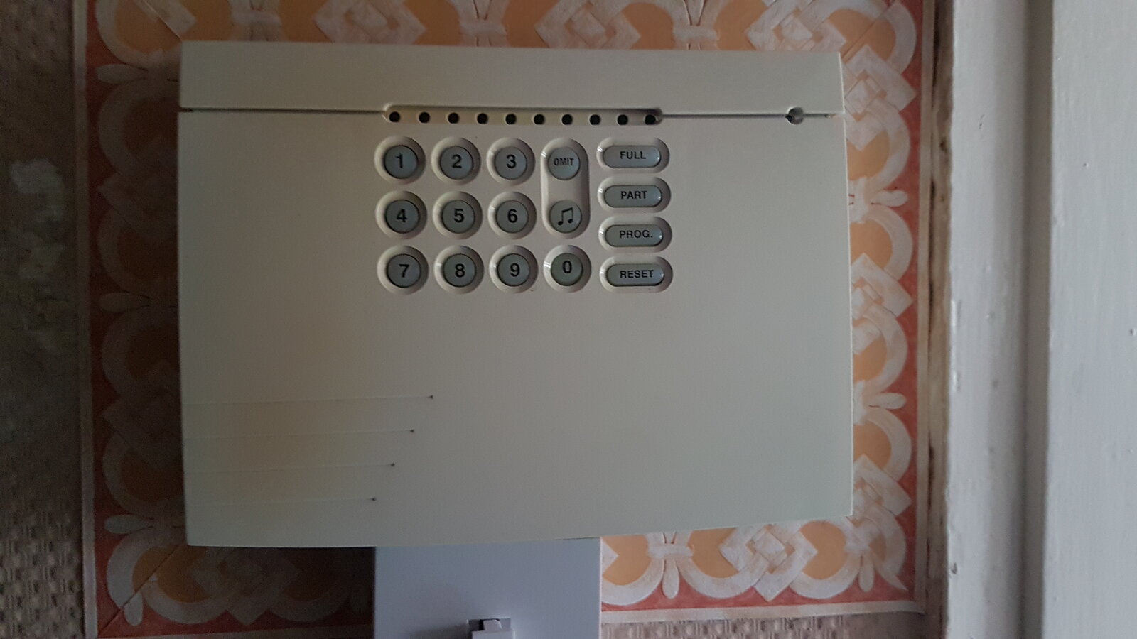

Called out to a boiler breakdown this morning.
Elderly customer says alarm not working due to boiler fault!.......
Anyway. ...
Constant beep and a power light. No response to user code. No book or label on main unit. Pulled the fuse to stop it beeping, Bell box didn't sound either.
I said I'd try and find her the instruction manual.
Any help appreciated.
Its a veritas 8c and probably just wants a new battery and reprogramming
