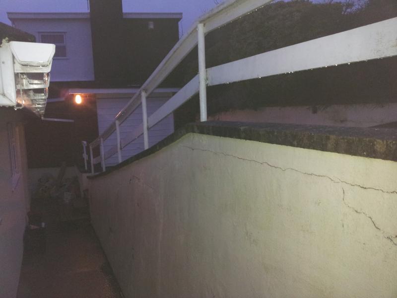

My house is on a steep slope with a practically unusable drive (the car bottoms out or a wheel leaves the ground) leading to a single garage.
I want to take the top 2 feet off the garage (level with the road), beam and block it and then level the drive to get my cars off the road. (the void would be for garden storage/bikes only).
I can't see this is covered by building regs or planning - what do you think?

I would be building it to suit the biggest vehicle that anyone could park on it not just a car.
Thanks guys. Good points - I'll submit the dimensions to the concrete firm - they've suggested a reinforced concrete screed but I will build an inner skin out out block.
Sorry, to reiterate, to just have a go and hope for the best is downright irresponsible, it needs a proper SE design.
Hi Freddymercurystwin - apologies if I looked as if I wasn't taking it seriously. The concrete beam manufactures, Stowell Concrete, offer a free structural service so I was going to make use of that initially (for the loading/support/reinforcing specs) although I have informally contacted a local civil engineer who will come out.
I definitely don't want it collapsing but I'd like to do things right - especially if I need permission.
Cars don't weigh that much in the scheme of things. The problem is that all the load ends up concentrated at the four corners. Beam and block doesn't generally like concentrated loads but I'm sure your supplier will have no trouble designing something to work.
However, you do need to consider the walls and foundations too. You will be adding a lot of load to the roof in the form of concrete, and the vehicle load given in BS6399 is more than three times that of an imposed roof load.
Your total load is going to go up from something like 1.85kN/m2 to about 9.00kN/m2.
It might get a lot more expensive than just sticking a new roof on...

Anyway, the work would seem to need planning and building regs approval
