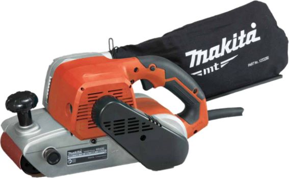

If you need a 4 x 24in sander, then the Maktec M9400/Makita MT 9400 is certainly a bargain basement way to go:
They are basically a slightly modifed, Chinese made version of the older Makita 9403 belt sander, but with what looks like the fan housing from the even older #9401, a 940 watt motor (instead of 1200 watts of the #9403) and is only single speed:
