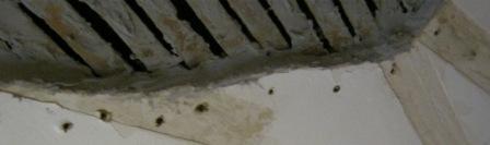

Part of ceiling collapsed

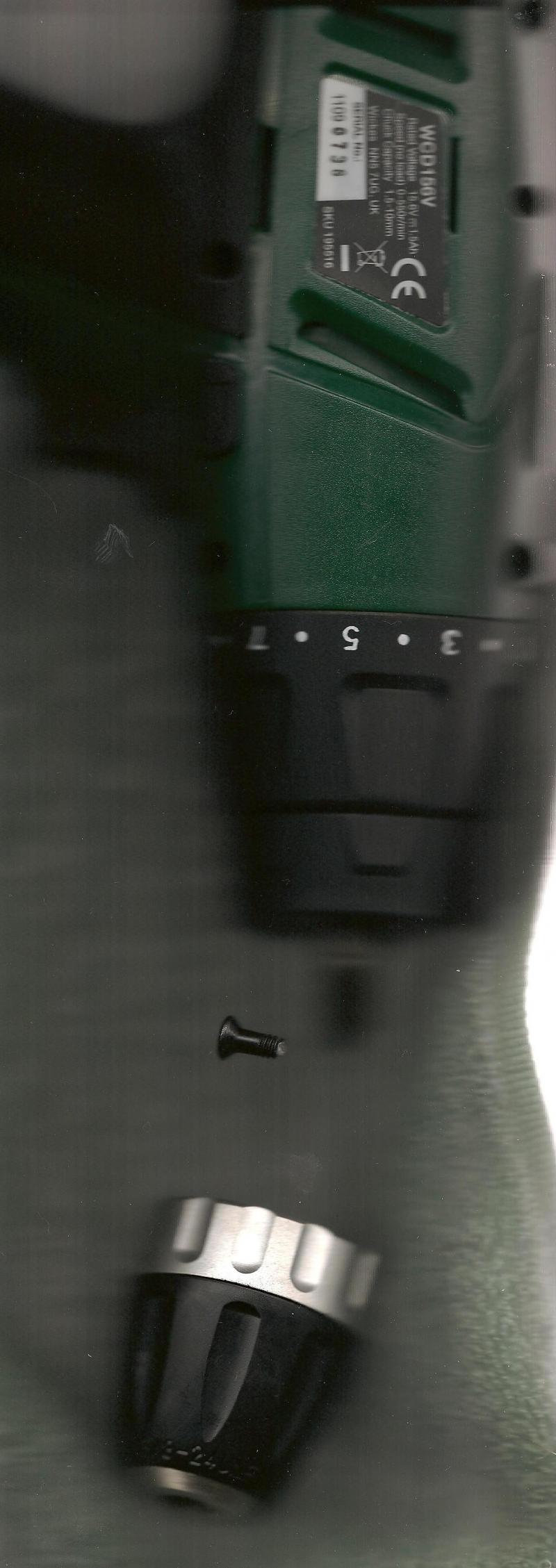

As our puppy has a penchant for chewing through electric cables, I needed cordless drill to replace my 30 year old B&D cabled hammer drill.
I had a bad start with this drill as the battery charger was faulty. Wickes exchanged it without any problems for another one.
This one charged OK but was unable penetrate brickwork of our Victorian house, which my 30 year old corded electric drill has no trouble with.
I used it to drill holes for 3" screws through some soft wood (used for palettes). The screw going into the chuck sheared off.
It was at this point I realised this was not the drill for me and returned it. Wickes were very good about the refund.

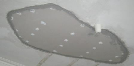

My first job was to secure the existing ceiling. This I did by screwing dry wall screws into the laths and joists. As the ceiling was uneven I found I needed a variety of different length screws. I painted over the screws with an oil based paint to prevent rusting. I then sealed in the existing plaster using Wickes deep filler (upto 50mm).

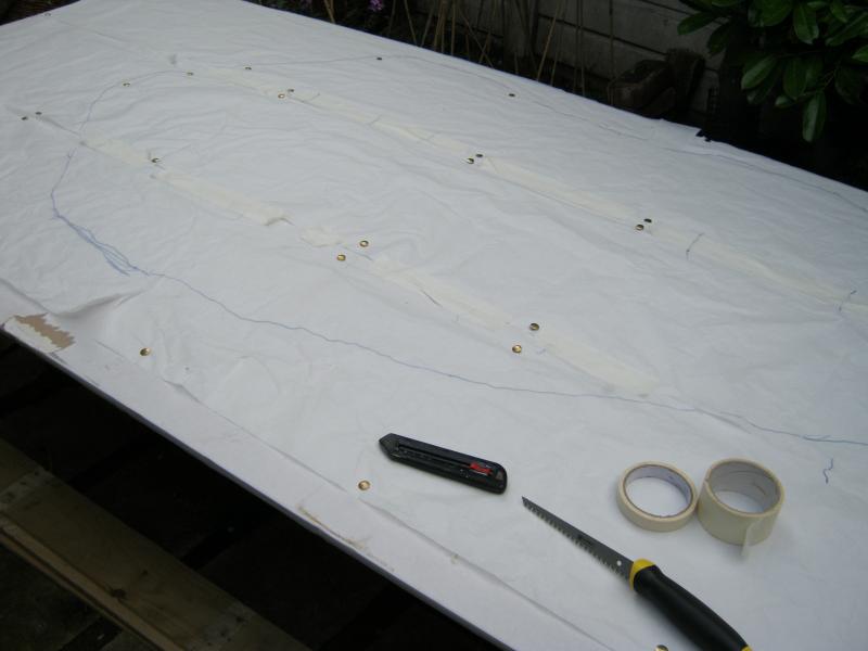

I traced round the hole using grease proof paper. I then transferred the paper to the plasterboard. Using the drywall saw I purchased via Ebay, I was able to cut out the exact shape I needed.

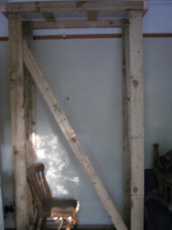

As I was doing this by myself I built a frame to hold the plasterboard in position.

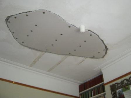

I was then able to screw the plasterboard in position with a small gap running round the perimeter.
This gap I filled with Wickes deep filler.
This leaves 3mm which I can skim plaster over, bringing it up to the same level as the existing ceiling (not yet done).
