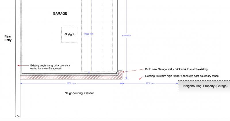

Hi all
Well I am having some trouble here regarding the Party Wall Act - and whether or not the works I am proposing will require notices to be served under the act or not. I have spoken to a number of surveyors now recommended by RICS - some suggest the works would require notification - others suggest not. I have also contacted the Faculty of Party Wall Surveyors who suggested I contact a surveyor taking be back to square one! Does anyone know who the definitive authority on this would be?
I have enclosed a plan below detailing the works which are under question - the plan hopefully speaks for itself. The nearest point to any neighbouring building from the proposed is 3250mm (proposed garage wall to existing neighbouring garage wall) so as I understand it this falls outside of the PWA due to the distance being over 3 metres.
The boundary between my neighbours land & my land is formed by a wooden fence supported by concrete posts. Being a wooden fence it is not covered by the PWA and no notice is required.
The conflicting advice centres around the rear boundary wall. This single-story freestanding brick wall continues from my land across to my neighbours land and forms the boundary between our land & the rear entry.
In the Communities & Local Government publication THE PARTY WALL etc. ACT 1996: EXPLANATORY BOOKLET if this wall would be considered a party wall I suspect this would be defined as a party wall (party fence wall) type a:
Party wall type (a)
A wall is a "party wall" if it stands astride the boundary of land belonging to two (or more) different owners.
Such a wall:
is part of one building (see diagram 1), or
separates two (or more) buildings (see diagram 2), or consists of a “party fence wall” (see diagram 3).
A wall is a "party fence wall" if it is not part of a building, and stands astride the boundary line between lands of different owners and is used to separate those lands (for example a garden wall). This does not include such things as wooden fences.
I have underlined above the contentious point. As I see it this wall does not separate the land between myself & my neighbour - instead it forms the boundary between my property & the rear entry - and the boundary between my neighbours property & the rear entry.
Some surveyors are suggesting just that - others are suggesting it would all within the act but have failed to explain why. Sigh....
