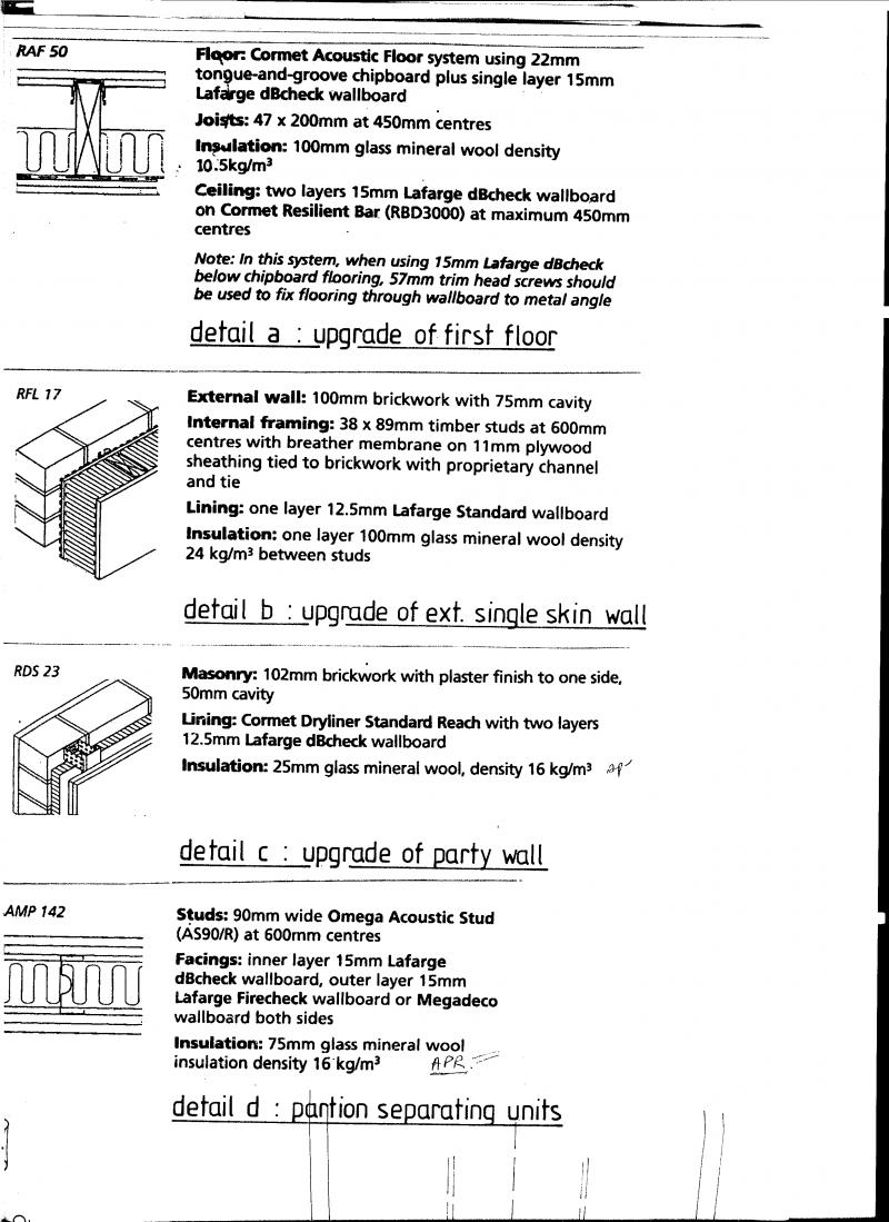

heres one were working on at the moment to give you some idea
[/img]
I have not quite sussed uploading immages but if you right click and open in another window you can read it better.
