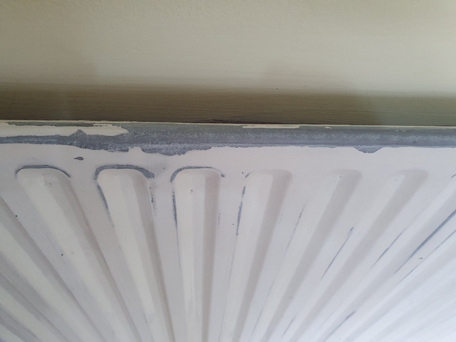

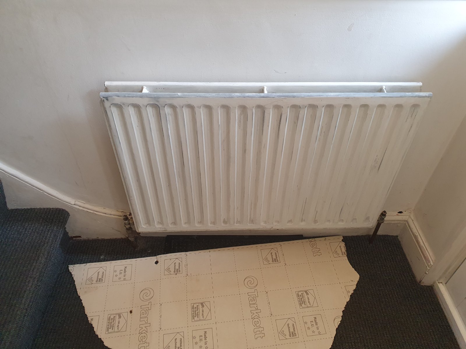

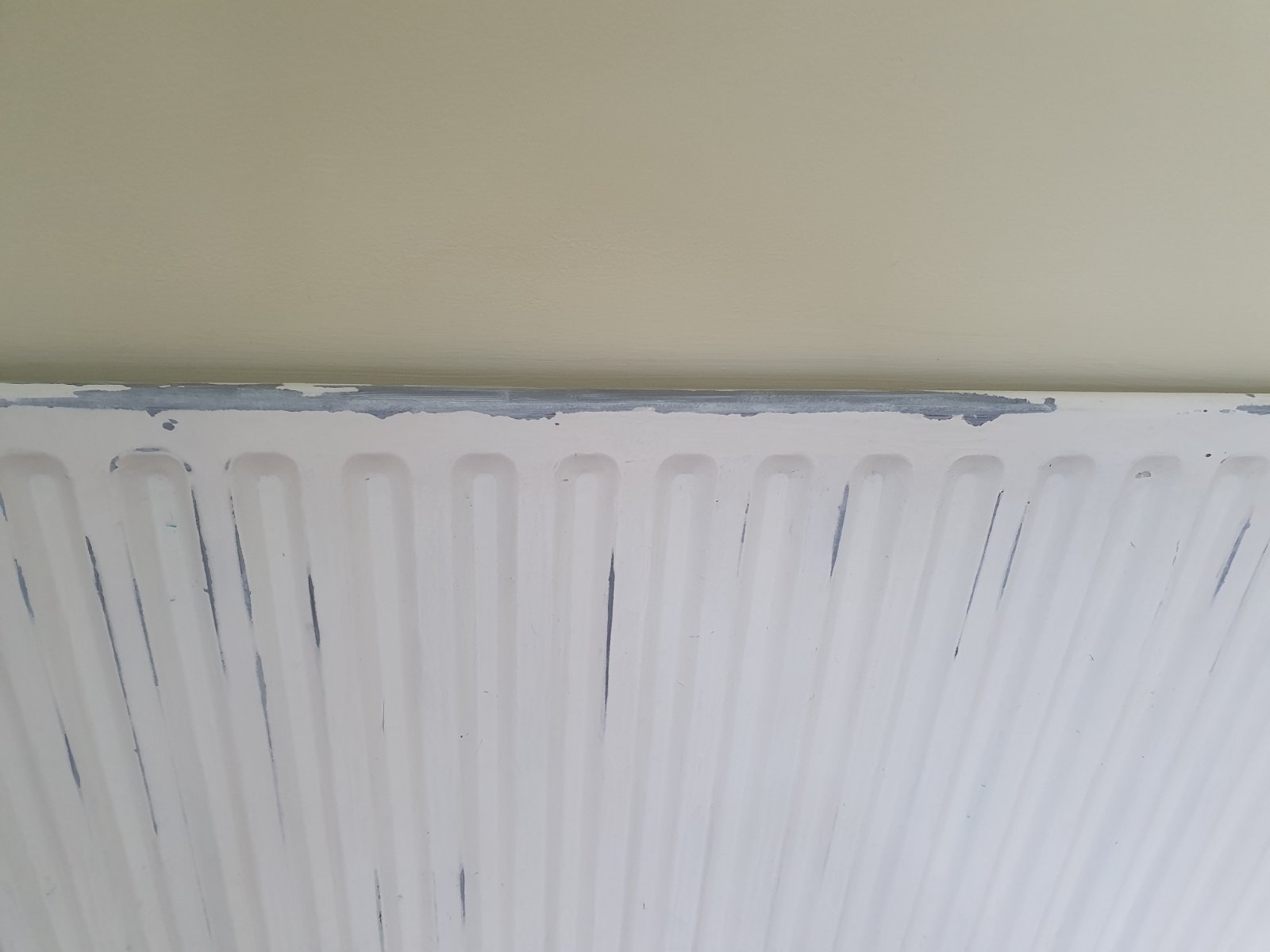

Hi,
I've sanded down my radiators were paint was peeling off and then used zinnser sealer. But the radiators are still patchy. Any suggestions on what paint to use next? Should I undercoat it first? I was planning to use multi surface paint but I'm not sure...

Which zinsser sealer?
I would sand.
3 coats of multi surface paint with a mini roller for quick application then level off with a brush.
Stir paint well
I used this:
Zinsser Bulls Eye 1-2-3 White Matt Stain Block Interior & Exterior Multi Surface Primer​
Do I need a different zinsser paint or should I get undercoat?
Stir paint.
Paint needs to be room temperature.
One or two coats of the bullseye 123.
Should look nice a white and not patchy.
Look's like your applying way too thinly. Use a 4 inch mini roller and get the bullseye 123 on
Thanks, I will shake the can first, then reapply it.
Yeah. Wooden spoon is good. Shaking is useless and you risk the lid popping off.
Wooden spoon in a drill on a slow speed is also good.
I used to buy then in packs of 6 spoons for £1. Those days are gone.ahhh
They are the best. A few branded paint mixers on the market but for hand mixing or in a drill a wooden spoon wins for me. IKEA it is then and one for the Mrs for her birthday. Ha
