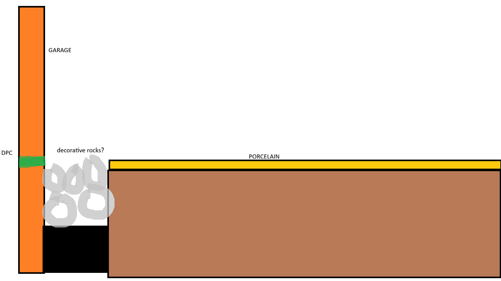

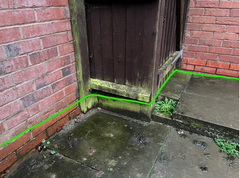

The back of the house and the garage are perpendicular to each other however the house's DPC level is 2 bricks above the garage's DPC level. (see picture).
I don't want to have a weird step like it has now, I want a flat patio (with the 1 in 60 drop of course), however it means the porcelain will be around the DPC level for the Garage.
My current idea is to install an ACO drain 2 bricks below DPC level and cover that drop with some rocks or other decorative stuff so that you don't really see the drop so as to still keep the 2 bricks below DPC level.
I have read posts about garage not being that district in the 2 bricks below DPC given that it is not habitable and not really insulated.
Is this the recommended approach? do you have better ideas?
