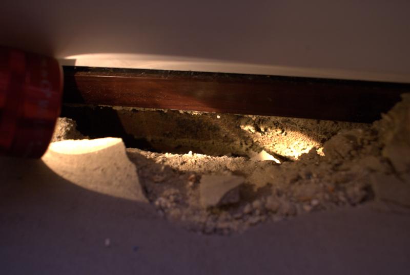

Just purchased a house for my family (yes there are still a few people buying!) and I've noticed a gap between the patio door and the house of around 1.5" in the centre of the door.
Missed by the surveyor!
However I thought-not a big deal I just need to fill it. However when I look down the gap I don't see a damp-proof membrane- I see bricks. Now I am a novice so I thought I would ask some experts about this... comments please, what should I be looking for and what would people suggest I do.
Additional information........The windows, doors, including patio were replaced about 5 years ago- have a FENSA certificate (which according to the forum sounds like a nice piece of paper but nothing else!). However don't believe the workmanship guarantee is transferable over to me with the purchase of the house. I am now more than a little concerned. House is 21 years old.

some upvc installers actually cut the dpc off as it can ruck up and interfere with the fitting process.
however, damp can not travel through the plastic.
some dpc is made of plastic.
i personally like to see it left in place regardless of upvc installation. you never know when somebody may want to fit a timber door or even brick it up.
Have a read of this, almost an identical situation; http://www.diynot.com/forums/viewtopic.php?t=160160
Difference you have is you’re unlikely to be able to replace the dpc on the outer brick course below the door frame but, as noseall says, damp can’t pass through the plastic frame. But I would take some effort to seal over the cavity & up the side of the frame/wall to avoid the risk of any damp ingress up through the floor, even if it meant cutting part of the existing screed back & relaying with a lump of membrane in there.

Okay, so there should be a membrane visible. I will be complaining about the survey........- I did pay for homebuyers survey, one below the full structural survey, at £790! There are the usual limitations- we don't move carpets etc. But as you can see from the pics it wasn't difficult to find the hole by feeling the edge area and I would have thought this would be a key area to focus on.

Not sure what you mean by “seal it up” but the outside patio level is not really relevant as long as it’s blow the dpc. The outer dpc will probably be at the level of bricks just below the door frame (you should be able to tell by looking outside). There will also be an equivalent dpc on the inner cavity wall & then a membrane (big sheet of plastic) would have been laid over the whole slab & up the insides of the walls, prior to the floor screed being laid, the plastic membrane would have then cut off level with the screed prior to plastering & fitting the skirting, effectively providing a continuous seal against damp rising from the ground up through the floor & walls.
If whoever fitted the (presumably) replacement doors removed the outer dpc, they have damaged the original damp course integrity; & clearly from the pics, they have also damaged the integrity of the floor membrane. If you just dump a load of cement in there without reinstating a damp proof barrier, there is a big risk damp will “wick” up from below the dpc, through cement ruining whatever floor covering you put over the top. Another alternative is to fill the exposed cavity with cement up to the level of the original dpc; you can push some polystyrene down into the base of the cavity so it’s about 2 inches below the bricks so you don’t need to use too much cement. Let that dry, paint a liquid dpc
http://www.dorseyconstructionmaterials.com/assets/info/LIQUID_DPM_ddpmliqsynstd5.pdf
over the concrete & up so it just covers the inside of the door frame below floor level & then finish the floor screed over that after it’s dry.
