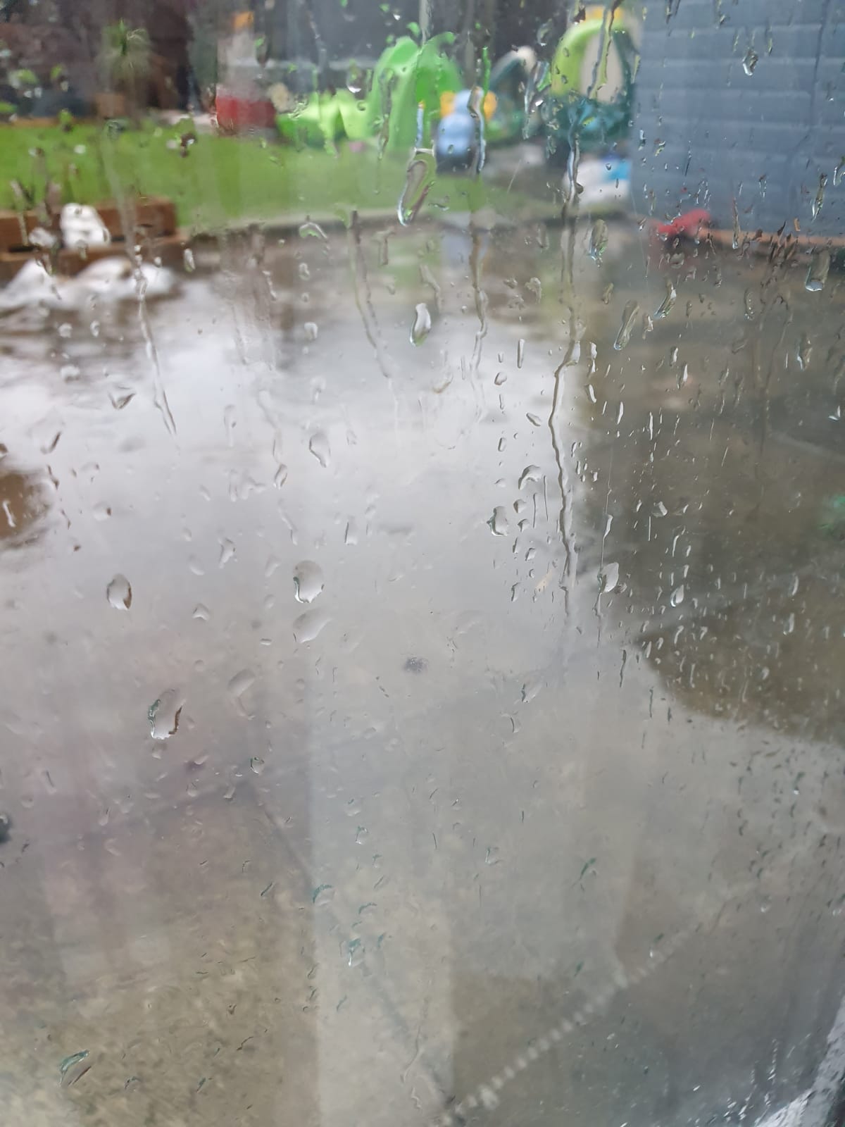

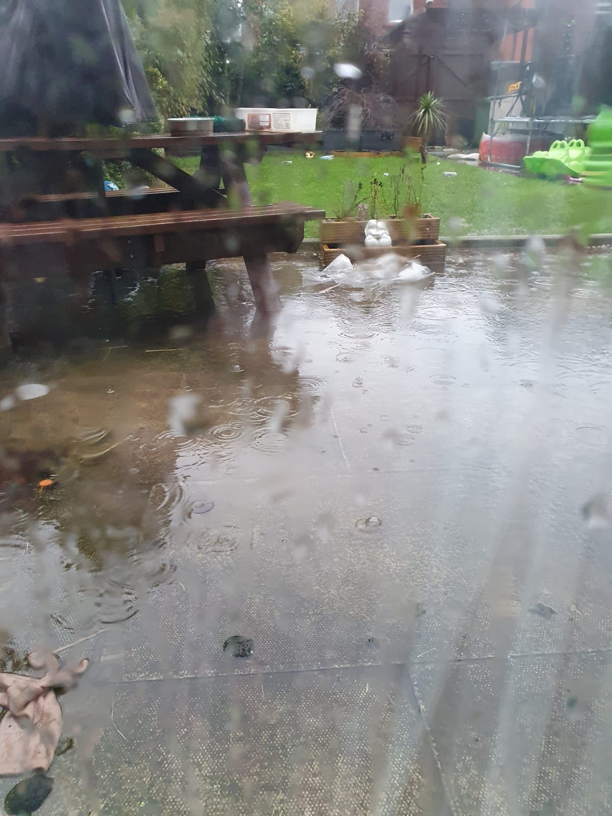

I'm guessing this will come up a lot with the recent weather. When we get heavy rainfall our patio starts to flood in one corner. The patio slops to that one corner
Anyway a couple of years ago I put pea gravel down the edge between the flags and lawn. Probably a foot wide all the way down. In the corner where it's worse I dug about 1 metre by half a meter by I'd say a good 2 or 3 foot deep and filled that with pea gravel. A do it myself soakaway
Now this has helped but not eliminated it. It doesnt help the soil is quite clay heavy. I'm at a loss with what to do. I can put an aco drain down the edge but what do I do with the corner seeing as that's where it would all drain. It's like that would make it worse. I cant drain to my drain on the house as the patio slopes away so it would run uphill

Ive been doing a fair bit of reading on this kind of thing. I have a related drainage dilemma myself. Not really the same as yours.
The clay soil saturates very quickly and in a prolonged spell of rain the surface run off builds up fast.
Maybe it’s possible to install the drainage but it could involve a fair amount of work laying a pipe under the patio so the aco drain could link to your surface drains??

With how the patio slops I cant possibly run it into the drain. You know after a while of being in a house and all the things you pick up on and avoidable problems you find and you think why do it like that. The slope of the patio takes water away from the drain. A corner on the far edge of the patio but the water has nowhere to go once the ground is so saturated
I dont know if this sounds good but my plan is to aco drain down the edge of the patio. Then in the corner where it builds up run a land drain/french drain from the aco drain down a trench on the edge of the garden to the far end of the garden. Then dig another soakaway pit and fill with gravel. That way it is drained to the other end of the garden. The land drain will lose water through holes in the pipe as well as in two soakaway pits at either end. It has to be better than what it is now and itll probably cost me about £150 in materials as well as a lot of hard work

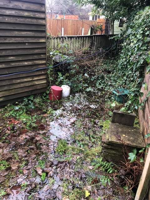

My daughter has just bought a house that has a flooded back garden because it’s in a low spot.
I was thinking to burry a full row of aquacells up the centre and simply have a gravel path on the top of them, then an overflow from them into the house surface water drain. I would hope the overflow would never be used but it would be there just in case.
