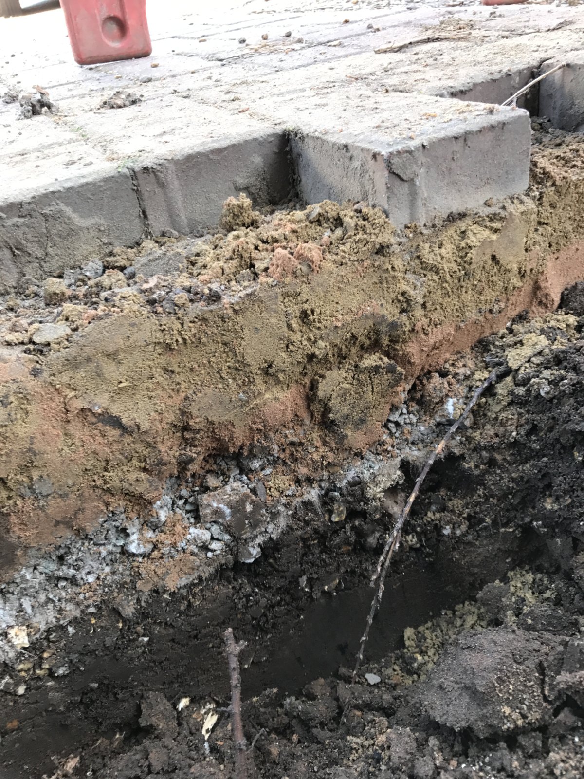

I've dug up hundreds of drives and patios and very rarely see more than 100mm of anything below the surface.
Maybe that's why half the block paved drives i see in the area look like the Himalayas:LOL:and ours hasn't moved a millimetre. I bought bags of hardcore and spent all day whacking it down.

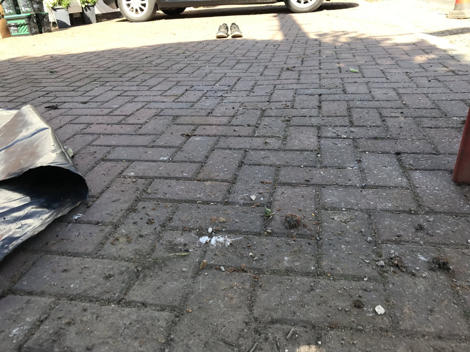

The one I'm doing today has soft sandy soil, membrane, an inch on MOT, 3inch of grit then the blocks. It's not too bad, looks a good few years old.
There's a comedy one near my house, looks like blocks straight onto clay, must take a pic :)
