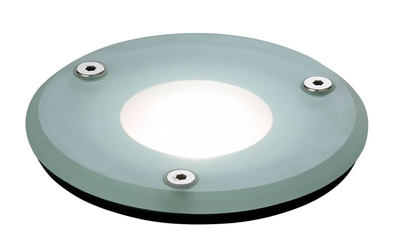

It was time to start the edging and decide on any lighting we wanted. We decided on decking uplighters on a 12v system, specifically we went for the B&Q Select a Light system.
5011274800406_001c_v001_zp
6 of the house edging bricks will have holes cut for the recessed deck lights, and the retaining wall/fence will have 2/3 wall mounted lights also. Drilling the holes was pretty tricky! Required a ~65mm stone hole cutter on each brick, needless to say the majority split in the middle, but when mortared in place its hardly noticeable...
